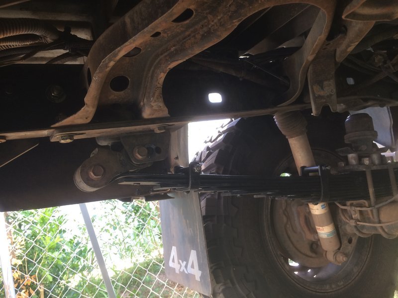

    changed out my dakars for expos...and now I have this problem.
    my hi-lift is still holding up the bumper...did I set the holes correctly?
    I tried moving the shackle mount as rearward as possible, but my pelfrey rear bumper mount is in the way...so i'll have to cut off about 1/2" from the rear vertical mount.
    simple leaf spring swap turned into more work than expected :(
