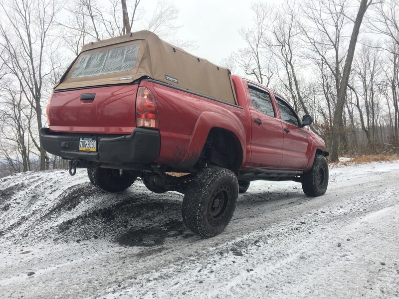

    #619
    Nimble9
    Nimble9 visit squareonecreations.com Vendor
    Oct 20, 2015
    #167184
    11,161
    Lebanon, PA
    2006 4x4 DCSB
    enough to have fun
    ATO shackle flip is awesome!
