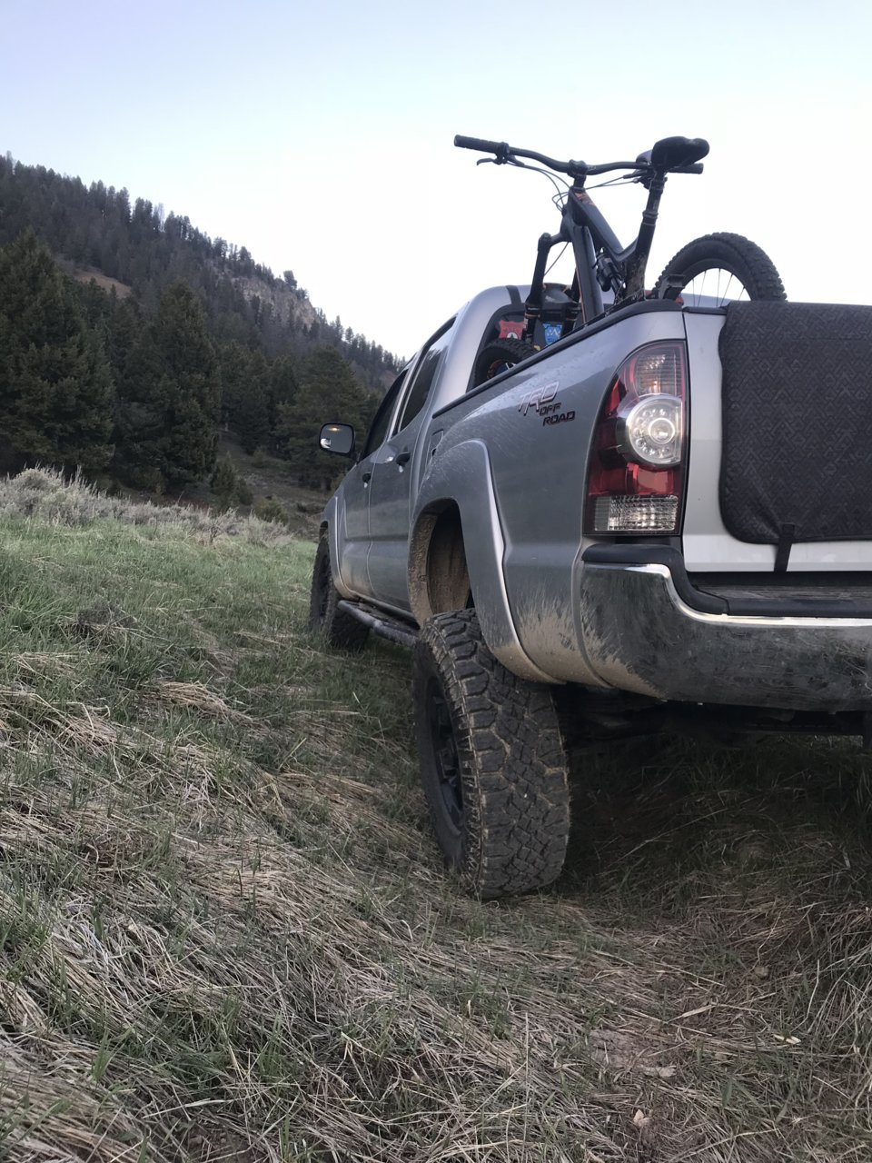

    Toytec Boss 3" lift URD Short Throw Magnaflow dumped 285/75/16 Duratracs SOS sliders Ext brake lines NWTI Bumpers VHF/UHF/CB Shackle flip
    Well, major pain in the ass, but it works!

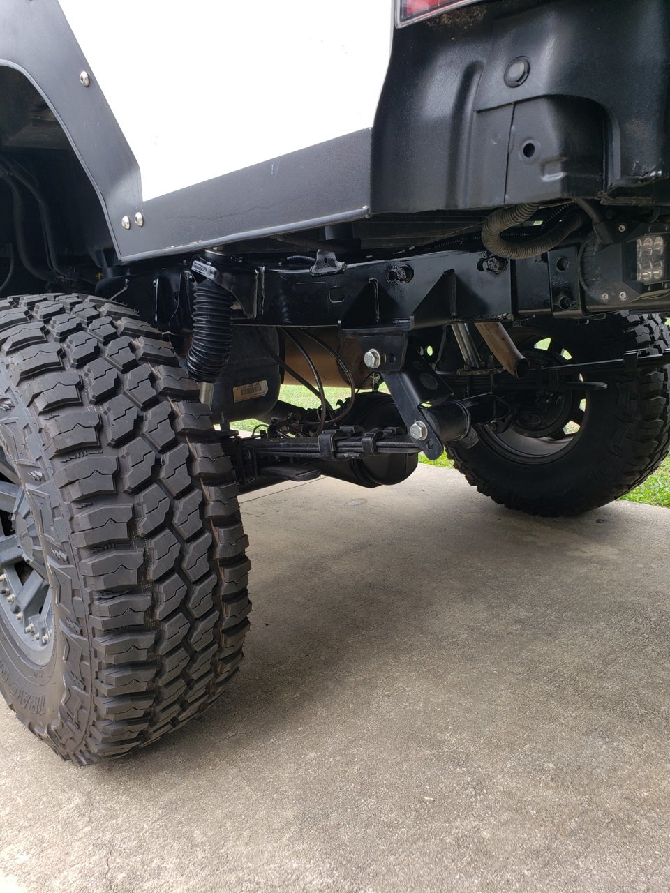

    Ok, so i installed this kit a while back and realized my dakars are flat. How should i set them to re arch the springs? Im on the middle hole on both spots.

    The shackle flip won't affect the arch in your springs. You could move the shackle back one hole to help the shackle angle. The arch in your spring is sagging because your spring is overloaded or worn out.

    Do you think it needs moved back from that pic? Here is one with a little bit of a droop

    I can't tell the shackle angle very well from the first picture. Is the second picture at full droop? That shackle angle is pulled too far forward imo.

    Partial droop. Here is a better pic of the shackle angle

    I would say that angle is fine. You want 40 - 45 degrees from vertical at ride height, which looks pretty close to what you've got there.

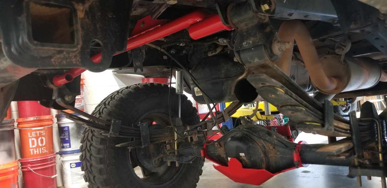

    20190629_160644.jpg installed with the xj lift shackles and bilstein b110 shocks, just need to figure out bump stops before I test any flex out

    Also this is with stock springs with an add a leaf

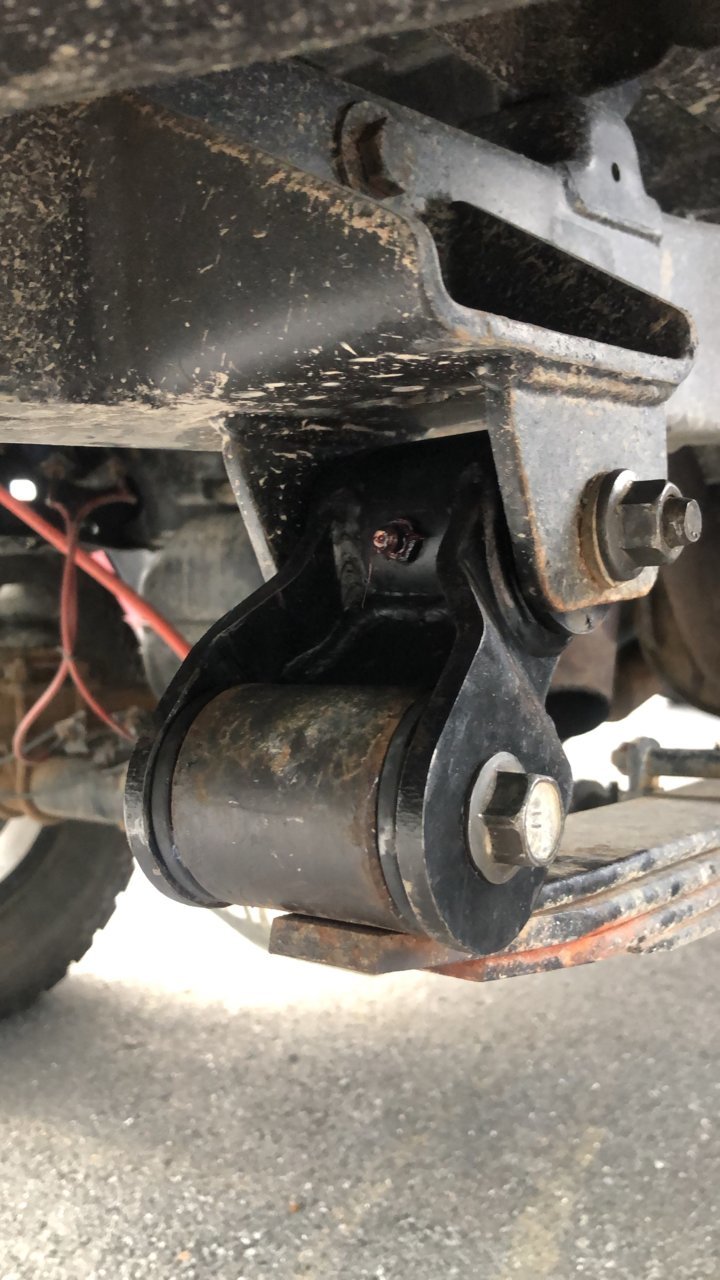

    20180210_143238.jpg Been loving your guys shackle flip, make for flex and fun

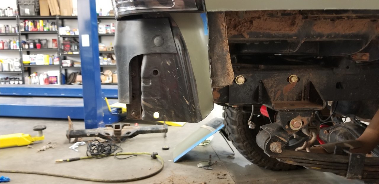

    Threw some HD shackles on there!
