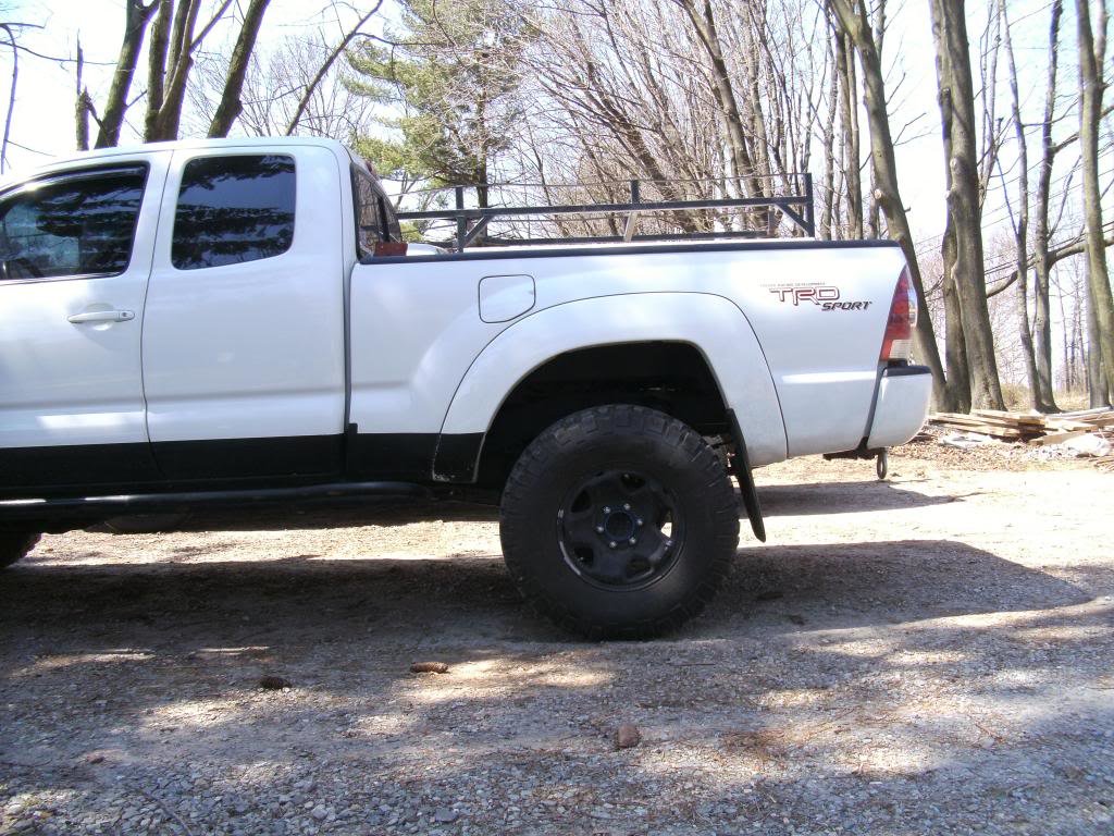

    Flip kit installed today :woot:, but no write up :/

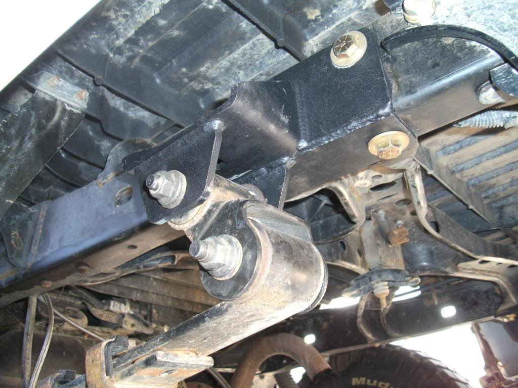

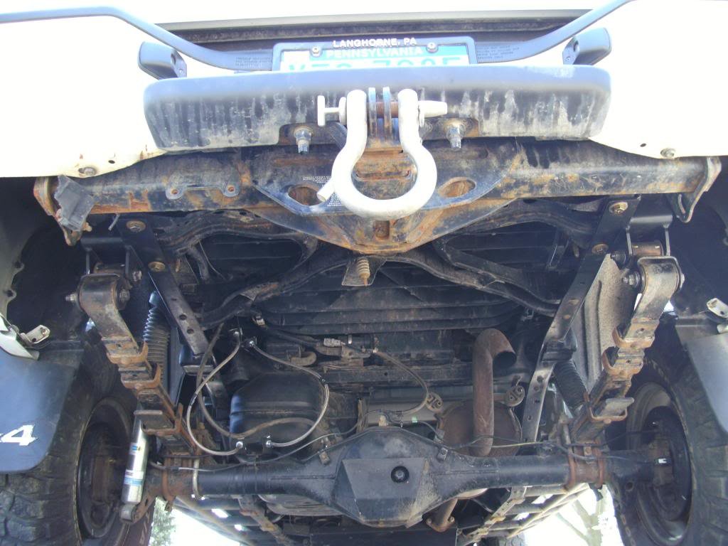

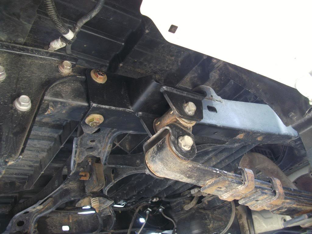

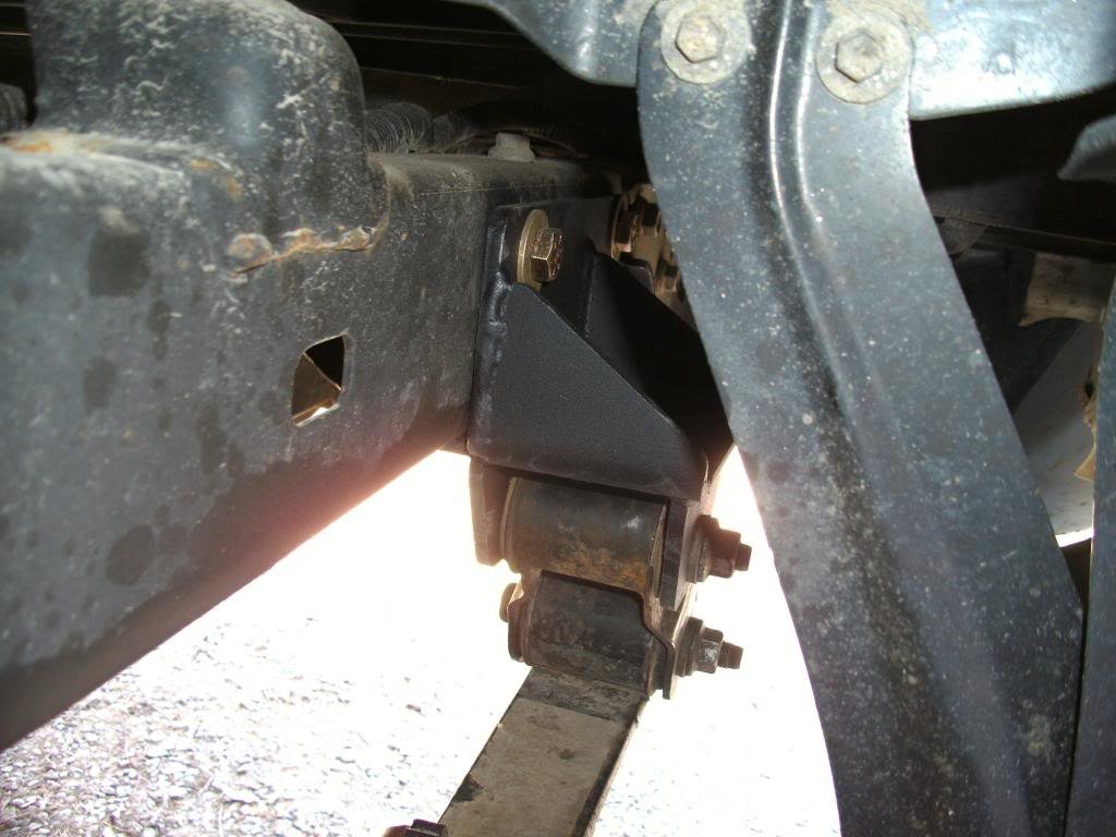

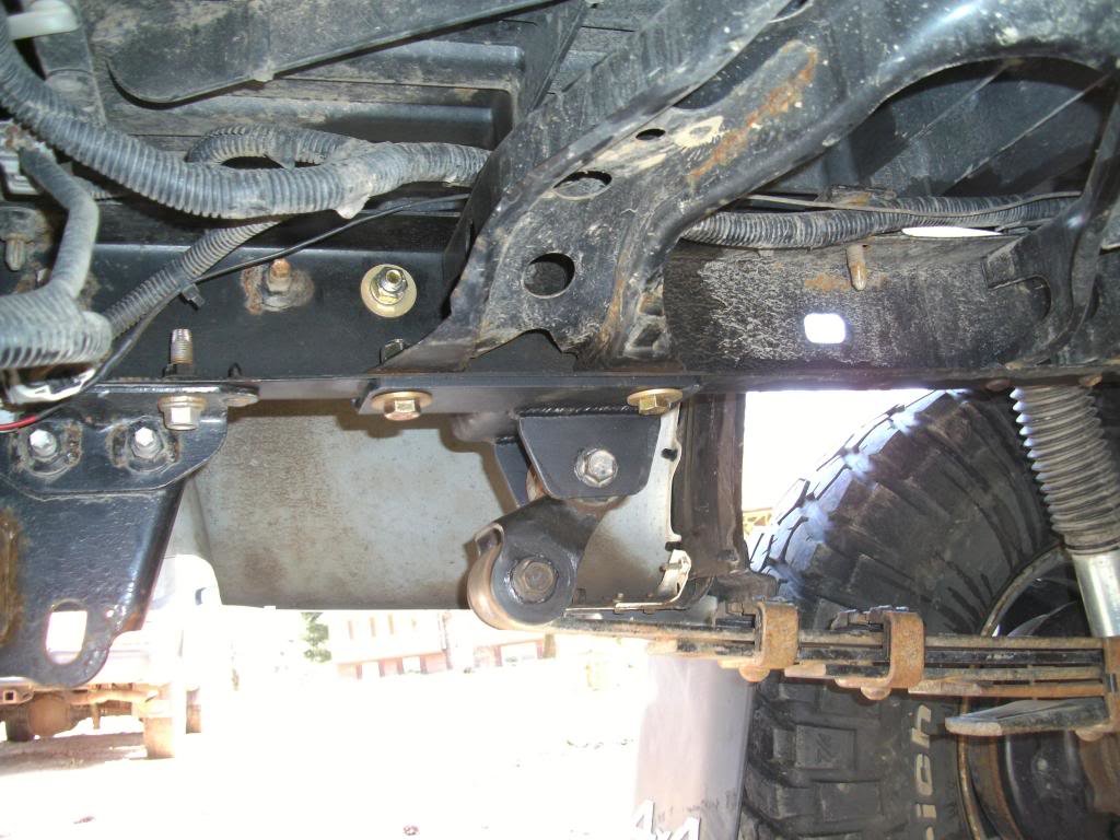

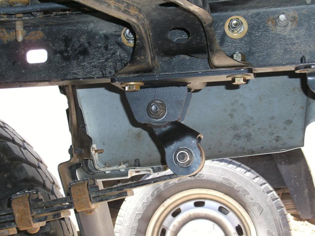

    Couple notes, some obvious, some not so much.
    Remove spare tire (if mounted) and both rear wheels, makes install much easier. Jack stands under frame, and floor jack under pumpkin, as you will need to raise or lower the axle at times. I purchased 8 additional 1/2" grade 8 washers; I wanted to have washers on both sides of the frame on each bolt. I also used anti-sieze. Will retorque after a few miles.
    First, I unbolted the shackles (19mm bolts) after the load was off of the springs. I used a cutoff wheel to cut the heads of the rivets, a center punch (hammered as close to center as possible) to knock them through a little (when they actually budged). I then pulled off the old POS shackle mounts. I then used a right angle high torque/ low speed drill in order to get into some tighter places to drill out the rivets. First I used a smaller bit (approx 1/4") to get centered, then finished out with a 1/2" bit, as the bolts supplied with the kit are 1/2" (3/4 heads). You will need to unbolt the shocks (17mm, one side at a time) in order to get the rear axle to drop further to get the new shackle mounts between the top of the spring end and the frame. Time to bolt up the flip kit brackets. The bolts all lined up pretty well, using a drift pin when needed(only on 2 holes, guess I got lucky:rolleyes:). Tighten these fully.
    Flip the shackles, apply grease and anti-sieze to the bushings and bolts. You will now need to jack up the rear axle to get the spring ends to line up w the mounts. Put the bolts through, washers and nuts on them, but do not fully tighten! You may now rebolt the rear shock (I just did the bottom, applied grease to bushing while I was at it, antisiezed the nuts back on do not fully tighten these either.
    Put everything back together (wheels, etc). The truck may now get off the jack stands and put its own weight on all 4 corners. NOW you may tighten shackle bolts and your bottom shock bolts; the load is now on them and bushings are much less likely to torque and gouge themselves out upon lowering the truck back on its own load.
    This is all that I did, there may be other ways to do it, but all worked well for me. I found that the air chisel did not work well. All in all, it took me a little over 4 hrs, with beer and lunch breaks. The rear springs seem stiffer for some reason, and I definitely gained some height in the rear. Now I just need to have the extended shocks to arrive:thumbsup:
