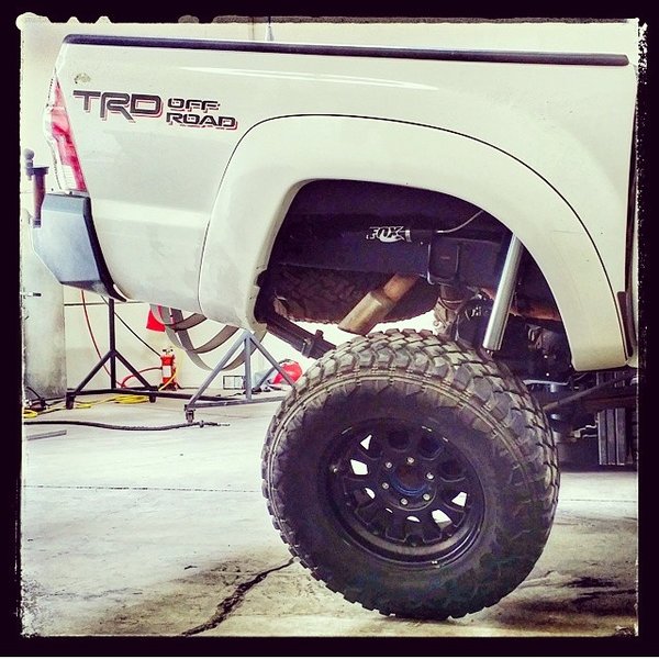

  14. Dec 29, 2015 at 7:38 AM
    #34
    bjmoose
    bjmoose Bullwinkle J. Moose
    Aug 31, 2010
    #42529
    6,009
    Steve
    San Jose CA
    '11 Std Cab 4x4 5sp
    OME suspension, ARB Air Lockers, CBI/Relentless/Pelfrey armor, HAM radio
    In this particular picture it sure looks like the shock is mounted in the stock location?
  15. Dec 29, 2015 at 7:40 AM
    #35
    NateMob
    NateMob Well-Known Member
    Feb 20, 2013
    #98054
    1,618
    Nathan
    South Ogden
    1997 Land Cruiser
    Triple Locked
    Its extended for sure...welded in the stock passenger location.

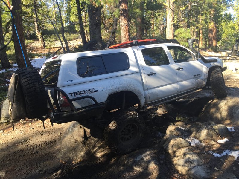

  18. Dec 29, 2015 at 7:52 AM
    #38
    bjmoose
    Aug 31, 2010
    #42529
    6,009
    Steve
    San Jose CA
    '11 Std Cab 4x4 5sp
    I pulled this pic from Mademan's build thread:
    Until now all the BAMF relocations I'd seen were straight up/down vertical.
    supralee and NateMob like this.

  20. Dec 29, 2015 at 7:59 AM
    #40
    Mademan925
    Mademan925 Senor Taco
    Nov 7, 2012
    #90668
    7,636
    Nick
    Discovery Bay, CA
    2014 4x4 TRD OFFROAD DCSB
    enough to go over stuff
    Jerry installed mine so they are where he wanted them.
