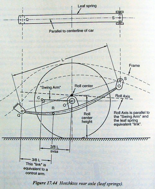

    By inverting the shackle, I would imagine that Toyota is after a particular roll center and handling characteristic. Here you can see how it works with leaf springs and a regular hanger... if the shackle is inverted, that line is going to change.
  7. Feb 4, 2021 at 7:57 AM
    #27
    Adventure4x4
    Adventure4x4 Well-Known Member
    Feb 12, 2016
    #177931
    1,377
    Adam
    San Antonio, TX
    2013 TRD off road MT

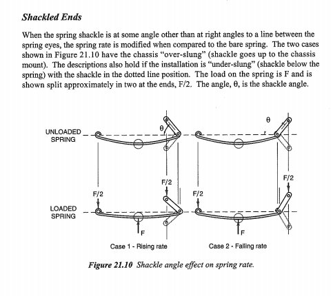

    Brian is right. There are many factors involved, but based on current frame design and desired function of "being a truck" in terms of load carrying capacity, effective spring rate, and stability, Toyota felt this would be the most practical solution. DFM is a significant factor.
    Here's some more info if interested...
