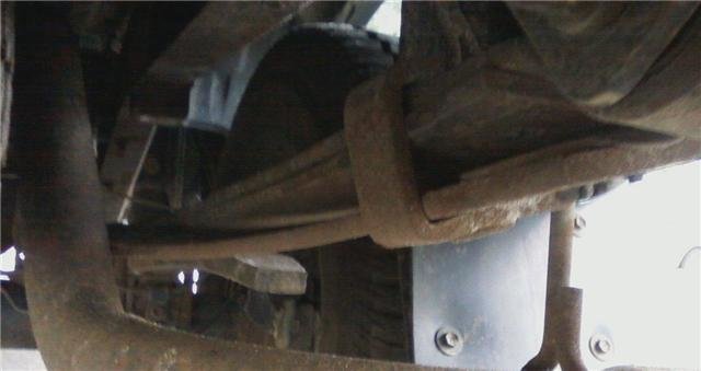

    the one that holds them all together snapped i noticed it after going riding i had my quad in the back and went down like 20 miles of dirt road but it wasnt anything bad so idk how it broke :/

    You mean you broke the center pin, or the actual leaf?

    the leaf it literally snapped in half ill take a pic tomorrow and post it it was a major shock to me!

    Definitely want to see that. That is the first time I have ever ever ever heard of a leaf spring snapping!

    It's common for a leaf to break in half in a pack. It just happens sometimes. Probably more so on trucks back East, or ones that haul heavy stuff now and then. See pic below, it's the same leaf you mentioned, on the same style truck. I think I stole the pic from customtacos when a dude posted it.
    The first gen 4x4/PR's should all have stock shackles that measure 3.5" stock. Center to center on the bolts. It's also normal for them to not use a metal sleeve in the frame bushings, just a fat 18mm shackle stud, but I have ran into one particular 95.5-04 truck that for some reason had a metal sleeve in the top bushings. Not really sure why, I told him to just remove it so my 18mm bolts would fit through.
