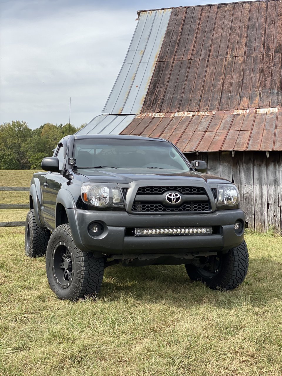

    So I dropped my truck off about 2.5 weeks ago to have the 4.88s installed. Throughout this time, I called the mechanic multiple times and left several messages with no reply. Today he FINALLY calls me back and tells me the front diff needed a tool to check the backlash, and he had to wait for it to come in. He did admit he ran in to some issues and it took almost 4 days to correct those issues. However, he believes my front passenger side wheel bearing is going out because it now has a “roar” while driving down the road. I’ve never had an issue with this before, but I understand they need replaced after so many miles. My question is, if the gears were not installed properly, would this cause a roaring noise? I’ve read where there might be a noise during the break-in process, but I’ve also read where any noise is not good.
    I chose this shop due to both my limited selection, and the many recommendations I received when asking around. They specialize in performance transmissions, so I assumed a gear swap should be a walk in the park for them.
    I’m picking the truck up tomorrow, after he finishes “tinkering with it”. Any help or advice is very much appreciated. 4A5E7C92-3EDD-4D2C-AB7D-F246E6AC6DEB.jpg
