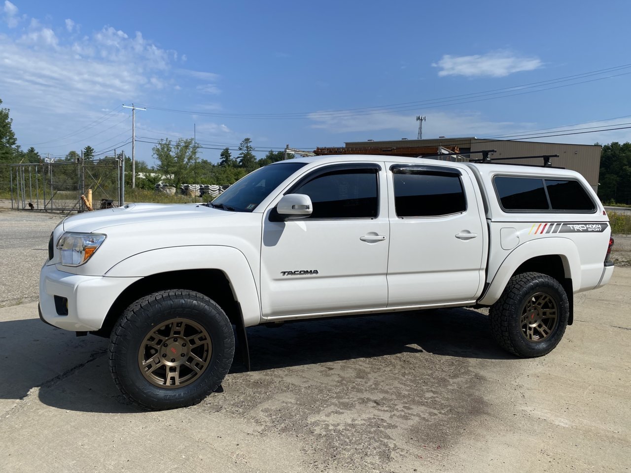

    Ok so the issue is once and for all solved.
    it was my pro comp 7005 wheels.
    I bought a set of FN F(x) pro wheels and some toyo open country tires.
    the wheels were the only constant the ENTIRE time I had the vibration.
    so I’m here to finally close the loop. And the truck looks rad as hell now with bronze wheels
