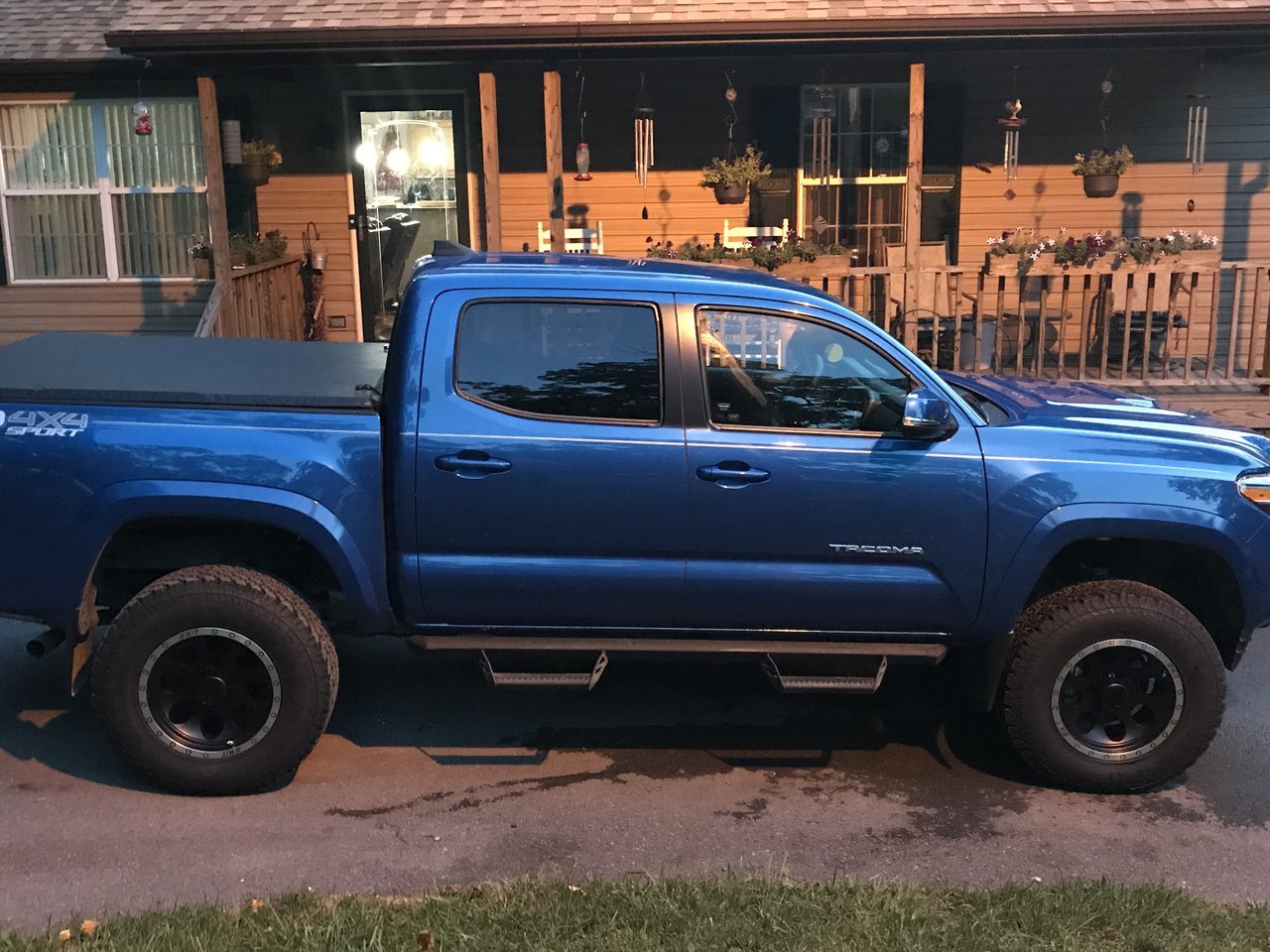

    From what I have been reading online, it appears I need UCAs. Can anyone recommend one. I'm looking at the one from Tuff Country.
    Also here is a picture of my truck with lift and new tires.

    I've had the exact same problem. It was a tire out of balance. I don't think you shouldn't need UCAs.

    Unfortunately if you lift a Taco over 2 inches, it can add up pretty quick, as you're finding out you're going to need new UCA'S in order to get a decent alignment. That's most likely the cause of your problem as lifts under 2 inches usually have no problems with alignment on stock UCAs.
    Another issue you might have is a worn needle bearing. This is usually diagnosed as a vibration in the truck in 2wd but goes away in 4HI. After you get the alignment sorted and if you still have vibes, check to see if you have the symptoms of a worn needle bearing. If you do the best correction would be to have it replaced with an ECGS bushing.

    If you were all over the road UCAs should help cure the wander with more caster. I'm running SPC UCAs they're fully adjustable

    To OP...the shake is from non perfect balancing. I'd bet lots of coin on it. Get them road force balanced some where and it should help. Or you may find one or multiple of them are out of spec and impossible to fully balance.

    Rebalancing tires is a lot cheaper than UCAs, go ahead and try that first. Then see if they can get you a better alignment and this time try and have them get you the values so you can post here for review. If still causing a problem, do the needle bearing check. If vibrating in both 2 and 4WD then get the UCAs. If only vibrating in 2wd get the ECGS bushing installed.

    Your front end geometry (not only alignment) is all messed up now. You may want to take it to a very reputable shop to correct it.
