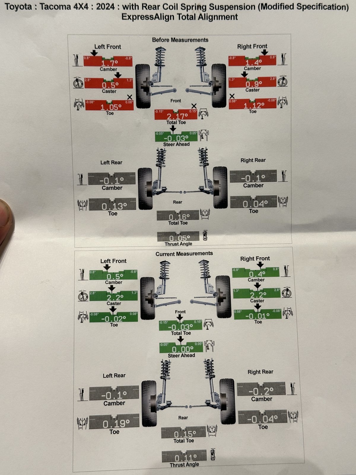

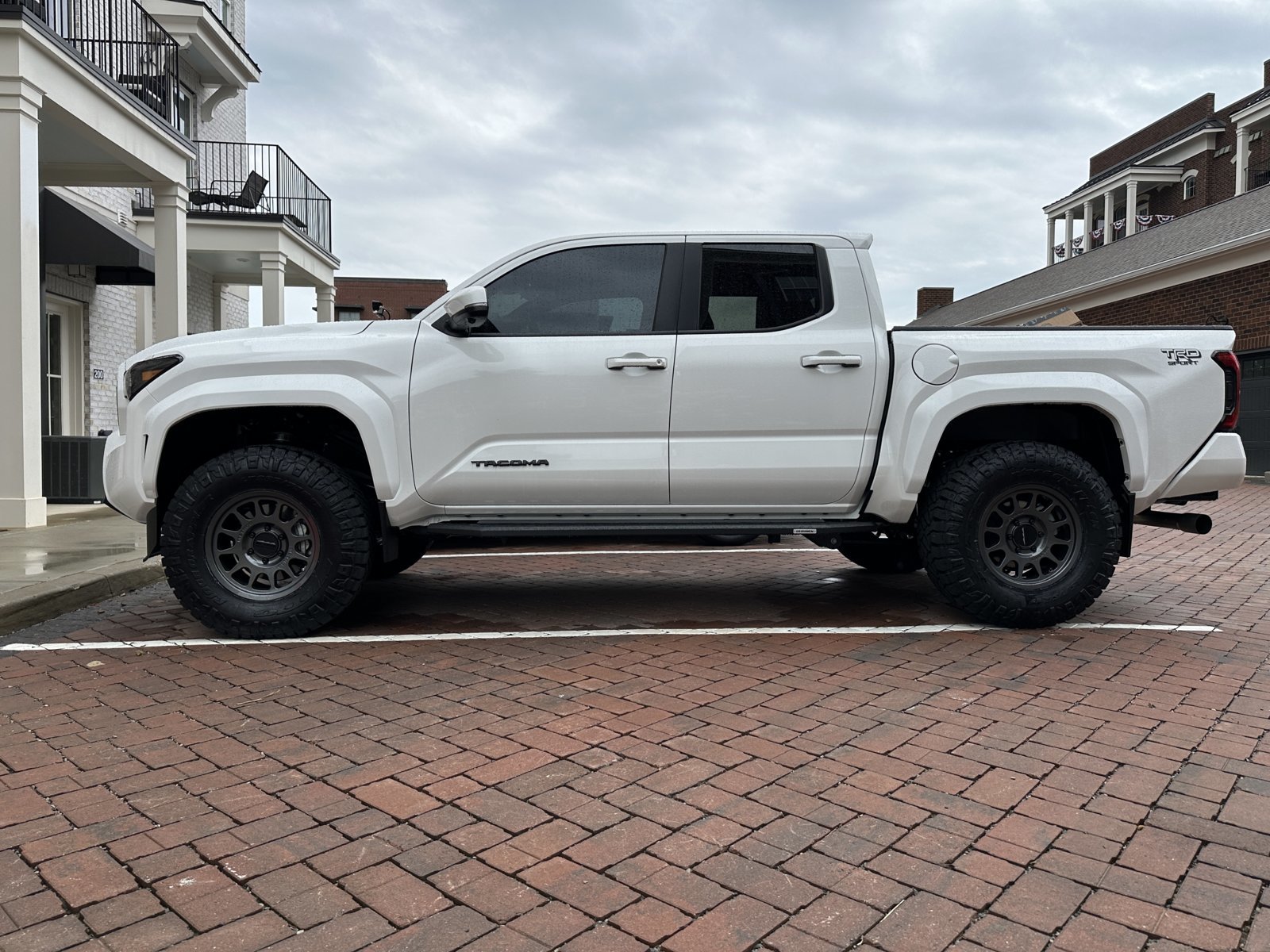

    After installing Ready Lift 2.5/1 spacer lift on my TRD Sport there is a vibration/shake coming from the drive train or wheels. Anyone else done same lift and experience vibration/shaking? It is at slow speed and highway speeds but more noticeable above 50MPH.
    On Method 703 17x8.5 on 285/75/17
    No other suspension mods.
    wheels are freshly balanced and alignment was done to recommend specs by Ready Lift

    Lt. Dangle
    Lt. Dangle RIP @stun gun 2016-2020
    Jan 25, 2017
    #208645
    7,655
    Ohio
    2025 Tundra Platinum OR
    Can't help with your issues, but truck looks great.

    196
    Hope you get it sorted out. Truck looks fantastic!
