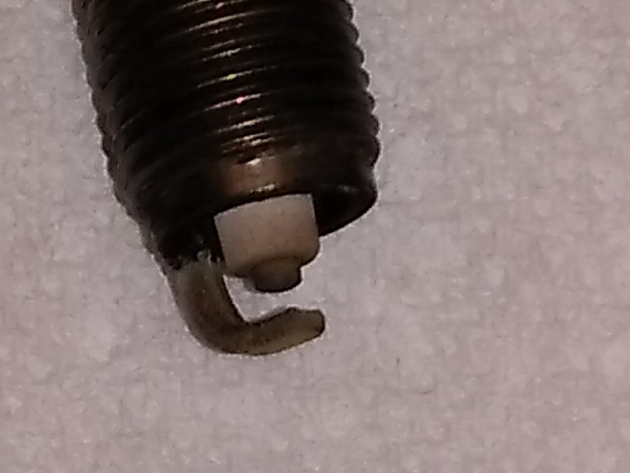

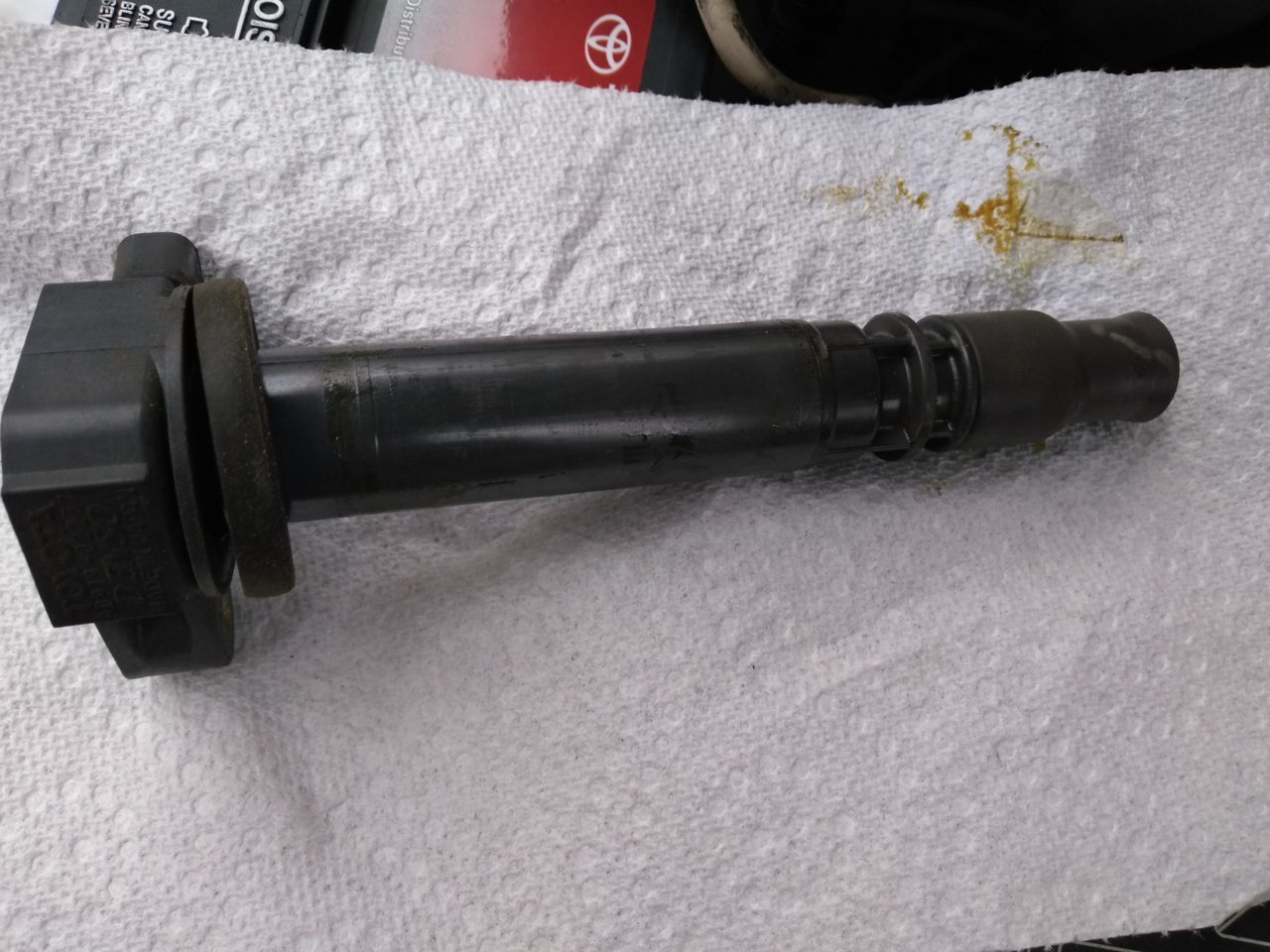

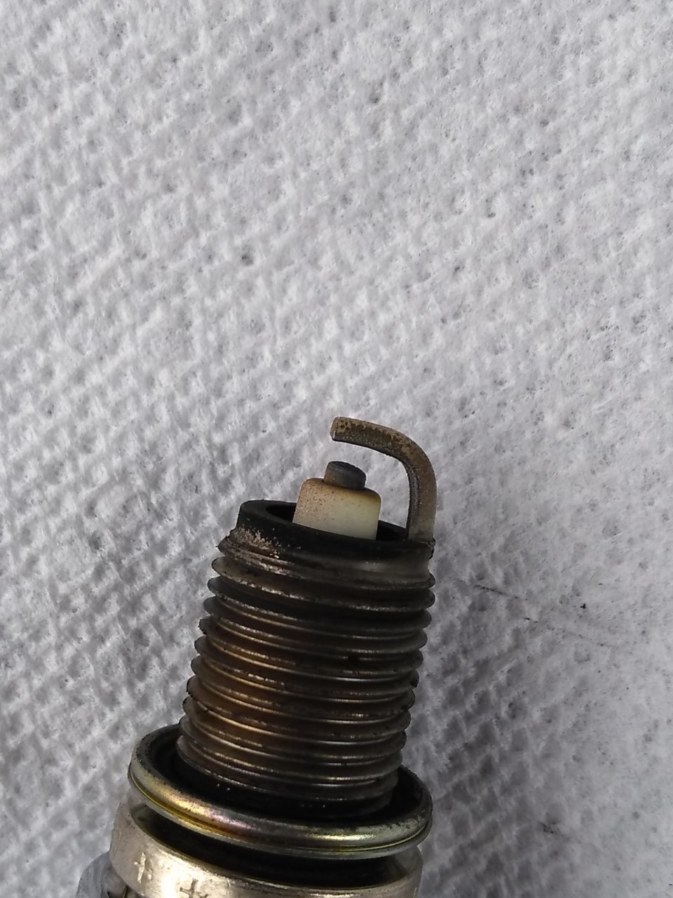

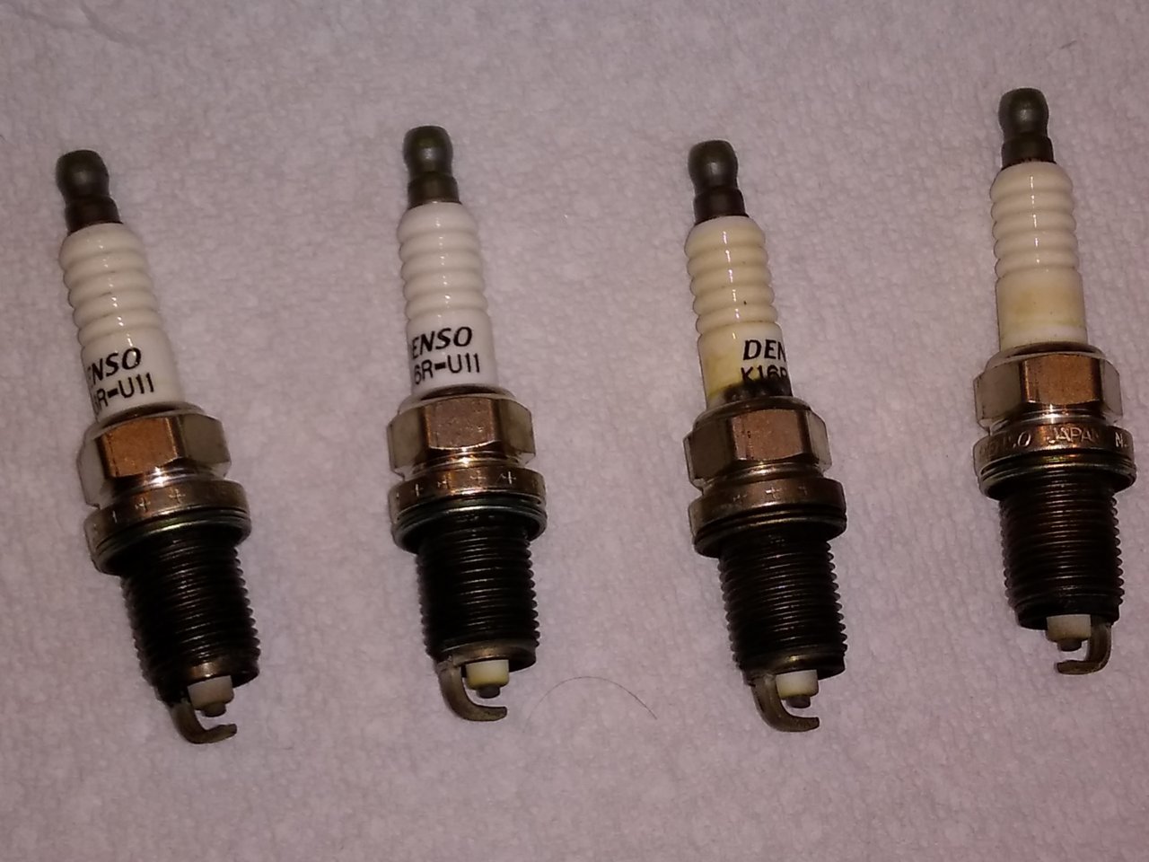

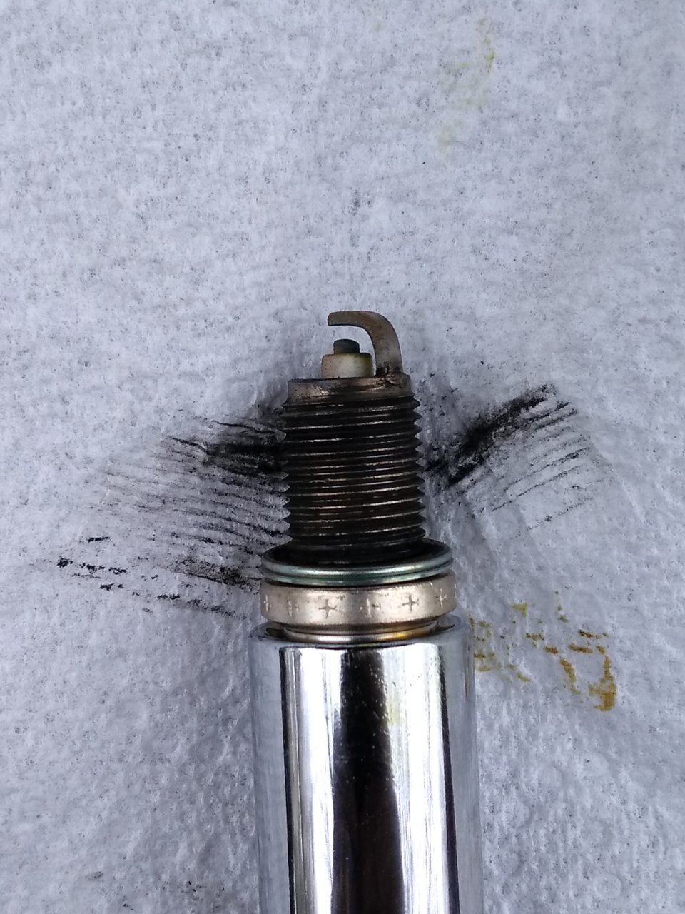

    I replaced the Battery and Spark plug and clean the Throttle body!
    It's running fine! There was a little bit oil around coil!
    I may replace the Fuel Filter next! Let's see if the problem comes again!

    Was gonna say in very beginning that video kinda sounded like my lil brother's Corolla about 6 years ago when he needed sparkplugs. Well I'm glad you found that. Hopefully you were just needing a tuneup then?

    The oil in the plug tubes you saw, when you do the valve cover replacement you'll wanna do those plug tube seals as well.

    There was a lot of oil on the spark plug! It cost me $25 + $90 to do everything!
    I hope the car run without any problem! For now sounds good! no misfire and no engine light!
