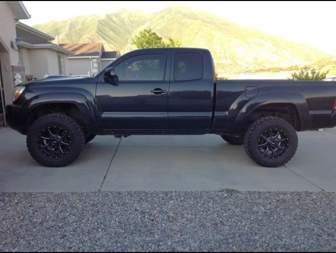

    Here is a picture of it. The guy said that when he had street tire on it didn't do it, but it just feels like a vibration coming from the rear almost like that feeling of when your front tires are too big and they rub the fenders when you turn but in the ass end.. Once I get going around 10 15 miles an hour it stops.
