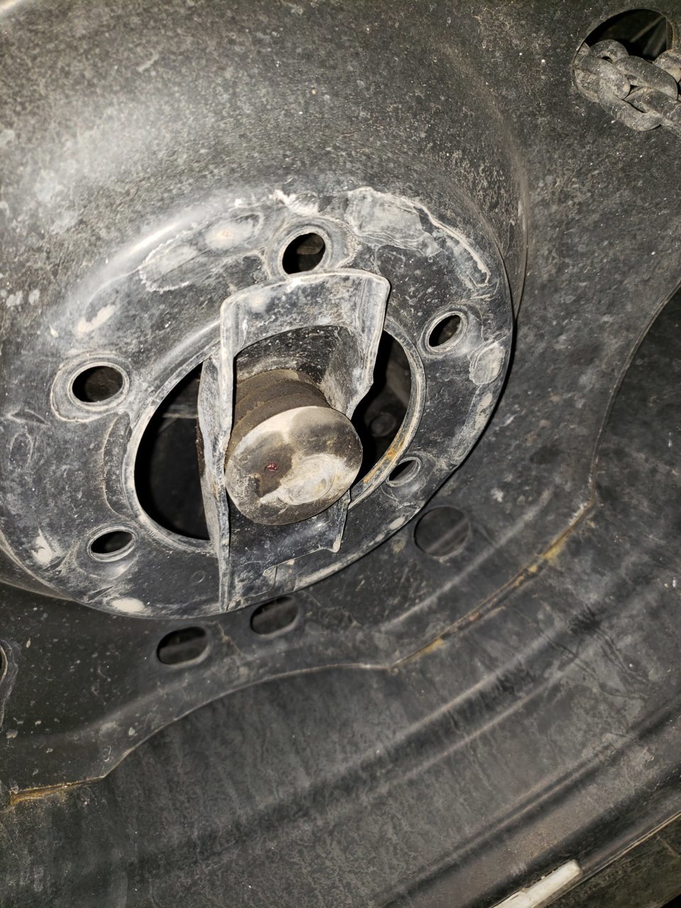

    I had a creaking sound when my 2019 OR was only a month old but it didn't sound like this. I found out my spare tire wasn't tightened enough after I installed the spare tire lock and it was causing the sound. My spare tire felt secure but hitting a bump just right or causing some flex would make it creak so I tightened it down really well and it stopped it.
    Good luck on tracking it down. I hope they fix it for you.
