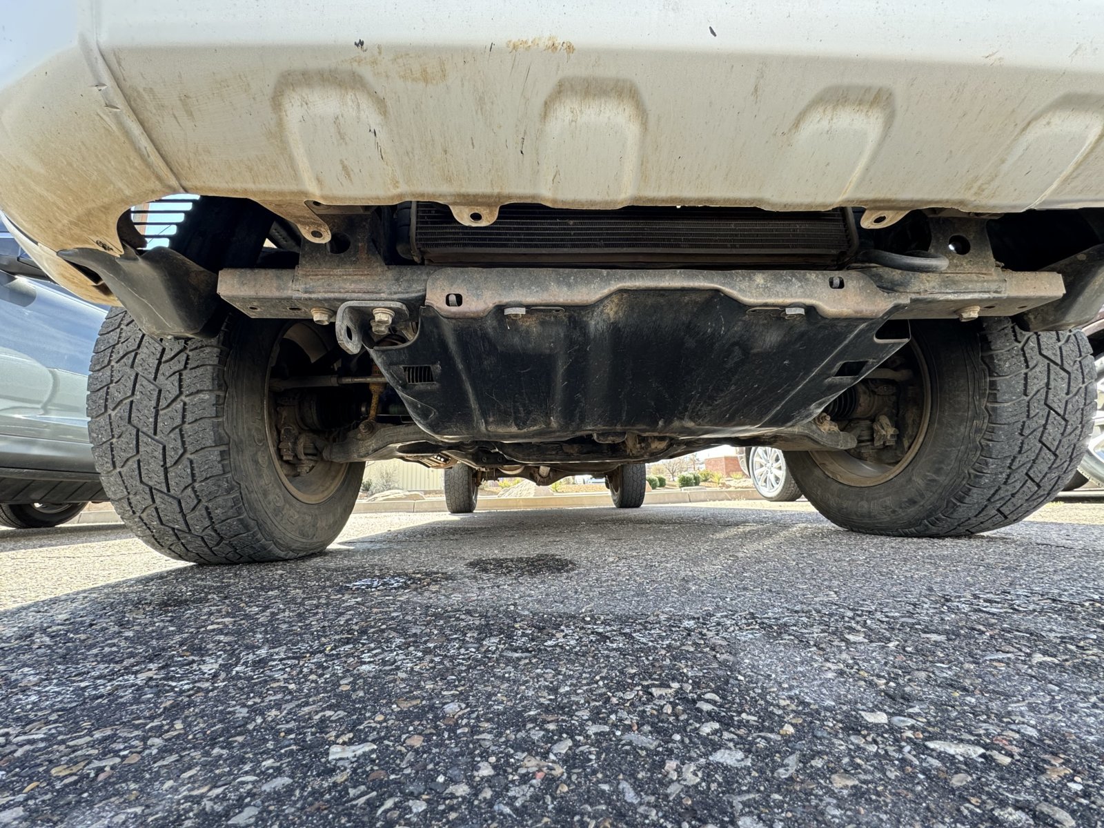

    @Dm93 - Got some pictures of the bottom as I’ve heard they could have rust issues. This car has been mainly out of CA and UT, wondering if there’s anything you could help point out?

    @Nickybons Undercarriage looks pretty good. A couple cans of Fluid Film can help prevent rust buildup. A marine corrosion inhibitor also works. I second paying for an used-vehicle inspection if at all possible.
