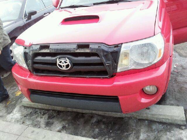

    @OP: The grille surround will go before the hood does. :D

    My grille is about to look like that, no joke
