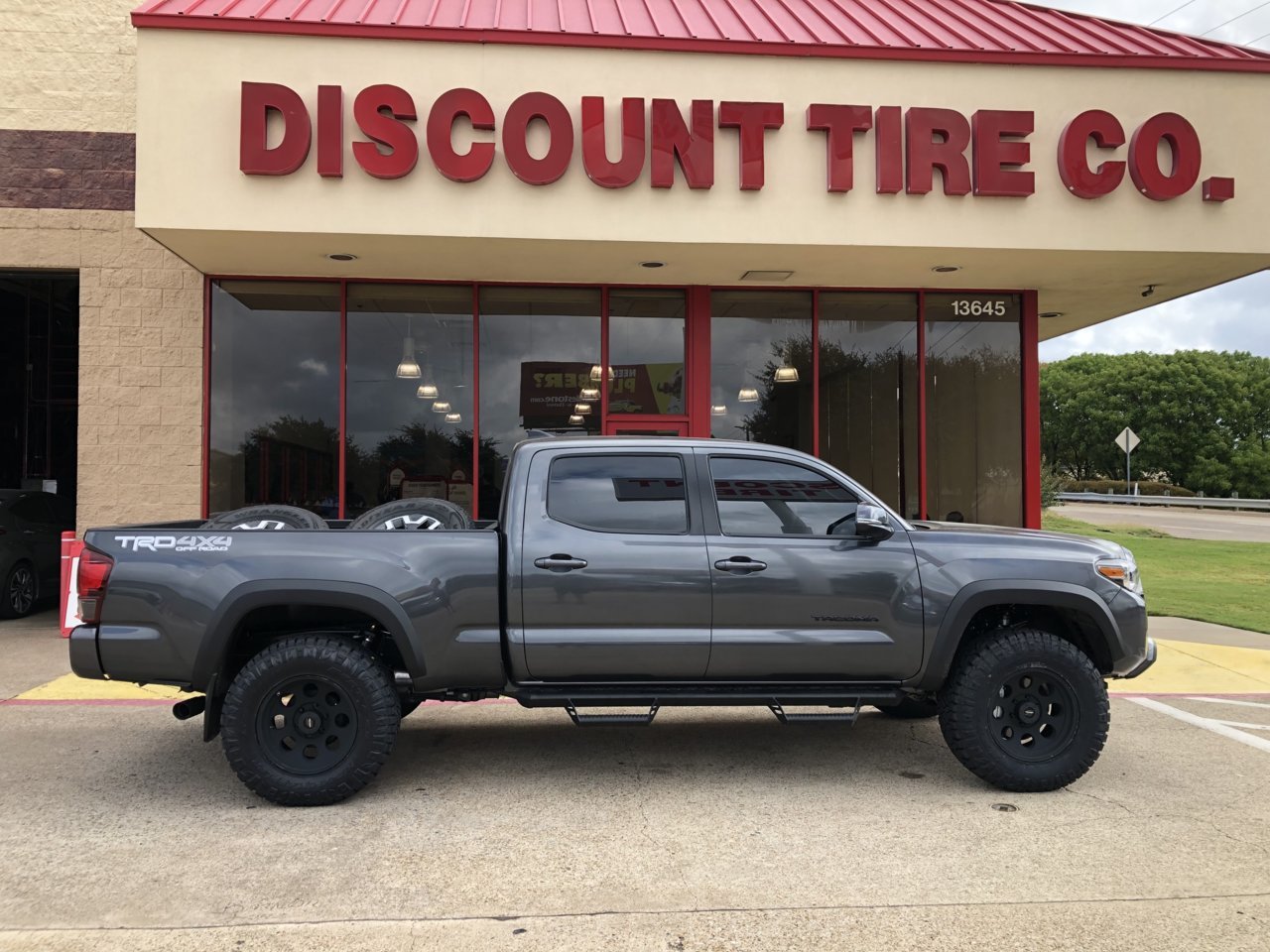

    I bought new wheels PRO COMP 69, and some Nitto Ridge Grapplers. I have had them balanced 9 times now, one alignment and an alignment check, and I cannot get rid of the shake in my steering wheel. When I put the OEM tires and wheels back on, the shake was gone. Discount Tire is telling me that the wheels and tires were not balanced together, they fixed it, they road trac balanced them, they have re-balanced them, and used different lug nuts etc.
    I am beyond frustrated. It is a brand new truck and I cannot get the wheels balanced.
    Please help...

    Can you say how the wheels were mounted on the machine? Did they use a cone collet with clamping hood or, fitted collet with lug plate?
    Specs on wheels(width, offset, bore) and tires?
    Can you post the alignment sheets?

    Contrary to popular belief, different wheels will change your desired alignment; especially wheels with a lot of offset poke. You're rolling down the road toe-out on both sides. That'll cause some shake.
    What are the specs on those wheels?

    Do you have hubcentric ring spacers?
    I'm seeing those at 108mm centerbore; spec is 106.1mm.

    The wheels do not require any hub centric spacers, according to ProComp and Discount Tire. I am changing the wheels out for some Black Rhino Amory wheels as they seem to be a better fit for Tacoma than the ProComp 69's. American Baja has a similar Old School look that I was going for, but I am mixing it up. Luckily Discount has been pretty good about helping me trying to figure out the issue and then help me get this sorted out.
    Basically we think the problem is with the ProComp Wheels and how they ride for the new trucks. They think that the wheel can't handle the weight of the tire, but when a passenger tire was put on it also had vibration. I wish I could figure it out, but I just don't have the time or patience to sort it out. It's too much money to have a brand new wheel/tire combo shake and vibrate.

    No...if it has a 108mm centorebore, they need the spacers.
    I'm seeing Black Rhino rims, with a 6x139.7 bolt pattern, have a centerbore of 112.1mm...they're not going to fix your problem.
    Your tire and wheels are most likely getting a hub centric balance.
    Without the spacers, your wheel is being mounted on the truck in a lug centric manner.
    Then there is the matter of wheels being supported by the wheel studs alone...

    The Black Rhino Armory wheels came with a hub ring and seem to have solved the issue. I had another bad wheel balancing but it appears that the shaking is gone and after another balancing, I finally have good ride quality. Sometimes I feel a little vibration but it is hard to tell if it from the road or from the Ridge Grapplers.
