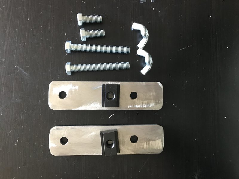

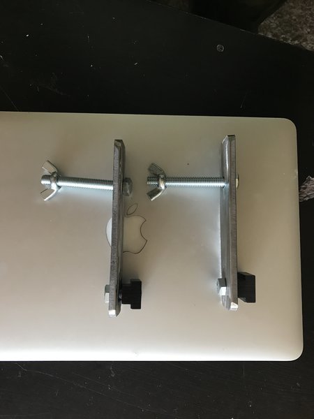

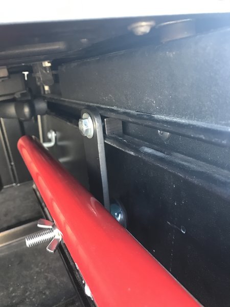

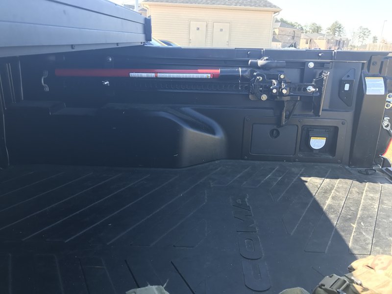

    Simple hi lift jack mount from some 1/4" steel bar.

    Is that a 42" or 48"?

    48 with two notches cut off the top. I cut them off to fit the jack in between the wheel wells before I mounted it

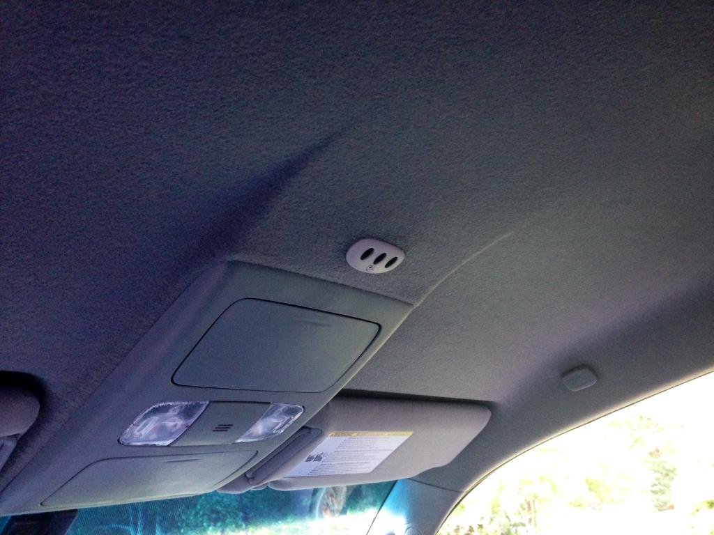

    $24.95 on eBay. GM Homelink module made for a mirror on an older GM truck.
    I just dropped the map light and grabbed power from that. It worked quite well. I'm sure you can retrofit it into the newer trucks as well.
    I'd do it to my new truck, but I rarely get the garage anymore, so I leave the opener in the center console.

    Where did you get the nut that slides in the bed rack? Maybe a simple google search, but only after I ask...
    EDIT: found these on Amazon:
    https://www.amazon.com/T-Slot-Finish-Tapped-Through-Threads/dp/B009SWGLHW
    Home Depot and Lowes weren't showing anything similiar. Would like to grab some locally if possible.

    Here's another option but I think the Amazon 5-pack with prime shipping is a better deal

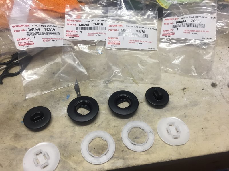

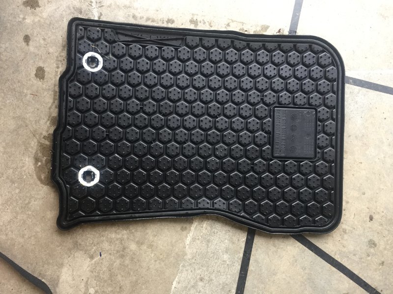

    DIY passenger side floor mat hold down.
