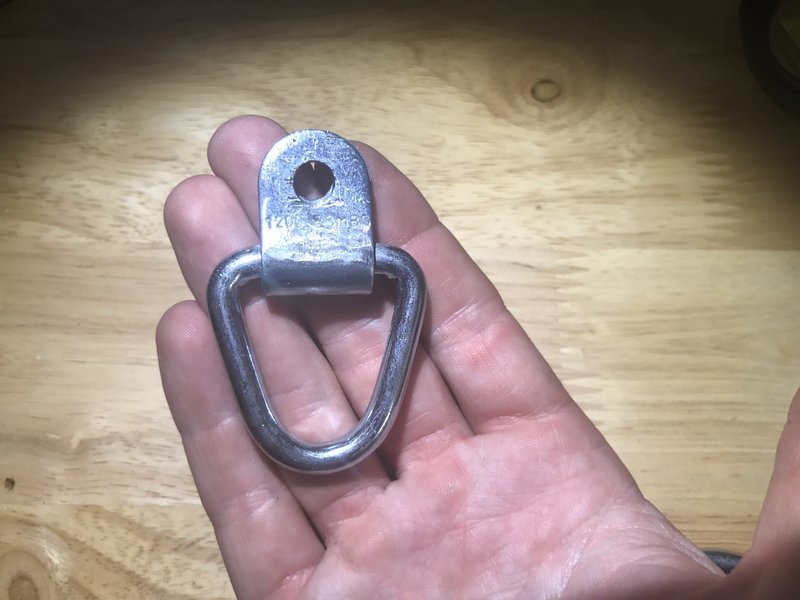

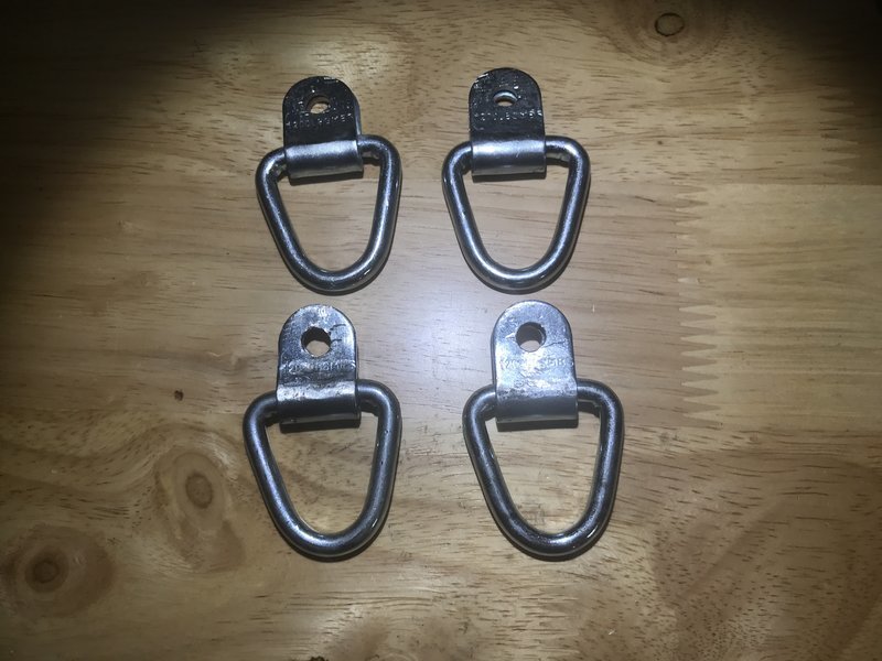

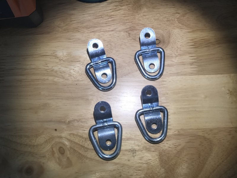

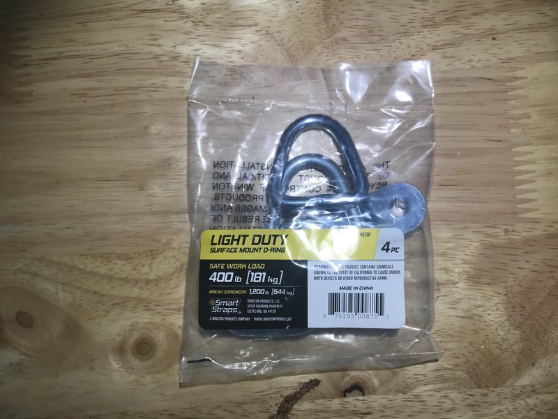

    Thanks for the great idea, @Pistol Pete! I installed these as well.
    I bought these from the local Tractor Supply Co for a few bucks. I pinched the d-rings together most of the way using two locking pliers. I then bent them the rest of the way using a hammer on an anvil. To make them blend in better in the bed, I used some self etching primer and matte black spray paint. You reuse the same bolts already there which are removed with a t30 torx bit.

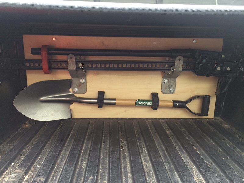

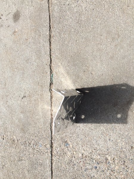

    I made a plywood mounting board on the front wall of the bed,
    I cut a couple pieces of 1/4" aluminum, drilled and tapped, to fit in the track, so I could mount my hi lift brackets and quick fist

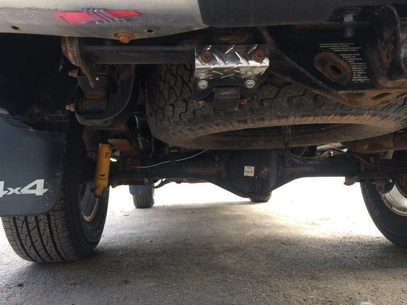

    I also fabbed up a quick trailer plug bracket relocation
