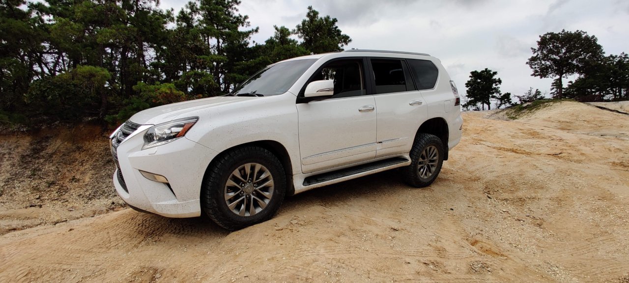

    I miss this bad boy. 2014 GX460, with Wildpeaks. That 4.6 V8 was a good motor. I used to watch jeeps breakdown left and right in the NJ pine barons…. lol.
    Soon the new Tacoma will get a workout as well. Agreed about trying to find some gravel or dirt to give the 4wd a workout.
  17. Jul 26, 2023 at 9:58 AM
    #37

    Where is this spot at? Are you still allowed there?
