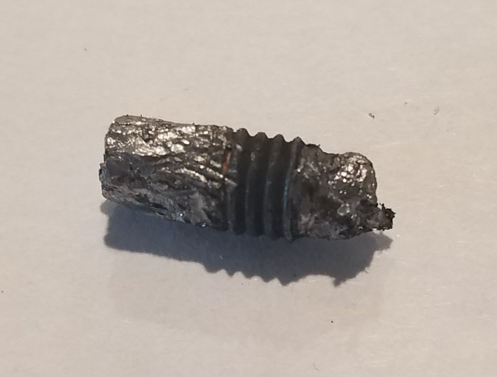

    Below is the successful result in my most recent lesson in persistance :thumbsup:
    (Not a vehicle part, but over an hour fixing someone else's ham fisted work)

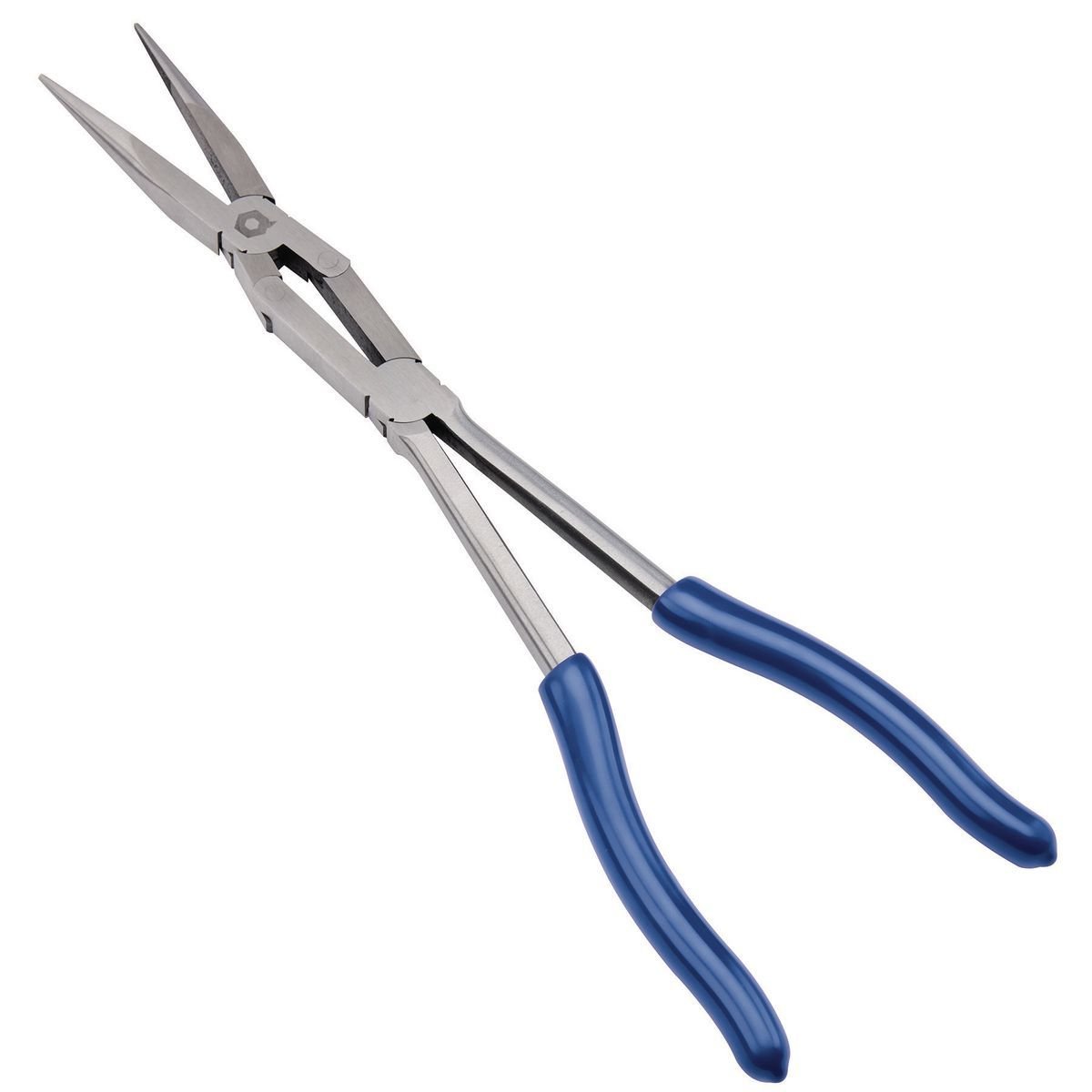

    Long reach / double jointed needle nose pliers helped me so much when I had a spark plug boot melt over the plug and create a similar situation. The second joint allows you to open them inside the spark plug tube. I think I was at it for 2-3 hours but eventually it did work.

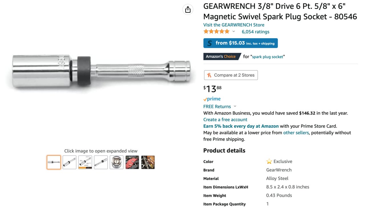

    Wanted to put this up here. I recently came across this spark plug removal tool which is perfect for our trucks. This makes changing our plugs super easy.
    swivel and magnetic.
