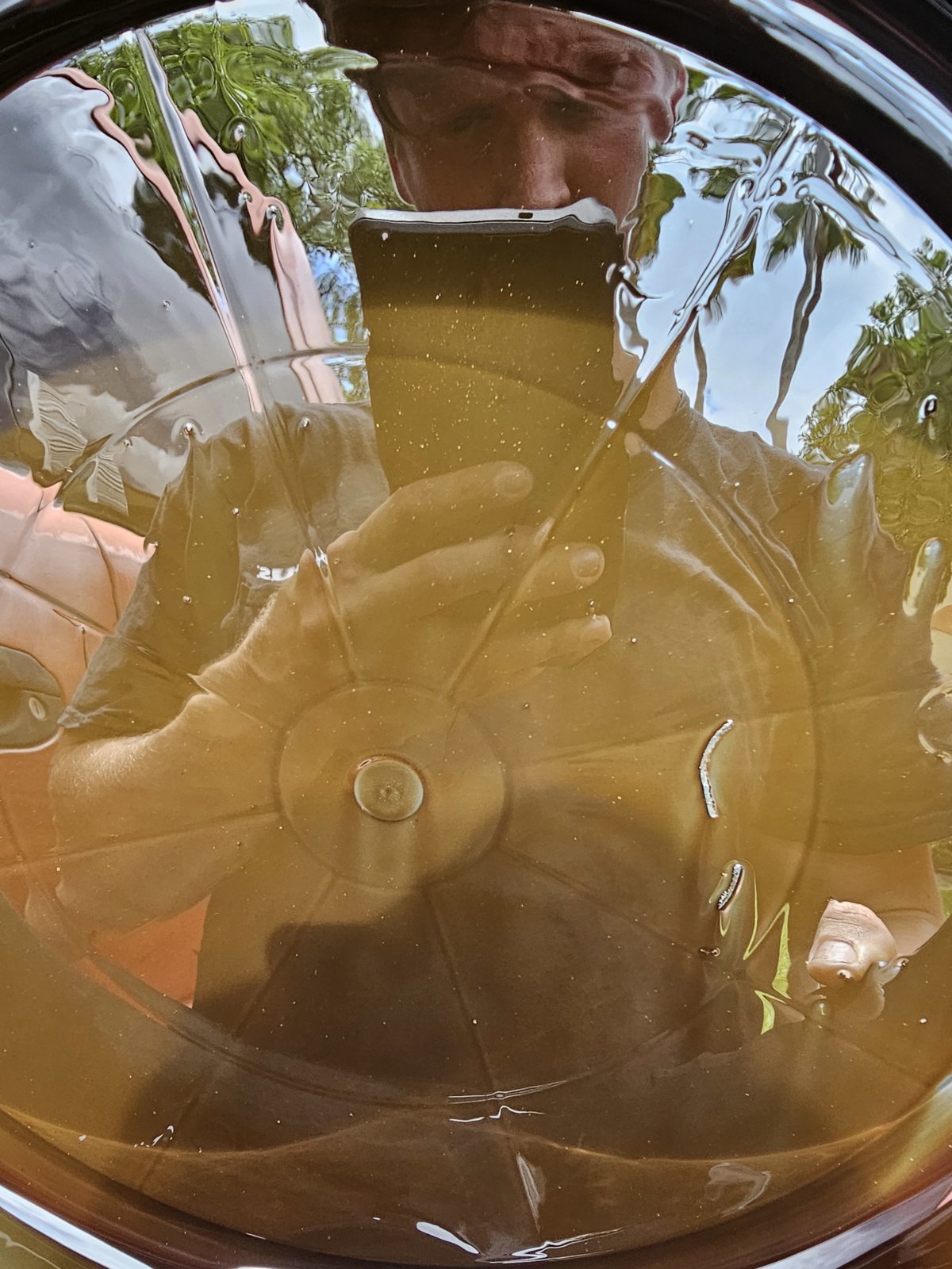

    Hey all, ive got a 2023 sr5 4x4. I Changed my oil for the first time myself today at 16000 mi. There seemed to be alot of metal shavings in the dirty oil... how much is too much and should I be concerned?

    If you have the oil filter cut it open with a hack saw and check the filter media for more metal shavings . If you see a noticeable amount of shavings go to your local dealer and show them

    That seems to be a lot of metal. Especially those large chunks. I would be concerned if I saw that.

    If this is your first oil change then give it another two or so before you judge. That's break in debris.

    Nothing to worry about there...

    Totally normal to have shavings on the first oil change. I did the first change on one of my vehicles at 2000 miles and it looked 10x worse than that. Had very little issues with it over the 15 years I had it.

    Can't say one way or the other looking at pictures like this. Get a sample tested at Blackstone if you're concerned. You still have 44000 miles to figure this out :cookiemonster:

    If the dealer has been servicing the truck, you've only had one oil change. They only provide them at 10k mile intervals. Although alarming, the metal shavings isn't out of the ordinary.
    I did my own oil changes early and frequently to get that out.

    Echoing what others have said, shavings during the first oil change are normal since the engine needs to break in. I’d drive it for a few hundred miles with the new oil, then change it again. If there’s still shavings, take it to the dealer (since I’m assuming it’s under warranty) or send a sample to Blackstone so they can see what the metal is from

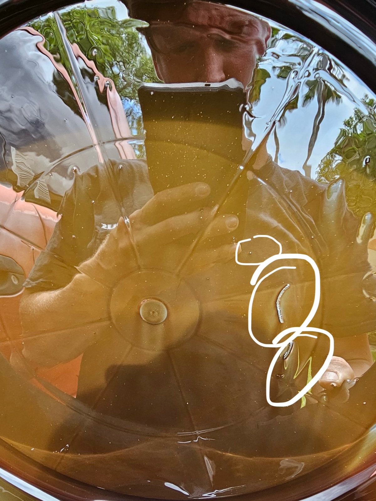

    Did these pieces come out of the oil pan?

    Wait, is that on the bottom of the pan? How many miles on that oil becasue that is some clean ass oil? I can never see the bottom of my pan at an oil change and I do mine at 6500 Blackstone will give you the deal but you real have to take the sample midstream on a warmed up truck. Maybe wait until next change for a sample

    LOL didn't see those. For the OP's sake I hope not.

    If those came from the filter, I would question if they changed the filter at the 10k OCI. If those came from the oil that drained directly into the pan, then I wonder if they changed anything at all.
    I'm only at 7500 miles on my '23, and I did my own change at 5k. There were a few smaller metal particles in the oil, but nothing quite as big as those circled in post #14.
