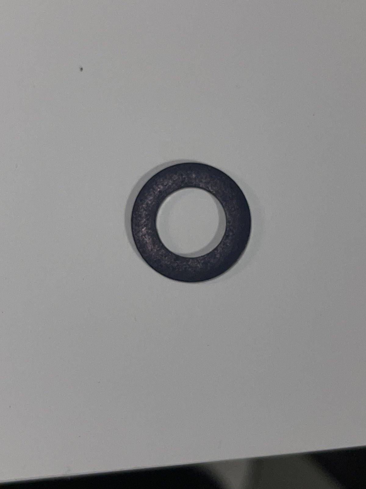

    Scraped parts of crush washer from where exactly? Not from engine oil drain plug, washer for it fiber material.

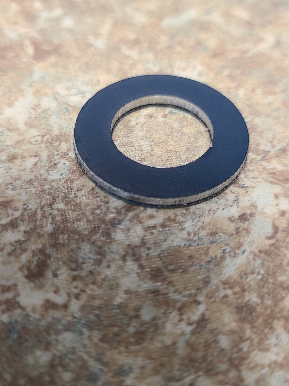

    There are many crush washers / gaskets in the world, made of many different materials.
    Nylon, copper, aluminum, fiber, etc., etc.
    OEM Toyota Crush Washer pictured here, for example..

    I get plenty crush washers in the world.,The photo I provided, was for Toyota engine oil drain plug washer. Maybe OP did not clean drain pan, before draining engine oil. I dnk. I don't want to blow things out of proportion.:D
