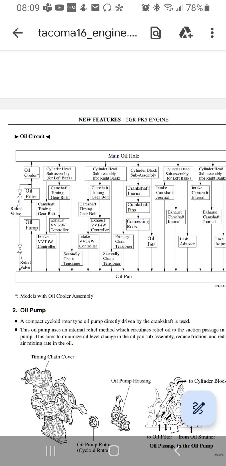

    This leads to the question, where is the oil filter in the oil circulation circuit ?

    On a wet sump engine (ours) it's typically right after after the oil pump, if it has an oil cooler it passes through the cooler before the filter in most cases.
    Goes from the pickup to the oil pump then the cooler if there's one then on to the filter followed by the bearings and other items requiring oil lubrication. It's considered the pressurized side, return side uses gravity to flow back into the pan where it starts over.

    Fliter, then cooler
