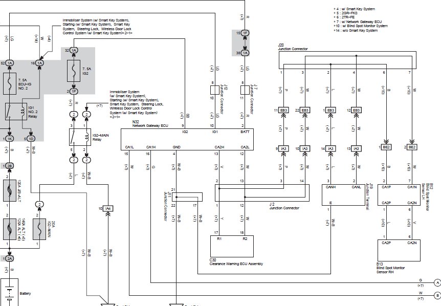

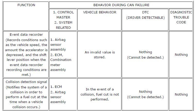

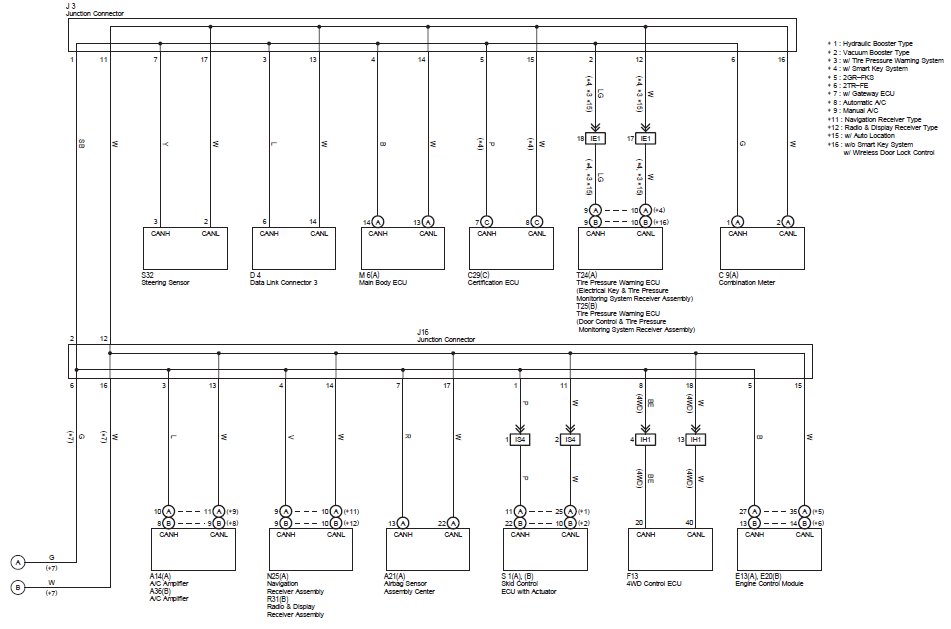

    Think you are spot on, except it might also be if it decides to fuel cut without airbags. (Don't know precisely what criteria that might be if it does exist...)
    You never know what additional stuff they hide, but it seems like the event data recorder is part of (one of the) ECUs, most likely airbag ecu. There appears no reference to any stand alone event recorder on the CAN system schematics or the airbag system schematics, and it would certainly have to be tied into the CAN network to get data on the various systems.
    The repair manual does discuss (briefly) the event data recorder in the failsafe chart, but looks like it is just embedded in airbag ecu (possibly engine ECU or comb meter, but I think those are just data sources). I think the comb meter connection is just for the idiot lights, and the ECM is the other main data source.
    Best I can tell, you get the standardish freeze frame data from any code producing events (which are viewable in techstream, etc), and probably a longer recording that correlates to airbag deployment or fuel cut. If your axle failure didn't throw a code, I very much doubt it would store any freeze-frame data about the failure at all, unless airbags deployed or at least the fuel cutoff trigger was met. Its possible it met the criteria of an event, but didn't throw a code, but I doubt it.
    For example, when messing with the front ADD, I could get a 4wd mode change error displayed. This stored a freezeframe data set on the ECU, but the idiot light on the dash could be cleared by just power cycling the engine. It would be really hard to know very much from that freezeframe data, if it was related to the event, and if so, before during or after the event.
    Nothing on the airbag system schematic that looks like a data recorder.
