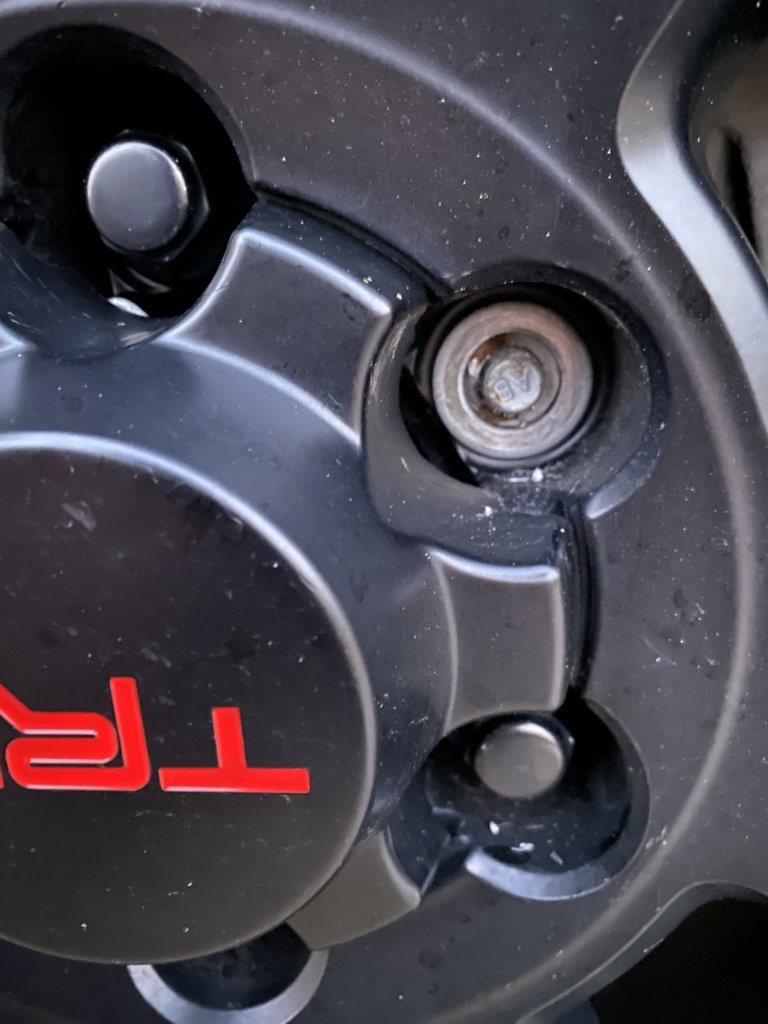

    I will preface this by saying nearly every vehicle I’ve had before calls for 90-100 ft/lbs torque for lug nuts. Just rotated the tires today and sheared a lug nut off. I was torquing them with my craftsman digital torque wrench that I use on all lug nuts and it didn’t even reach the 95 ft/lbs I had it set at when it sheared off. They are OEM Toyota lug nuts on OEM studs. Now after looking up the specs it seems Toyota calls for 83 ft/lbs? Unbelievable that over torquing by 10 ft/lbs will shear a lug nut
    Anyone have any bright ideas getting this out? I haven’t tried taking the wheel off so maybe it will still come off but I’ll work on it again tomorrow. Thanks in advance

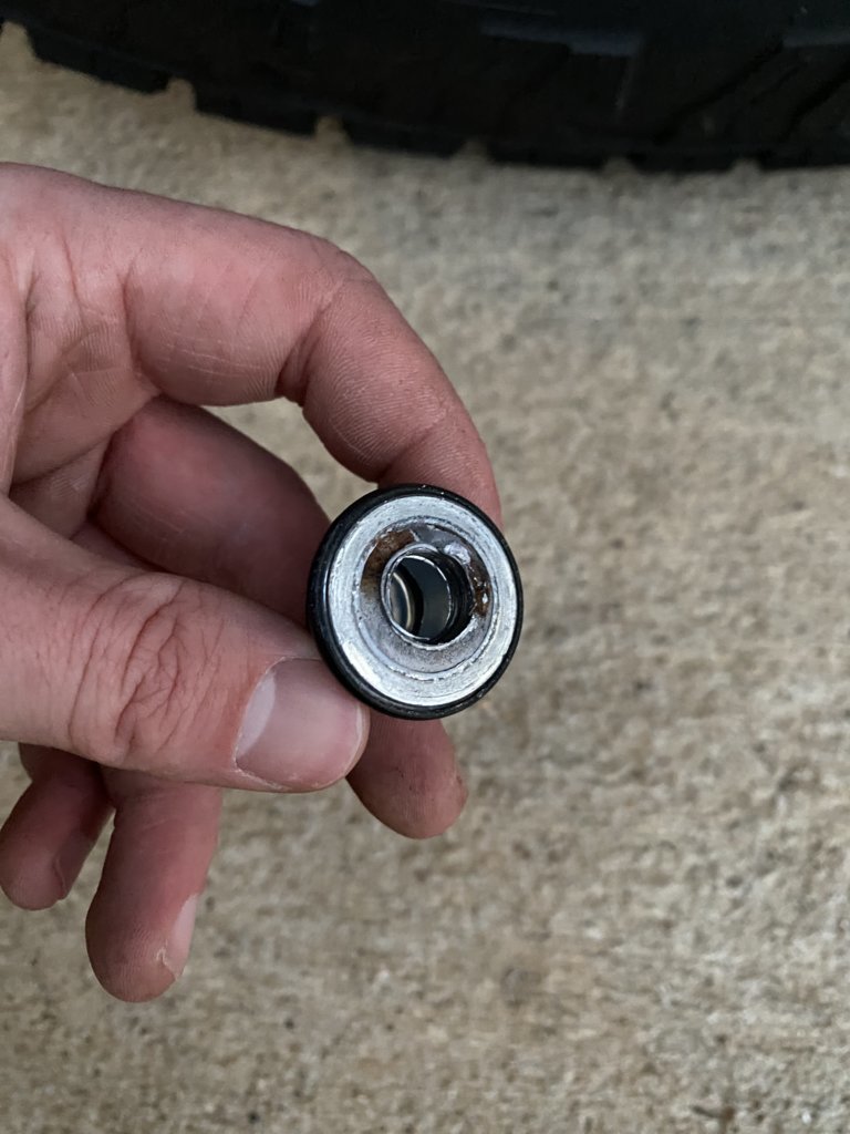

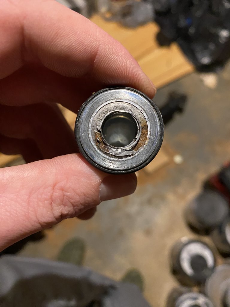

    I don’t know if it’s how the nut broke or what but it looks very porous to me? I’m assuming this brown/rusty looking discoloration is just heat from when it actually sheared? I guess it’s possible this lug nut is just a fluke?

    Anyways, you are going to need a drill.
    The studs are M12.
    Once the stud is gone, the shank of the lug nut will come right out.
    DO NOT DRILL TOO DEEP.
    If you open up the hole for the stud in the axle, it's BAD NEWS.

    The wheel should still come off, that part of the nut shouldn't be holding anything.

    .It's happened to me a couple of times, take the wheel off & the shoulder should spin rite off.

    It wasnt the 10lb over torque that caused it to fail. The rust shows it was already compromised before it failed completely. Maybe it got hit with a few too many ugga duggas on an impact a few times, maybe it was just bad metal to begin with.

    You shouldn't have to drill anything. The stud looks fine
    Just get a new nut, or a set..

    I think I’ll just replace the whole set. I’ve been rotating these wheels for years the same way I did last night, I bought these lug nuts about a year ago to match with the powdercoated wheels. They are OEM Toyota lug nuts, and look just like the actual OEM ones I still have in my garage somewhere except the old ones are chrome….need to find them today. Anyways. I wonder if the black ones are weaker than the chrome ones. Who knows. I just know I’ll be torquing them to 83 ft/lbs now lol, and I’m glad I broke a lug nut instead of a stud
