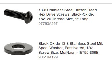

    Did you install yours with thread locker or antiseize? I believe this is the root cause of the issue. I think if you used one of those that there probably would not have been any corrosion or shearing. I bought mine second hand and the previous owner didn't use any :(
    I had to look up my order... when I ordered mine I added on the screws they suggested. I didn't think about it at the time but when it arrived I realized the hardware was silver and didn't match. I didn't want it to stand out because I'm picky like that. So, I ended up spending more money than I'd like on some stainless steel black oxide hardware from McMaster.
    I bought enough to replace all of my hardware (not just on the replacement crossbars) but that then puts you in the predicament of having to remove the other hardware, which means you might shear another screw and then need to buy another replacement crossbar. Ugh. So I just left well enough alone. For now.
    Tacoma_SR5Pro[QUOTED] likes this.

    That is precisely my worry... and I would also be OCD about not matching screws, and would 100% purchase the black oxide ones. I appreciate you posting those so I know which ones to purchase for myself! I did not use any thread locker or antiseize so you're probably right. I am still very relieved to know that there is a $20 alternative to the $75 OEM, that was hugely helpful! You have no idea. I truly appreciate that. I just need to order that and the additional hardware. Thank you!
