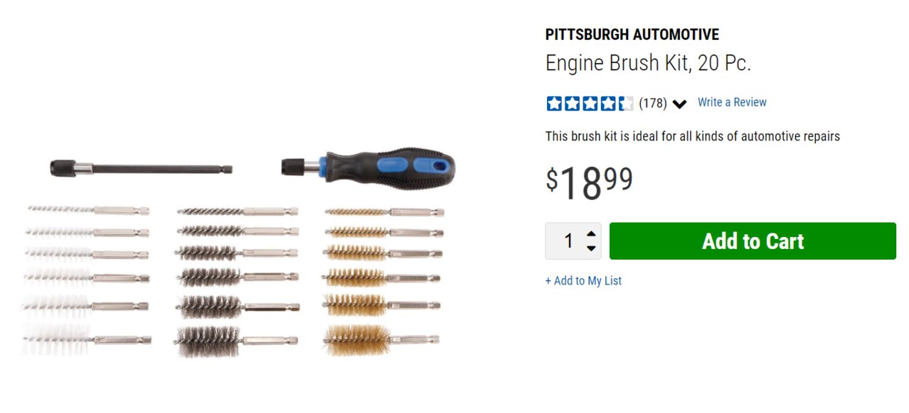

    This makes it alot easier too! You can chuck up these brushes in a drill:
    Wyoming09 and Dalandser like this.

    Was looking at something similar. I assume just use the brass ones so they won’t bugger up the threads?

    Brass or the steel one.The steel wires are relatively weak in comparison to the threads in the holes. You just want enough to knock off the rust in there. Don't go to 11.
