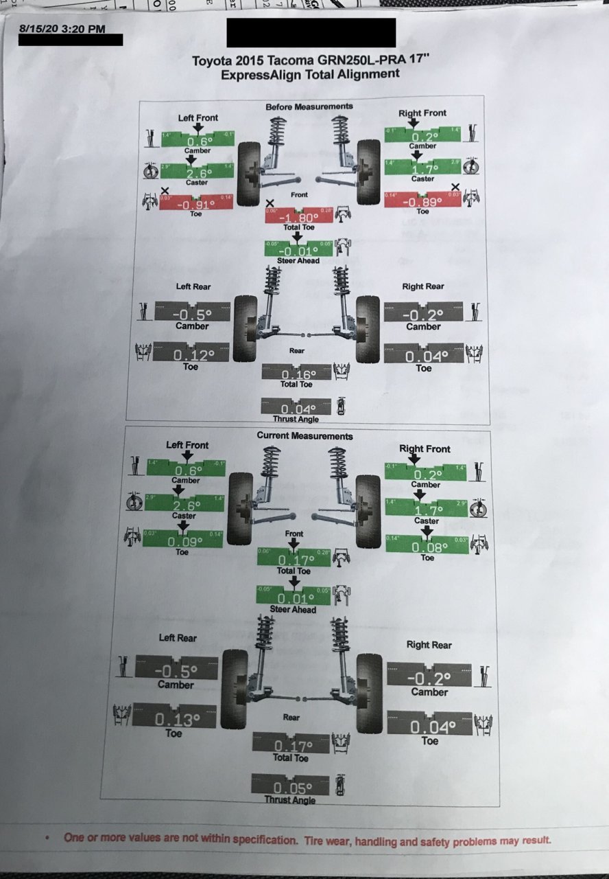

    Hey everyone, requesting some assistance diagnosing a peculiar sound coming from my truck.
    I got my Dobinsons 3" front/2" rear lift installed today. Brand new front suspension (GS59-220 shocks and C59-350 coils) and rear suspension (GS59-940 shocks and L59-111-R leaf packs). My initial impressions are favorable, but I will hold my judgement in reserve until I get some more miles on it. Pics will be provided if anyone wants to see.
    The install went as smooth as can be expected. I had the ECGS bushing and Offroad Solutions high angle inner CV boots installed in advance. I had a sway bar relocate kit installed with the lift itself. I have SPC UCAs installed as well, which I confirmed are not part of the batch of bad X-Axis bushings. E-brake line brackets are properly secured to the leaf springs with extended bolts (required for these leaf packs). Ball joints on the SPC UCAs and 4x greasable bolts for the Dobinsons leaf packs were thoroughly lubed with the prescribed lithium-based 3-5% moly grease. All bolts are torqued to spec. Driveline angles are within Spicer recommended limits.
    Here's the issue. I'm getting an intermittent noise that sounds an awful lot like something smacking into or bouncing off sheet metal. I mostly notice it at low speeds, but that doesn't necessarily mean it doesn't happen at highway speed. It seems to happen regardless of whether I'm on the gas or braking. It happens whether I'm driving on smooth concrete or over manholes/road imperfections. From the driver's seat, I can't quite pinpoint whether it's coming from the front or the rear.
    Does anyone have an idea of where I should start my diagnosis? I want to say it's something whacking the splash guard(s) for the front brakes, but it could easily be something else.

    I got the truck aligned at my local Firestone yesterday, since everyone else was closed. It turns out that they had a couple great alignment techs working, who got everything dialed in pretty damn well. Funnily enough, once I got the alignment done, the noise vanished. Neither the techs nor myself know what was causing the issue, but it seems that it might have been related to the alignment being so far out of whack after getting the lift installed.

    Is it just me or is your caster/camber measurements exactly the same before and after the alignment?
  14. Aug 16, 2020 at 7:50 AM
    ardrummer292
    ardrummer292 [OP] 500k or bust
    Feb 27, 2020
    #320484
    1,144
    Austin
    Virginia Beach, VA
    2015 DCLB V6 A/T 4x4 1D6
    Overbuilt daily driver
    They are indeed. I guess I got a "toe 'n go" alignment, which is about what I expected from Firestone. Honestly though, the truck tracks straight as an arrow now and has almost zero tire noise. This will be plenty good enough until I get my LCA hardware replaced and get a no-sh!t perfect alignment prior to upgrading the wheels and tires.

    Grey 2015
    Grey 2015 Well-Known Member
    Mar 26, 2016
    #182375
    816
    Skip
    Loxahatchee Florida
    2015 Tacoma
    Well to their defense it is in the green. Lol!

    Yep, my thinking exactly. It doesn't have to be 100% perfect until I get my up-sized (and expensive) new tires installed. There's only so much they can do when working around seized LCA hardware anyway.

    That's very unusual for a just a toe in alignment to correct your issue. My guess is that you had inadequately torqued suspension related parts during the install that was fixed with the alignment.
