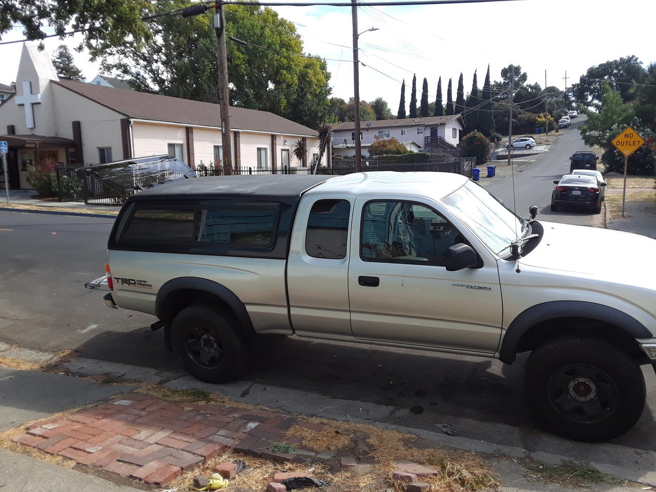

    Where would be the best place price wise for replacement bed gasket? It's a leer shell, have to see if I can find a model number 20170924_144340.jpg best 200 bucks I've spent..

    If you’re talking about thenone that goes on the bed sides and front you can get some stuff from Home Depot that’s made to seal doors. It’s styrofam and is sticky on one side.

    Like the closed cell foam? Dang, that's a great idea.thanks

    Yep. Cheap and it works. I don’t know much about first gens but I added some silicone to the front corners of mine as well for the second gen as water is forced in there while moving.
