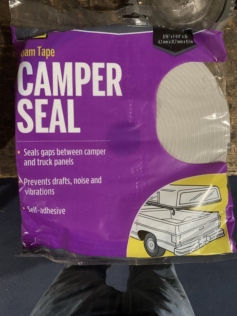

    Getting a topper/camper shell specifically made for Toyota 6 foot bed is great but there are others that will fit and work well. For consultation I’ve talked to Leer customer service and a few of the larger distributors like Mid America in Eureka Missouri. As stated the Toyota truck bed front rail is lower than the bed sides and you can use this weather seal available at Lowe’s to build it up. I think we used 3 or 4 layers. Try as you might you’ll never get a perfect seal, you keep water out but dust and dirt? Good luck.
    Last time I bought this was about 7 dollars a roll and 2 rolls to do the job. Some only use 4 tie downs, use 6 for better seal.

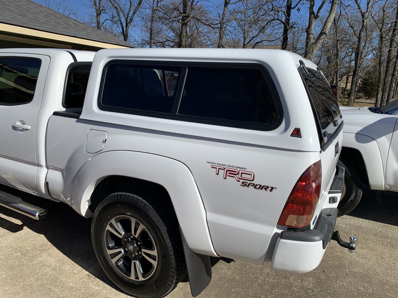

    in this photo you see a 5 foot shell on a 6 foot bed. Now look at the fit you see it’s wider at front so you’ll be taking measurements near front and at the back because the Toyota bed is not square. BTW that foam tape is great.

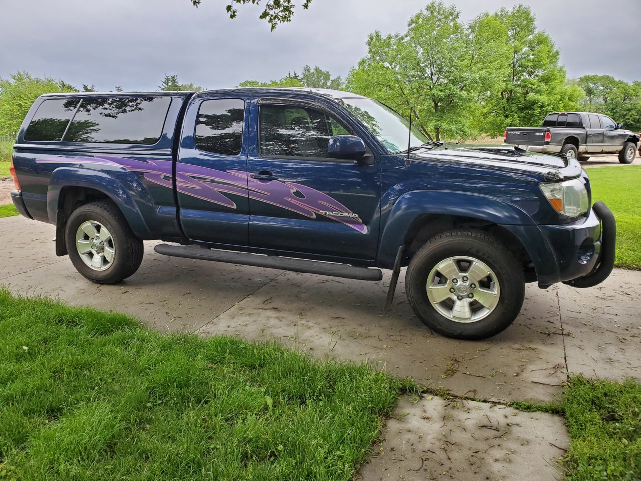

    If you are still looking I have one no longer need, it's a Jason came with my truck a 2006 access cab 6' bed. If interested I can take more pics. located between Lincoln and Omaha NE.20200526_192221.jpg
