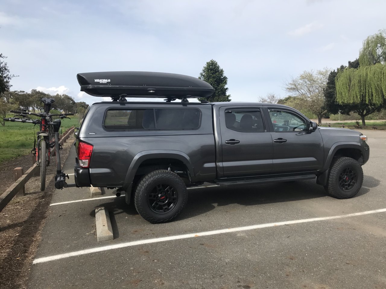

    I am looking to lift my 2017. I have a Snugtop camper, Yakima cargo box, and Yakima Fullswing that holds up to 4 bikes on the hitch. I also have a custom-built bed platform made out of 2in plywood. My rear is slouching so I have been looking into options as well.
    Talking to a local mechanic that is also here on TW. He mentioned that the heavy comes with firm springs that are usually if you have a heavy bumper and/or winch. He recommended the mediums.
    I have been looking at this OME lift kit. Not sure what tires to add to it.
    http://www.lowrangeoffroad.com/toyo...ift-kit-medium-load-2-ometac16mksb-11417.html

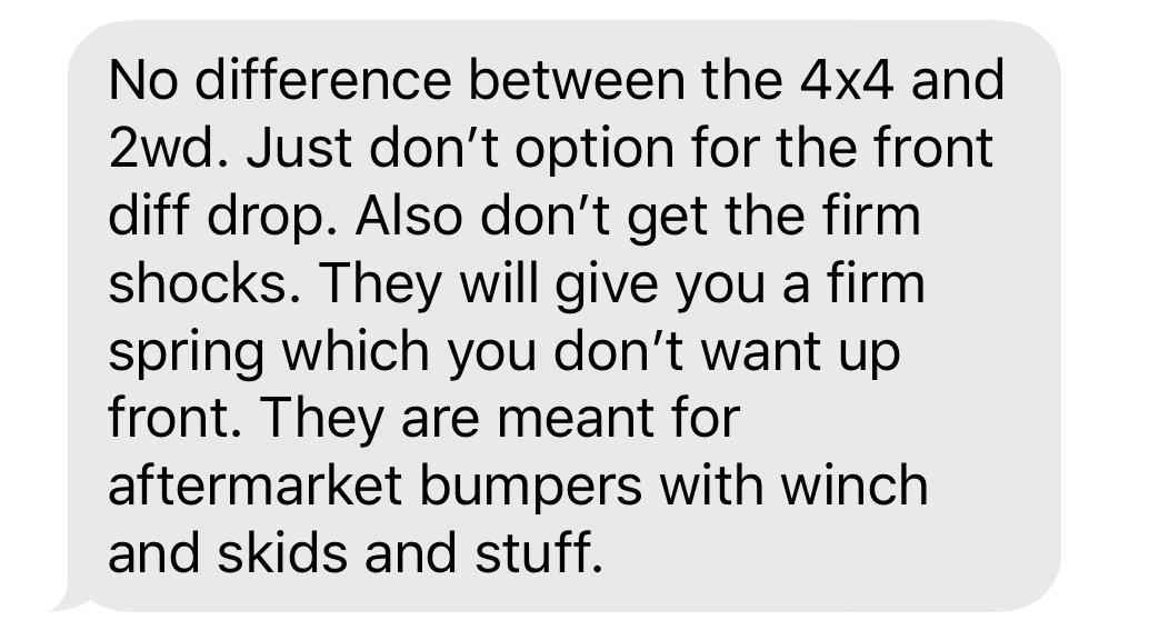

    May not seem firm because you have the steel front bumper and winch? I’m not sure but I’m going to go with the mediums. @Snaeper
    Here’s what the mechanic said to me:

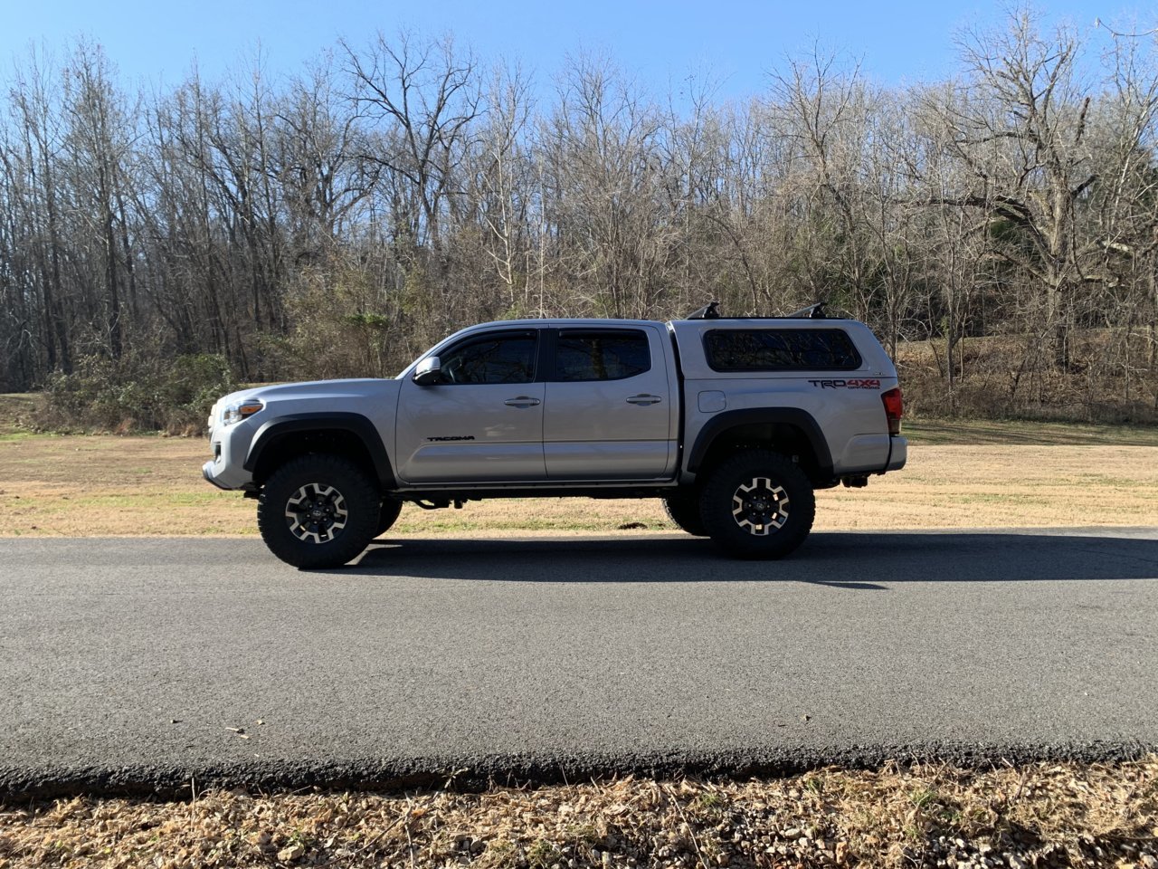

    Wow, I forgot about posting on this thread. I ended up going with the heavy duty Bilstein kit with 6112s in the front & 5160s in the back.
    Here is the link where I bought it:
    https://www.rogue-offroad.com/product-p/tacostage4-.htm
    I added replica 17” TRD PRO wheels with 265/70/17 Falken Wildpeaks.
    I like the drive and feel the weight is much more supported.

  18. Apr 4, 2020 at 6:23 PM
    #18
    IluvTaco
    IluvTaco Well-Known Member
    Mar 12, 2019
    #286356
    142
    NorCal

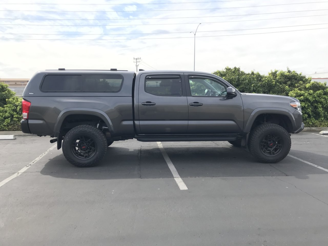

    2020 DCLB OR
    How she sits without all the added accessories. Also forgot to say that the mechanic I worked with recommended against sumos when I brought it up to him. Forgot his words exactly but something along the lines of, the rear sits higher on the sumos and may have more sway. Also the compression of the springs aren’t the best. So I didn’t go with them

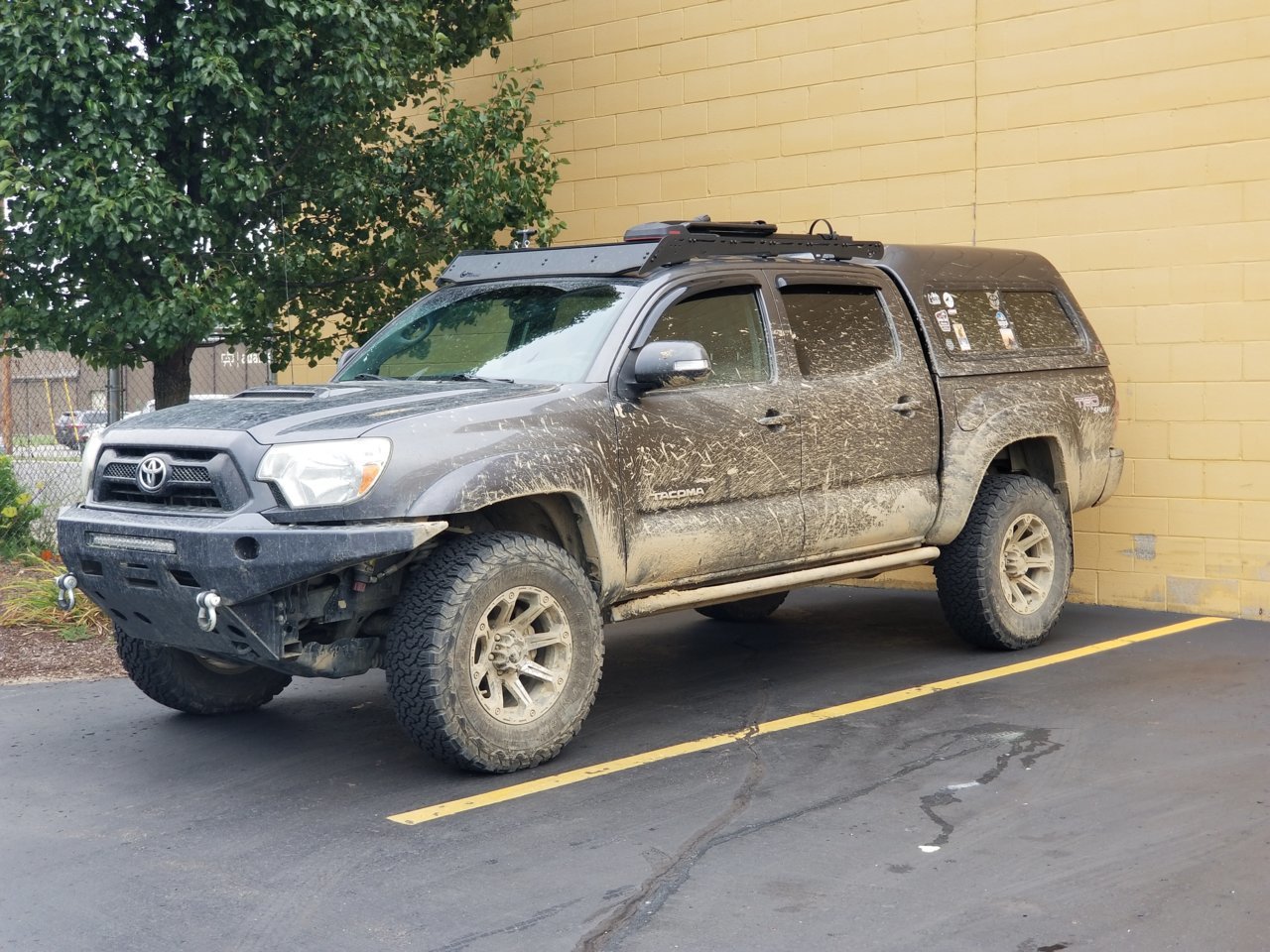

    Forgot to post. Running the RXTs with the Leer 180cc on both the 2017 and the 2013. The springs are set on the mid-weight setting. Can't remember exactly how much lift it gave, should have written it down. Definitely more pliable and pleasant than stock on the road. Does really well off-road, especially compared to the stock leaf springs. Huge difference on washboard roads. Paired with ADS shocks it makes a really comfortable ride. The 2013 normally has about 200ish pounds in the bed plus the shell. Thinking about adding in the extra leaf for a little extra lift at some point._storage_0000-0000_DCIM_Camera_20190921_153508.jpg_storage_0000-0000_DCIM_Camera_20190919_193722.jpg
