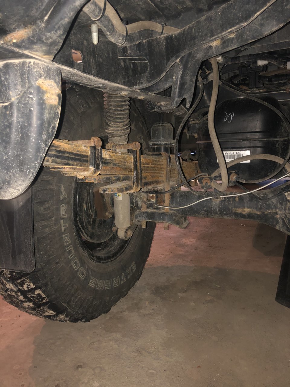

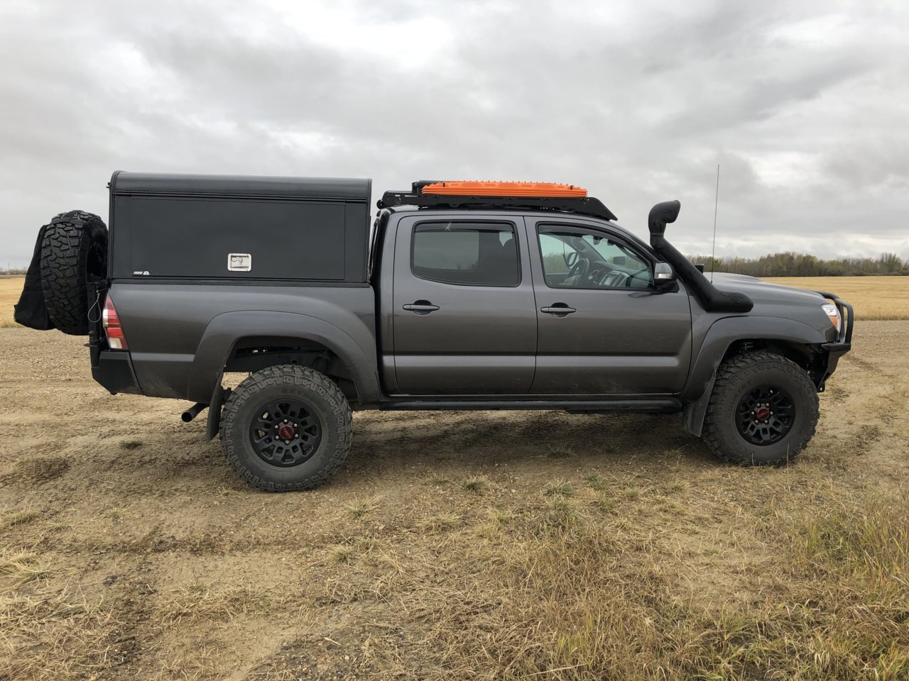

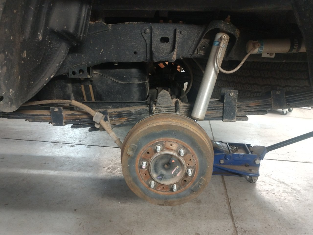

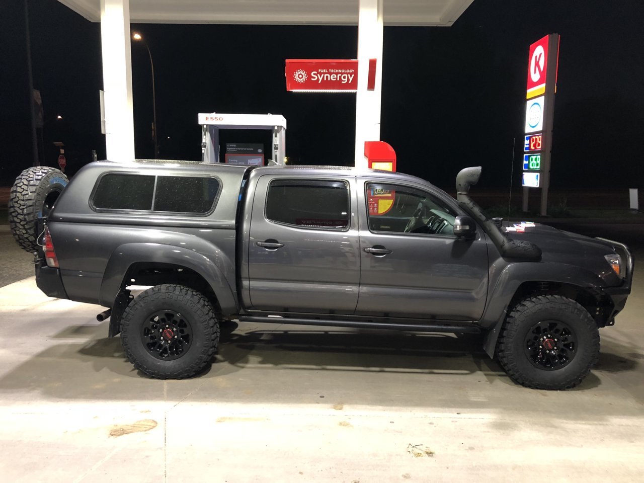

    Bumping this thread more for information than the OP since it's been a while and he's likely done his suspension.
    Also eta- tires are 255/85R16's for reference.
    Eta- added pictures of current springs with about half of the weight that should be in the bed.
    Dakar CS047R with D29XL aal was where I started and thought it was going to be okay. I think this setup equals the new OME heavy pack plus an extra aal.
    IMG_2125.jpg Truck unloaded with some good rake. The only extra weight in the back was the SnugTop Rebel cap and CBI rear bumper with dual swing outs (2 20L gas cans, Highlift jack and 85lb wheel/tire). Loaded up the rear still had some rake and was approx. 3" from the SuperBump bump stops. I generally did not have a lot of other weight in the back over the last 2-2.5years.
    IMG_1381.jpg Added a roof rack and ARE DCU cap. Truck was unloaded when the picture was taken but when it was all loaded for camping it was only 3/4" off the SuperBumps bump stops. A few times I was able to feel the frame on the bumpstops driving over some dips in the highway. Definitely negative arch in the leaf pack.
    I am adding a Drifta dual cab drawer system and ARB Zero fridge to the truck in a few months and am looking at switching to a leaf pack that can handle the weight better. Of course, once the drawers and fridge are installed I'll be weighing the truck to see what exactly I'm dealing with. Haveing said that, I'm very much leaning towards the Deaver Expo stage 3 leaf pack as I'd like to get back to minimum 3" off the bumpstops when loaded for camping.

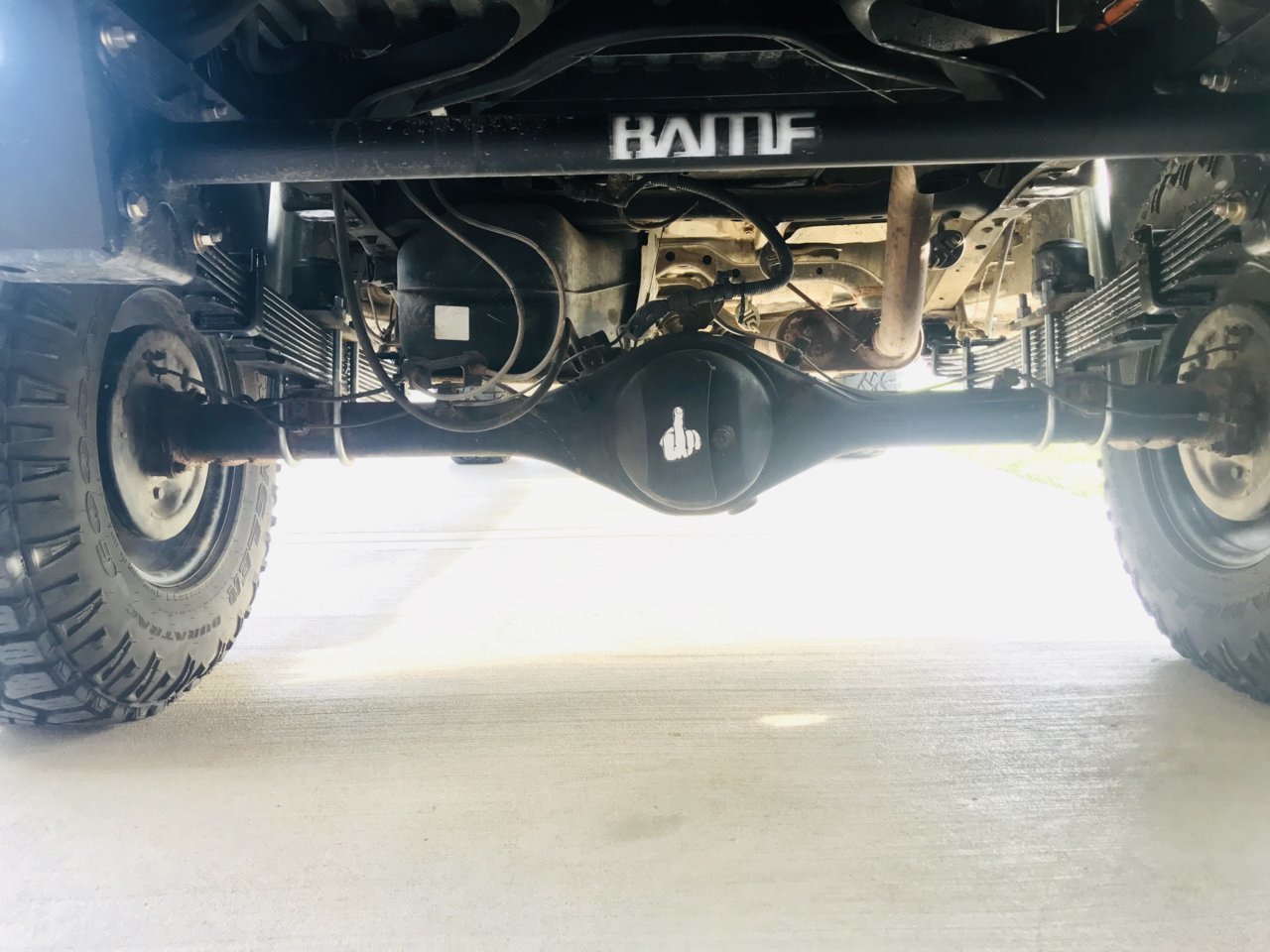

    0730AD2A-FAEE-428D-A66B-CE69EAC2BC69.jpg F80FE1FA-B8A6-43C6-A6C1-9C5F1D29FACD.jpg
    Not impressed with these both for load carrying and finish. You can see they’re flat or negative already.

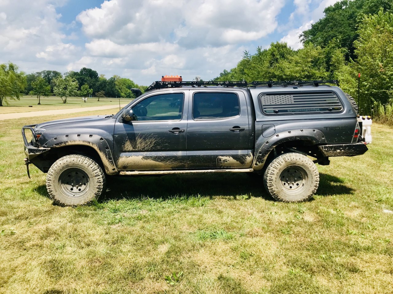

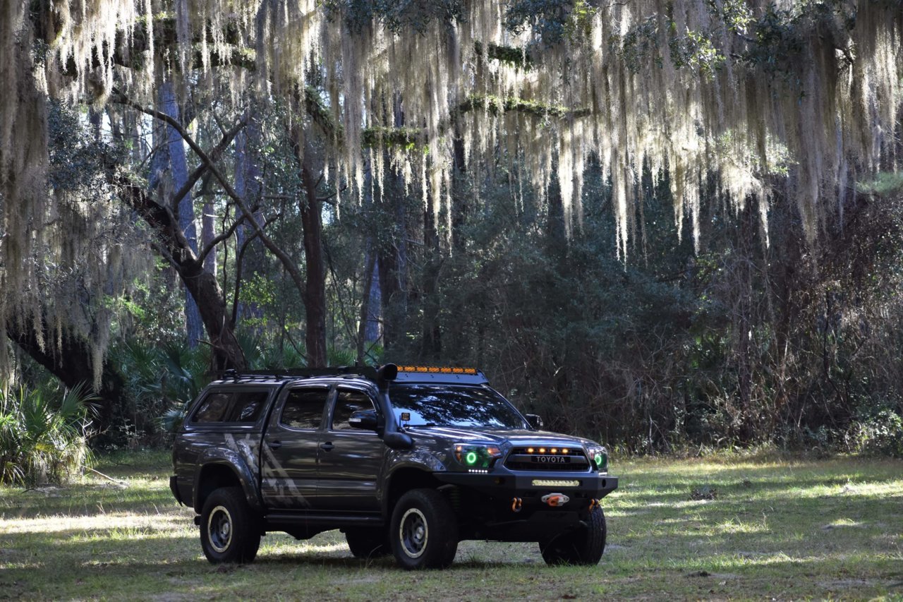

    I researched for months and finally went with Ironman 4x4. The Foam Cell Pro Stage 2 is phenomenal as well as one of the best values out there. I have:
    Aluminum front bumper with winch and lights
    Slee Sliders
    Steel rear bumper
    Camper shell
    Roof racks
    Gear storage in the shell
    The Ironman leafs haven't make a single noise yet. They make a Performance and a Constant Load pack. The Constant basically has 2 extra leafs but you you get it for the same price as the performance.
    I loved the shop I purchased them from so much I started working for them! I can get you a great deal on Ironman, Dobinson or really anything. Let me know if you need any help.
    https://explore-overland.com/shop/ols/products/ironman-4x4-constant-load-440-gvm-rear-leaf-springs-kit-suited-for-2005-toyota-tacomareceived_800656450485302.jpg

    Loaded or unload in the pics? I’m trying to figure out if the stage 3 U402’s will work with 3600-3800lbs on the rear.
  18. Apr 4, 2021 at 7:26 PM
    #38
    geekhouse23
    geekhouse23 The "Liftman" - @DrFunker
    Jul 14, 2013
    #108251
    15,711
    2GMGMDCSB4WDTRDFTMFW!! TL;DR
    mostly stock, grocery gettin' Prius
    Shell, bumper with swing out and a spare. Empty bed besides some tools.
    Sna[QUOTED] likes this.

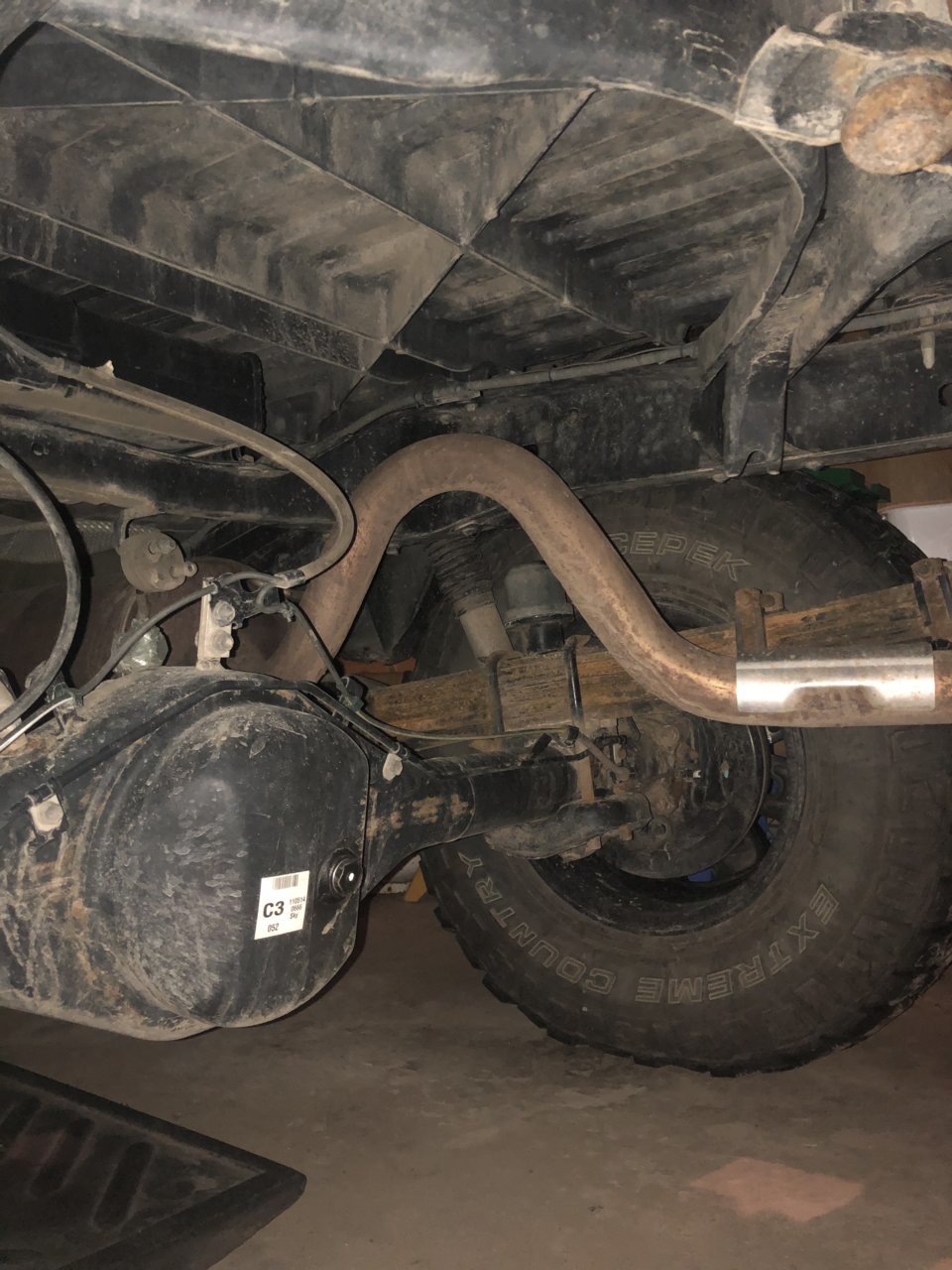

    UT_Runner
    UT_Runner Well-Known Member
    Nov 7, 2019
    #310149
    171
    Taylor
    N. Utah
    19 Auto, DCSB OR, 6112/5160, stage 2 deavers, 255/80/17, Snugtop, Cement
    This is my HD Dakar's with just a snug top rebel after 5k. Looking flat or worse to me already.
