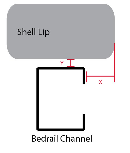

    I'm in the prototyping stage of a product that uses the factory tacoma bedrail system. I want to make sure the product will work with all trucks, including those with shells. For those of you with shells I am looking for a few measurements.
    I have a Snugtop Supersport Shell and both X and Y are roughly 1/4". If those with shells wouldn't mind taking 2 minutes to take those 2 measurements and post them along with the shell manufacturer it would be a great help. The more brands and models the better: ARE, LEER, VISION, etc....
    If the diagram is confusing im looking for the distance the shell overhangs the bedrail. Heres a picture of my snugtop shell lip and the bedrail.
    I no LEER for example has a much greater overhang then my snugtop. A little help would be amazing, I no a lot of you have shells.
    Thank you, please let me know if the diagram isn't clear enough.

    I have a Leer 100RCC
    X = 1/2" along the main rail , 1 1/8" where the mounting bolts are
    Y = 1/2"

    My snugtop rebel is the same as your super sport. Do you want to know the front too?? Its a bit different.

    Yes the front would be very helpful, my snugtop supersport lip nearest the cab (front) doesn't hang over.

    My Leer 100RCC overhangs at the front of bed , I'll measure that for you in a sec

    It doesn't protrude into the bed hardly at all, like <1/16". But it sits above the rail by about a half inch.
    Y= 1/2"
    X=<1/16"

    Here is the front overhang on my Leer 100RCC , it comes down to the top of the bed rail and overhangs it by approx 1/2"

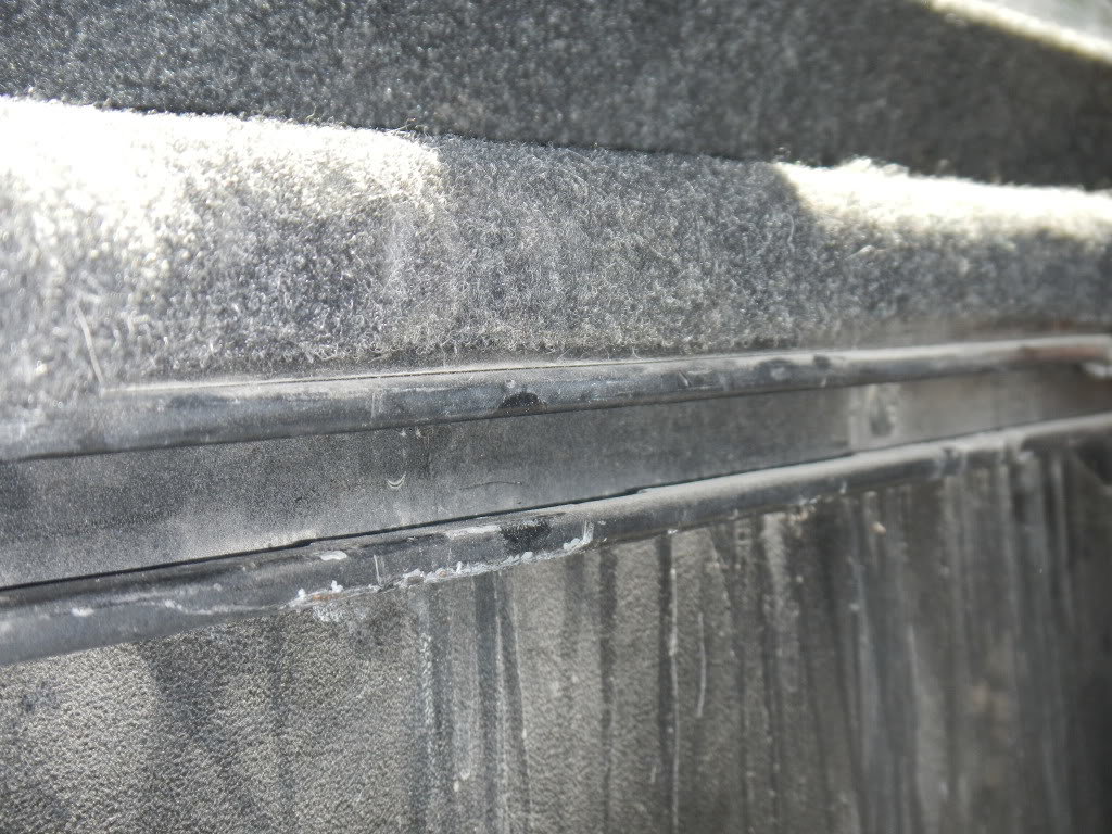

    My 2012 Snugtop Rebel uses the rail system for mounting. The shell has bulges in 3 places on each side and a bolt/clip goes through the shell into the rail system. I don't have carpet headliner so you can see it well.
