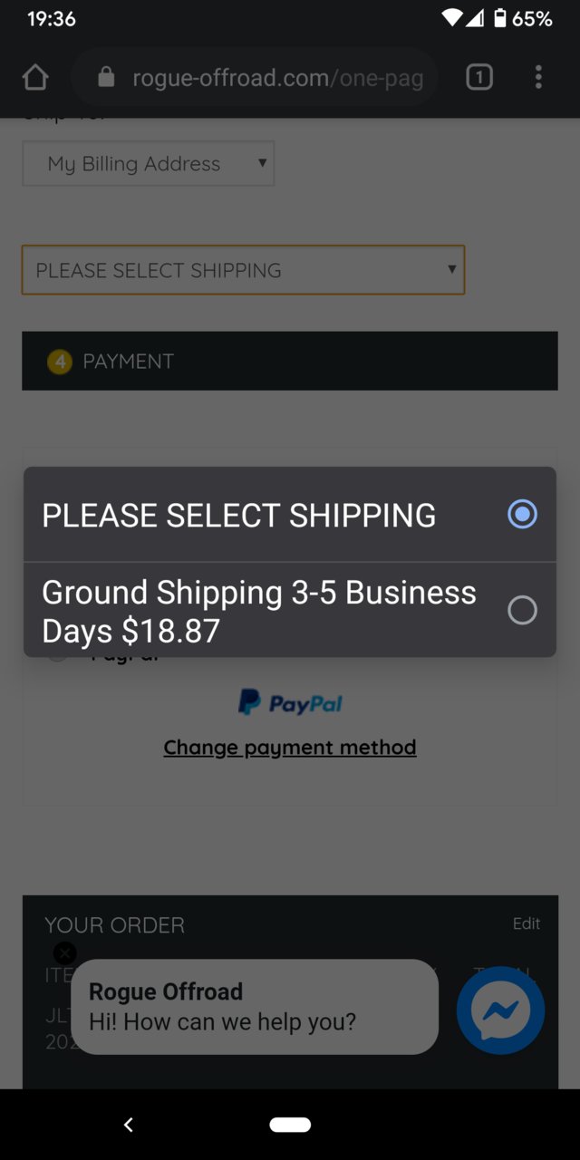

    I've had the JLT can bookmarked forever, went to go buy it from Rogue Off-road before I forget again and while checking out I saw the price for shipping and immediately noped the fuck out, I'll find a different site. $20 for shipping on an oil catch can, you've gotta be fucking high

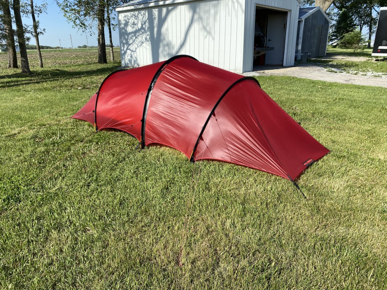

    This is my new home when I’m not using the Tundra w/ habitat (Tacoma or super tenere)
    hilleberg anjan 2 gt

    I’ve been looking for the last few years for a tent that had everything I wanted and this was definitely it. Set it up in 20+ mph wind gusts and it’s solid and super easy to set up.
    it packs down super small which will be great for the moto and it is still real light and super roomy

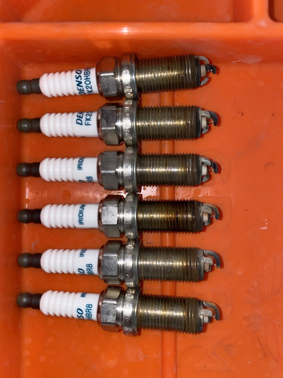

    Updated truck to 04b14 and flashed 2.0 yesterday.
    New spark plugs today

    Is that your 1st plug replacement?
    How did it go? Looks tough to get to a couple of them
  19. Jun 20, 2020 at 3:16 PM
    #119
    ajmogen
    ajmogen Well-Known Member
    Apr 13, 2016
    #184199
    1,874
    Aaron
    Wisconsin
    OR MT TACO T4R YARIS MT Corolla Hatchback MT
    Also, what's your thoughts on 04b14?
    Worthwhile?
    Did you have to flash new tune afterwards?
  20. Jun 20, 2020 at 3:19 PM
    #120
    Shellshock
    Shellshock [OP] King Shit of Turd Island
    Nov 21, 2015
    #170338
    23,390
    Iowa
    First time @ 103k
    it’s actually not too bad. The passenger side is cake. On the driver side there is 2 supports I removed the top bolt and loosened the bottom one.
    the worst one is the front driver side as there’s electrical and fuel lines you have to fight with that cover the coil pack.
    a 10” and 6” extension are your bff

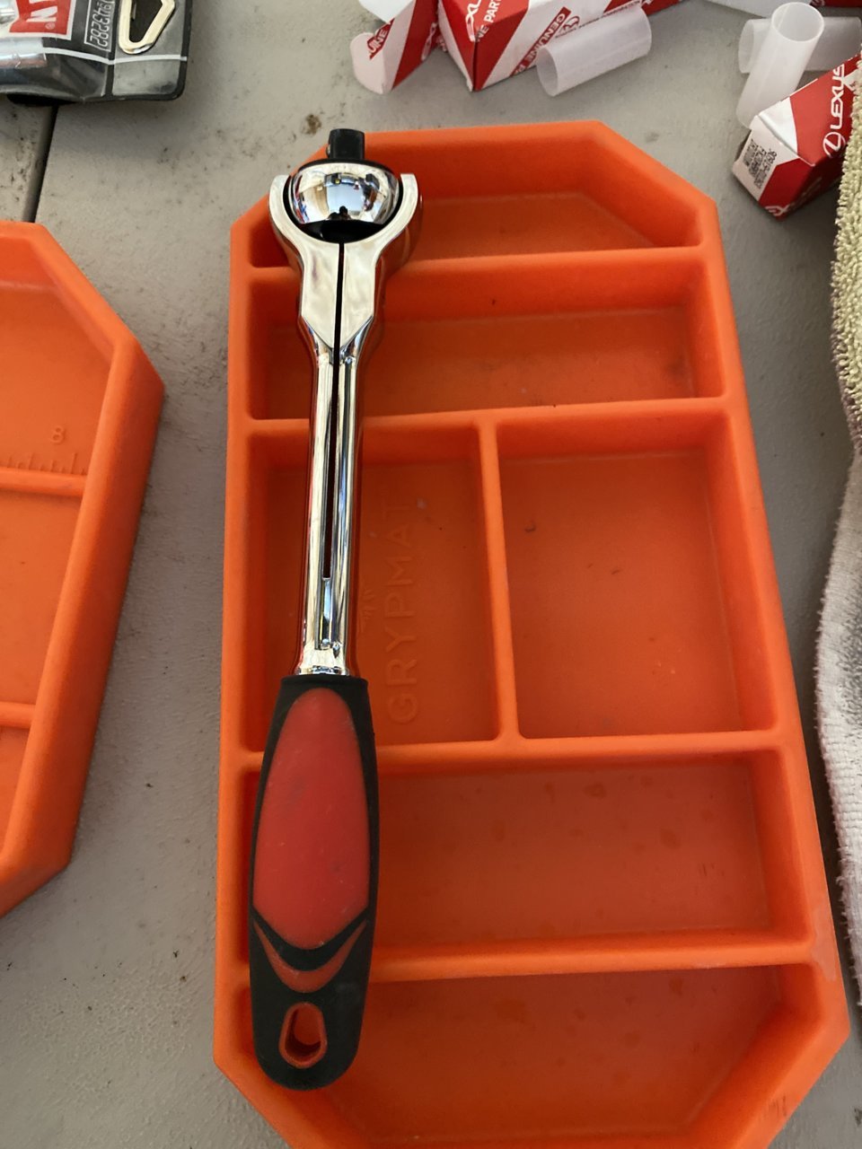

    Also this swivel head helps. It may be one of my new favorite tools
