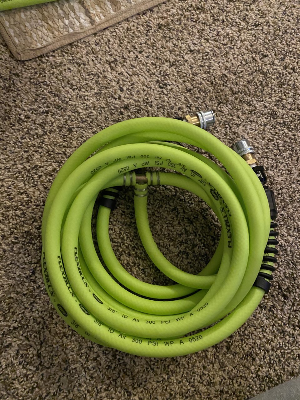

    This does wind up a little nicer

    Put the reg on before the inflator and add a ziptie to hold the inflator open. Let it slide so that you can disengage the inflator.
    Yes, it does. Before my newer storage box, I could get everything in the Viair bag.

    Version 1 anyone can do. It’s super simple. Basically just wrap with a couple layers of teflon tape and screw them together.

    It might sound stupid, but that little wire clamp tool almost gets me excited enough to pull off good clamps just to swap.
    Beyond that, I use this inflator for easy pressure checks on all the vehicles. Saves time with those sweet chucks.
    It's a new, functional toy. The first time you air down on the trail, well . . .

    These little wire clamps are holding back about 200psi. There's really nothing that I would consider critical.

    If you don't like the wire clamps, grab the oetiker tool.

    It is definitely something that you wouldn't want to be using for units that you would ship out unless you have all day to be going at it.
    Still, they're solid even with baling wire.

    At first I thought those were wire cutters based on the side profile. Pretty neat things. Between the CLT03 clamp tool and the Oetiker system, which would you say is a better investment/more likely to see use around the house/taco/life?

    I borrowed oetiker clamps in the past, but bought the wire clamp tool. I love the thing and it works on anything. You never need the right size of anything.
    That's my take.
    The only reason that I would jump on an oetiker is for speed.
