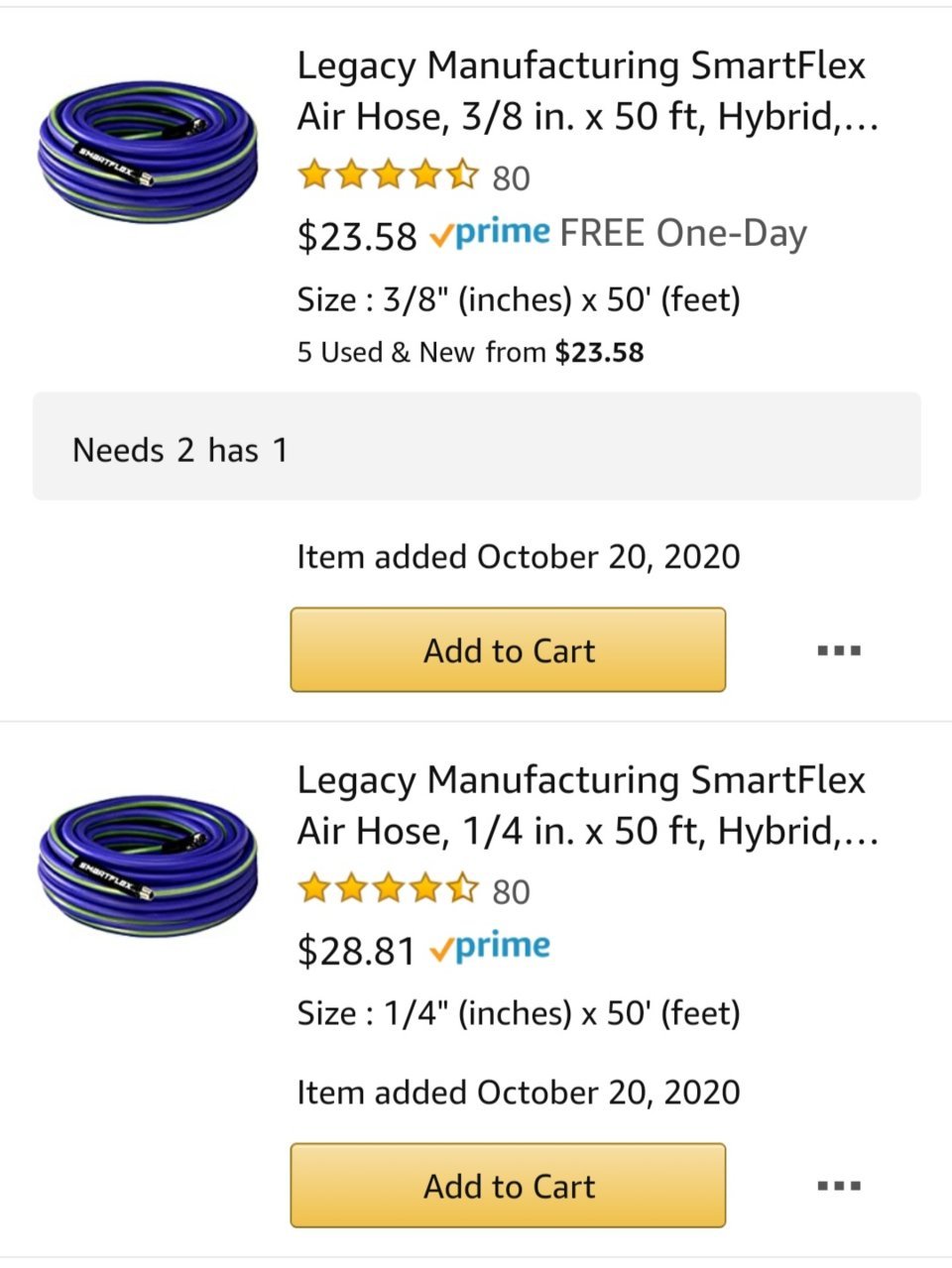

    I've given up on the premade 6' sections ever arriving here. Should I get 1/4" or 3/8" ID for the donor hose? I like the idea that the 1/4" would be more compact. Anything else to consider?

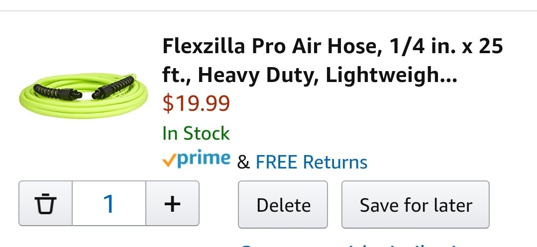

    I'm going with this one for flexibility and being more compact. Also, it looks like there are more 1/4” barbed fittings at my favorite local hardware store.

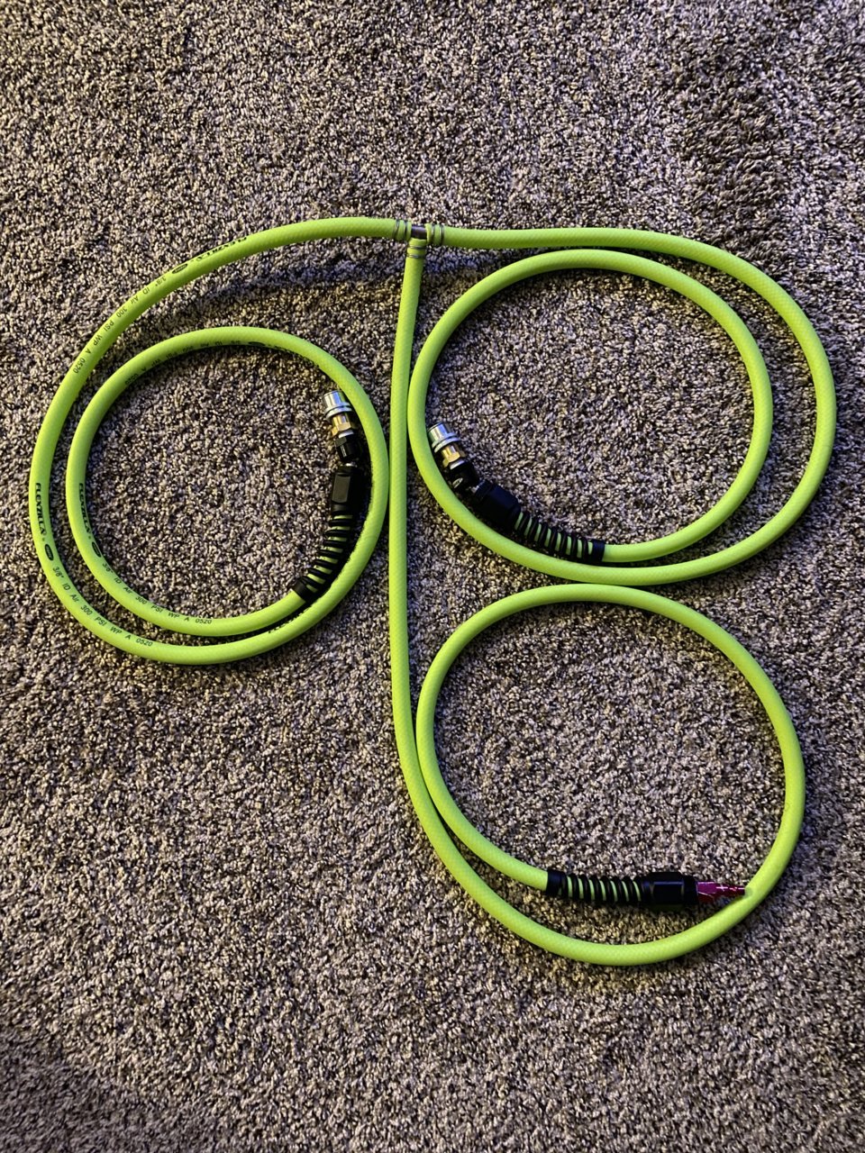

    I still have 32 feet of hose left so I’m going to order parts and make a couple more of these for anyone that wants one.
    This is built using the best of the best components I’ve been using personally for 2+ years.
    Flexzilla hoses - stay flexible well below 0 degrees. I’ve tested multiple times. They also dont kink or tangle or have memory. I grab the bundle by the T and let it fall to the ground. Instantly ready to go.
    Flexzilla pro connectors - Field reparable. If a hose is damaged, cut off a section, remove connector, install on new section of hose
    Haltec chucks - grip the valve stem on 3 sides. Very secure and dont cause damage to the valve stem.
    $100 shipped
    If there’s a lot of interest in prebuilt kits, I can look further into bulk sourcing components.
    Adding the regulator is around $40. I want to do some more testing with it first though.
    This entire setup would be <$150, which is $30-50 less than other things on the market, all while using better quality components and is field reparable in the unlikely event something does break.

    Definitely 1/4in. We don't have the flow rate for 3/8. Also, 1/4in is more common if you need something.
