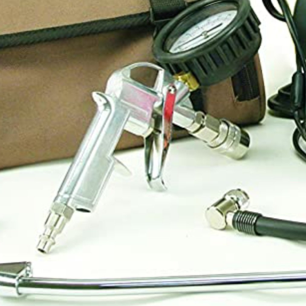

    The RV version has an air qd on the filler thingy. Looks like an easy mod to make the 400p auto have that also.

    I changed mine to be the other connector. It’s a standard 1/4 npt air fitting

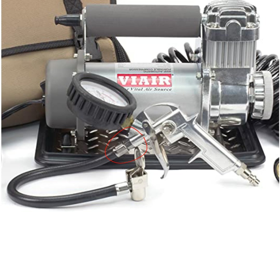

    Mine ended up being 1/8 fpt with green thread locker (the circled part). Easy enough to add an adapter.

    Oh I thought you were talking about the outpump connector on the compressor..my bad.

    No worries. Why do they put the wrong connector on the compressor anyway?

    Probably so noobs can connect either end of the hose to the compressor or attachment. Seems silly to me
