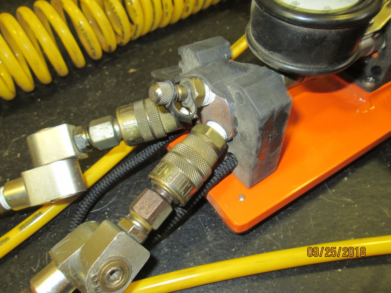

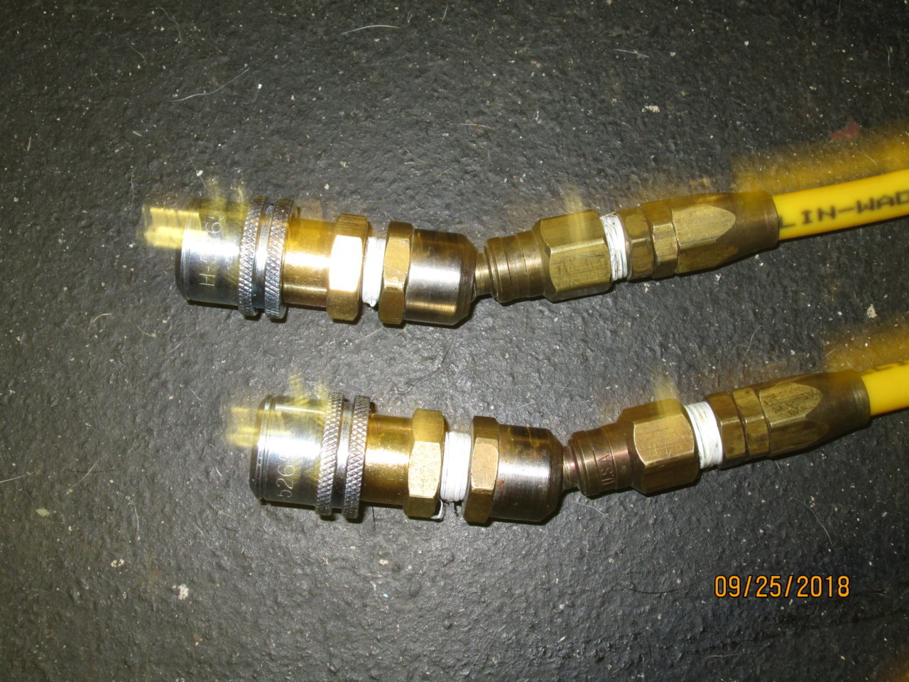

    Crow Horse
    Crow Horse Well-Known Member
    Jul 9, 2016
    #191597
    1,112
    Central NY
    2012 DCSB TRDOR
    Inflator Deflator 003.jpg Inflator Deflator 011.jpg Inflator Deflator 009.jpg Inflator Deflator 016.jpg
    My apologies for the less than perfect pics. This is a unit that I made and have modified over the last 30 years. Works very well but is a bit cumbersome. I generally use it when using my CO2 tank......
