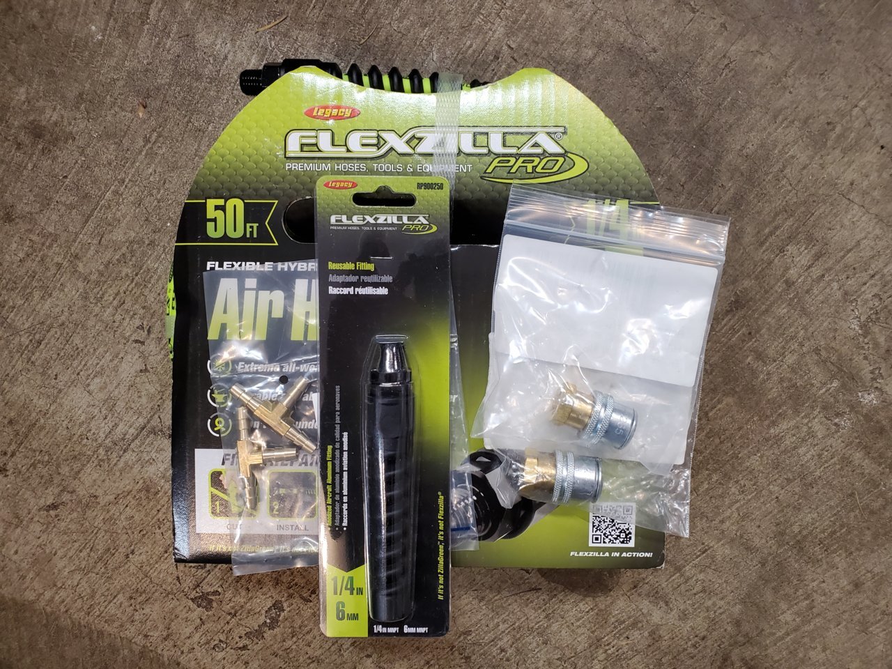

    Well here I go again. This one will be for the garage. I'm not sure what I'll do with the extra hose, but it was only a little more than the 25'.

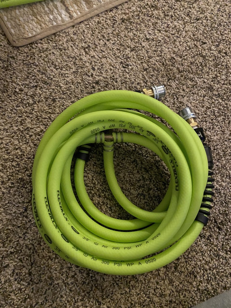

    I’ve got the same problem. I still have 35’ coiled up in my living room lol

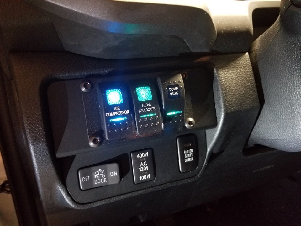

    Upped my laziness one more step. Installed a dump valve on my compressor. Now I can direct connect compressor to tires, monitor filling, stop compressor, and dump pressure to desired set point all from the driver's seat.

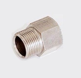

    An update to my @Shellshock Deflator / Inflator (SDI??). Version 1.3 maybe?
    Just minor changes along the way. This time was to get a female coupler on the 300P with automagic mod:
    If folks go this route, you should check first. The Viair folks said that the thread was 1/4 NPT and was changed to M14x1.0. This was the adapter that I got. Not many of these adapters out there either as male / male or male / female. I already had a coupler with male NPT.

    Nice update
    I wonder why they use that connector in the first place. With the non-automatic it makes since because someone could turn it on when not connected and it would continue to build pressure in the unit. For the Auto ones though it shouldn't matter. I guess it keeps parts common through the product line, like the coiled hoses with dual female ends.

    I think it is the pressure thing. Their hose allows bypass when not connected to a valve stem. The deflate feature on their chuck was nice, but the chuck itself was horrible to use. If I didn't have an SDI kit already, I would have been making one.

    I wonder if thats only certain compressors or newer ones or something. The 400p auto i had was 1/4npt... or it was close enough i didnt know the diff..

    I think so. I was told that it was NPT and then sent a pic later. They replied with 'it looks like it was changed' and thanked me for noting it.
