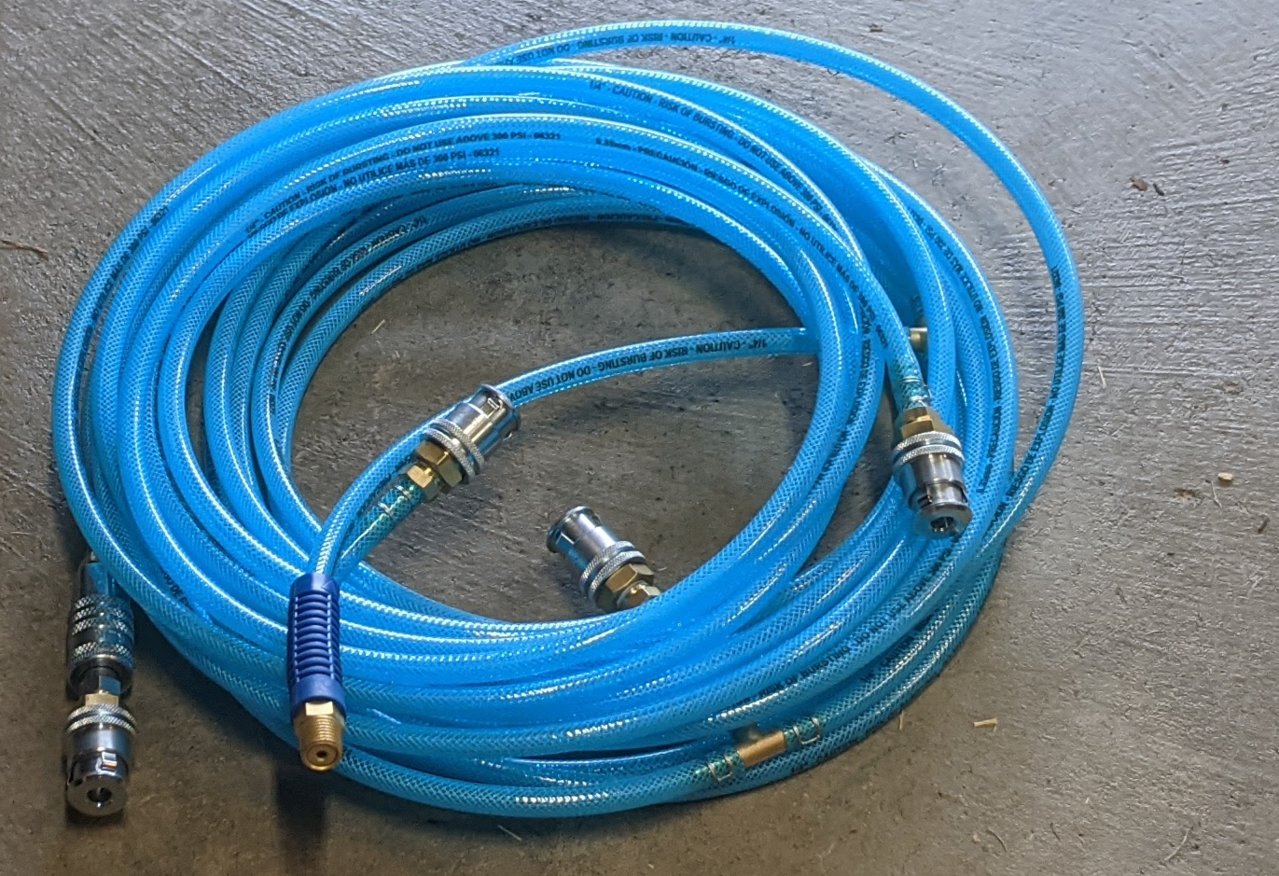

    I kinda sort a did that for one that I made for a friend:
    The short Ts that you can see are for the front tires. They have longer legs that then go to the rears. To split it, just toss in fittings and QD male / female near the main T. Female toward the T. In the pic, that main T is hidden on the top, right of the pic.
    I always put one of the air chucks (the leftmost in the pic) on a QD to be used by itself for typical air checks around the house.
    With your own clamp tool (worms, oetiker, or wire clamps), the sky is the limit. I would recommend rubber or polyurethane line over PVC. Though they are all easy to work with.
    I enjoy the two tire ones the most, but four tire ones are great also. Just take a bit more planning to make.
