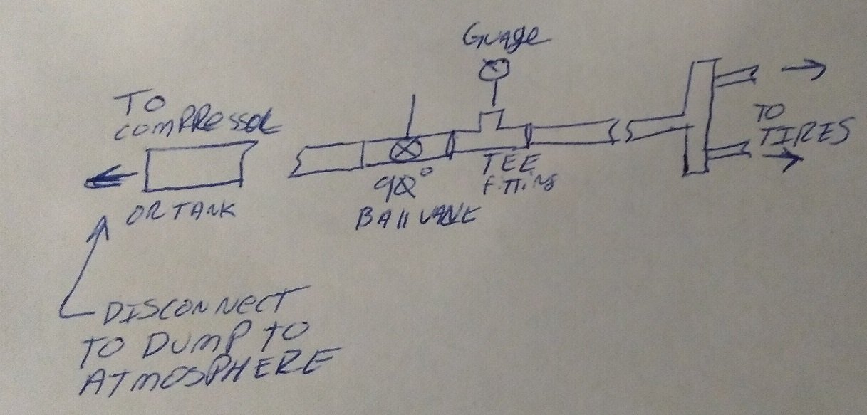

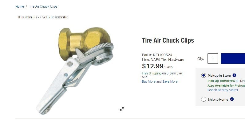

    I worked up a quick sketch. You would need to tailor it to meet you set up. But, it is based on the hose that connects to your compressor or tank, having the male fitting, and latching clips for connections at the wheels. (The one I show here is a bit expensive, but it was the first good picture I found).
    Hook up the direct connects at each tire, to the valve stems first. Then, when you disconnect from the tank, it would start dumping your tire pressure to atmosphere.
    You then need a way to monitor and control the pressure release. I envision and 90 degree in-line ball valve and a tee fitting. At the Tee fitting would be either a permanently attached gauge, or a chuck to attach a gauge.
    If you use an air chuck for the gauge, you could store it separately when not in use. With this set up, you could monitor and control the tire pressures from one spot. It would work with 1,2 or 4 tire hook up. My sketch just shows 2.
