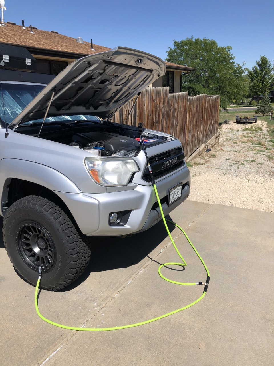

    Thanks for all the inspiration & guidance on this thread. Time to put one together!
  18. Aug 29, 2022 at 2:08 PM
    #558
    Wackyhacky
    Wackyhacky A Well Known Troublemaker
    Jun 4, 2014
    #131275
    655
    Keith
    Berthoud, CO
    2013 Tacoma DCSB
    Well, that was simple enough! Freaking works like a charm. I might have to turn it into a 4 tire rig eventually, but this will do me.

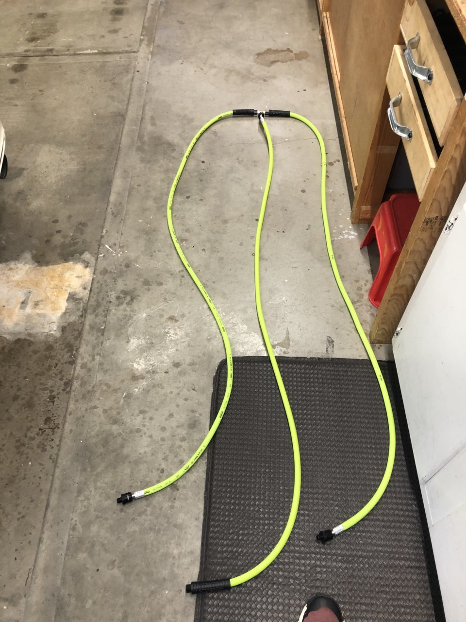

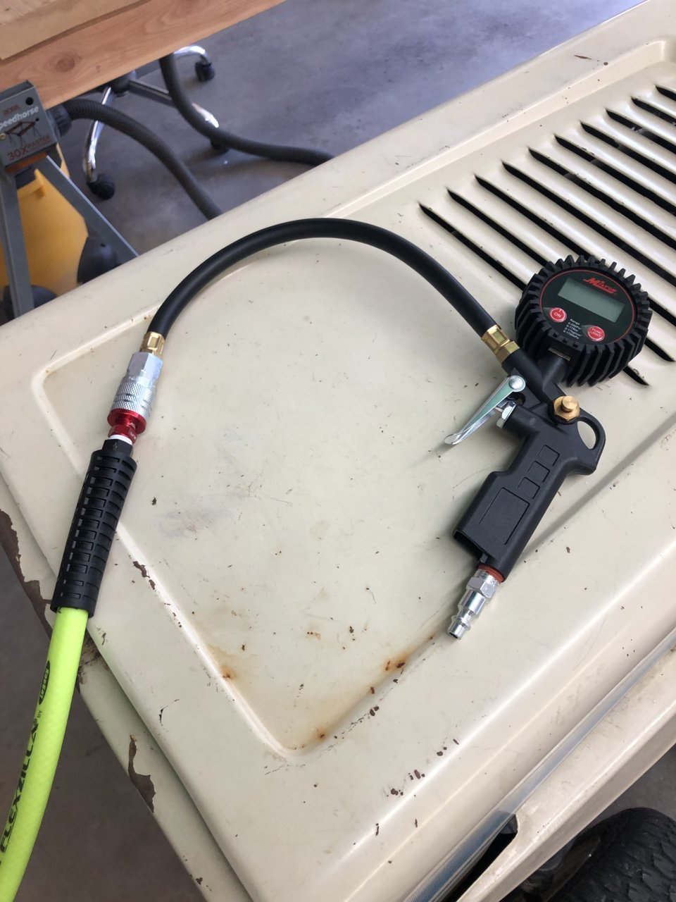

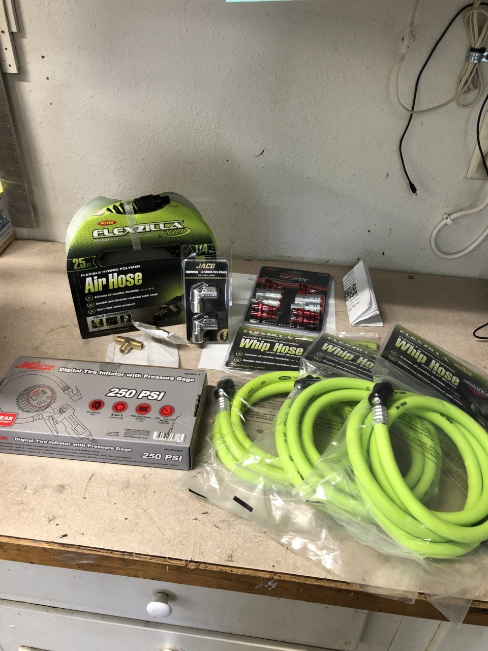

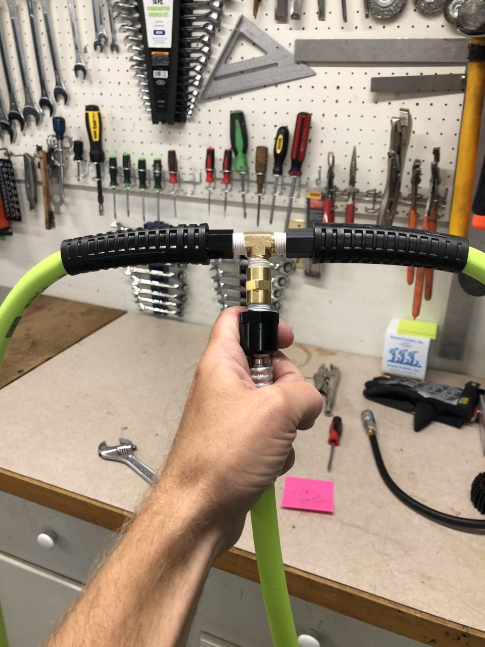

    4 tire version
    hose with the flexzilla pro ends - used about 70 feet (2x25 & 2x10). you could probably cut down to 50 feet (2x17 & 2x8) if you wanted to
    6 more pro ends
    (1) 7 port manifold
    used a handful of zip ties to keep each side together.
    0EC35D86-A950-406F-B65B-F030FA699B4B.jpg 47498C65-808A-4D08-A5A2-282CF5FE5A58.jpg 2D2231CE-1043-4CEF-B3C6-B01A06E33058.jpg
