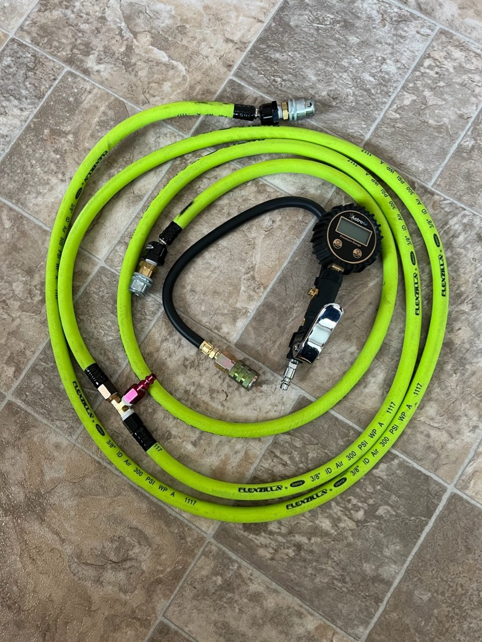

    Is there a cheaper version of the Flexzilla inflator gauge with the quick release? I can't find anything and would rather not shell out almost $90 on an air gauge.
    CygnusX191 likes this.
  16. Jan 31, 2023 at 6:13 AM
    #576
    Shellshock
    Shellshock [OP] King Shit of Turd Island
    Nov 21, 2015
    #170338
    23,157
    Iowa
    This is the one @tonered has. I used it for the 4 tire one and my dad has one
    AstroAI Digital Tire Inflator... https://www.amazon.com/dp/B07528LFCT?ref=ppx_pop_mob_ap_share
