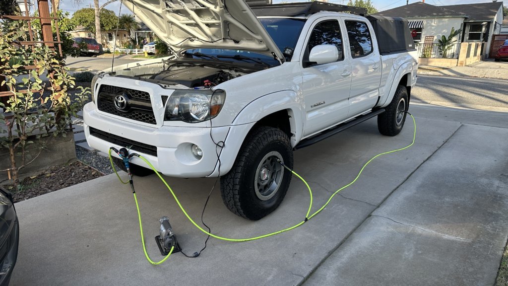

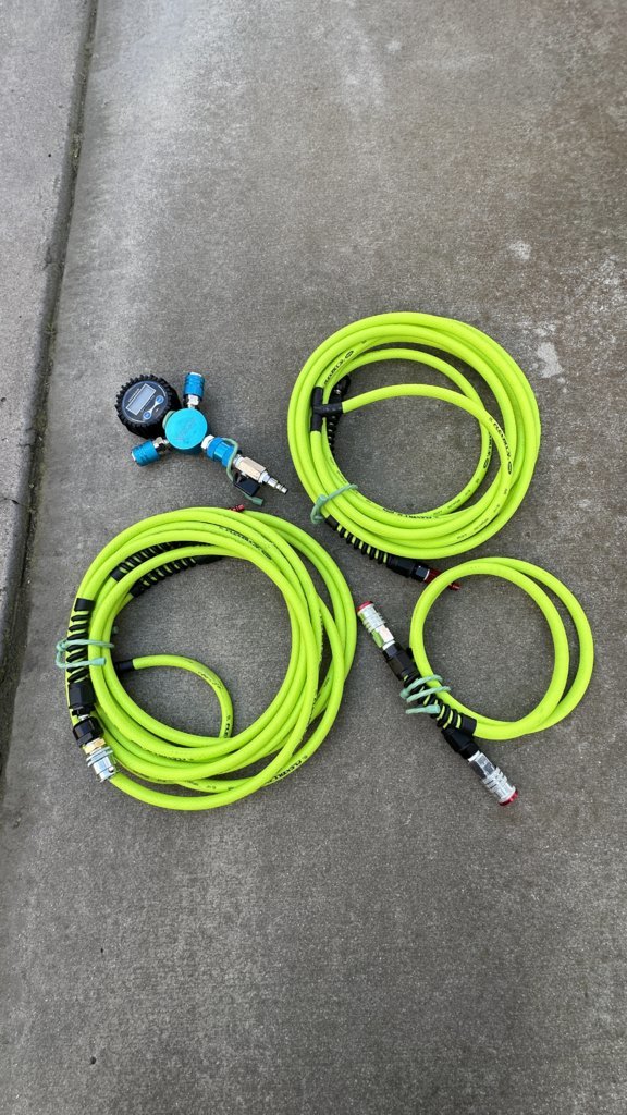

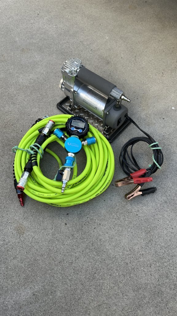

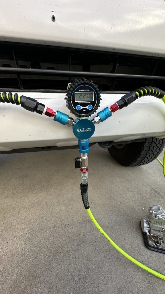

    Big thanks to @Shellshock and everyone else in this thead! I just put together a kit for myself based on a lot of the info here. I was going to essentially copy Shellshocks Version 3 but setup for 4 tires rather than 2. But when the inflator/gauge I ordered ended up not having standard fittings and I couldn't customize the way I'd planned I decided to go a different route and use one of the 4 way manifolds like you see on many other kits out there. Found a cheap one online so we'll see if it works long term or not.
    The kit should be pretty flexible, specifically, I can have it setup like the pics below for a 4 tire setup or I could use the hoses for one side and simply run them to two tires rather than 4 if I only needed. I bought 100' of hose but ended up using <50' so have tons leftover for other projects or a whole other kit. The Flexzilla hose ends are a little pricey but they really make for a tidy result and the fact that I can reuse them is a HUGE benefit. I plan to run on board air eventually so I can easily modify this kit to better accommodate a different setup later.
    With this kit I can deflate at a rate of ~8psi/min (tested from 23 down to 15 psi) and inflate at a rate of ~2.5psi/min (tested from 15 up to 36psi). I'll need to keep timing this and see how things like elevation play a role. My thought here is that I can hook up the system and set it to deflate or inflate, set a timer and then let it run without having to pay attention to the gauge. When the timer goes off I can then dial in a more precise pressure if needed. This will be nice to stop and have a beer instead of manually inflating/deflating each tire.
    Now I just need to find a bag or case for all of this. My Viair bag that came with my compressor isn't a good shape/size for this new setup. LMK if anyone has any suggestions.

    Nice work! You might want to consider using Andersen connectors and you can do away with the clamps.

    Not a bad idea. But still getting the compresssor mounted would be the ultimate goal.
