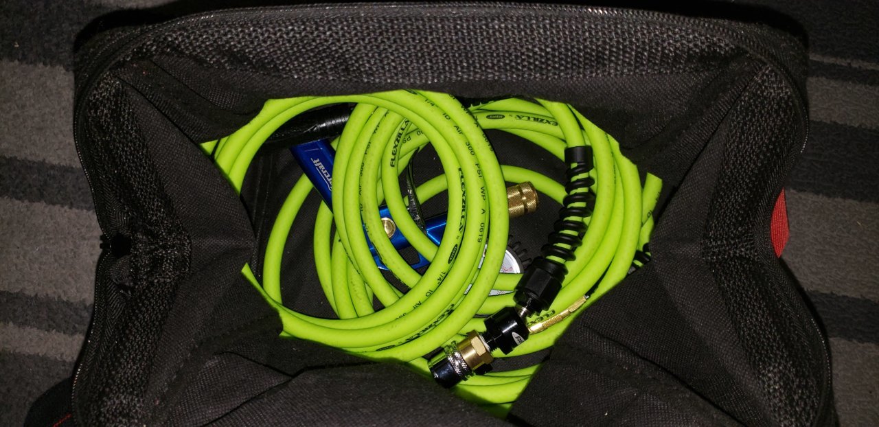

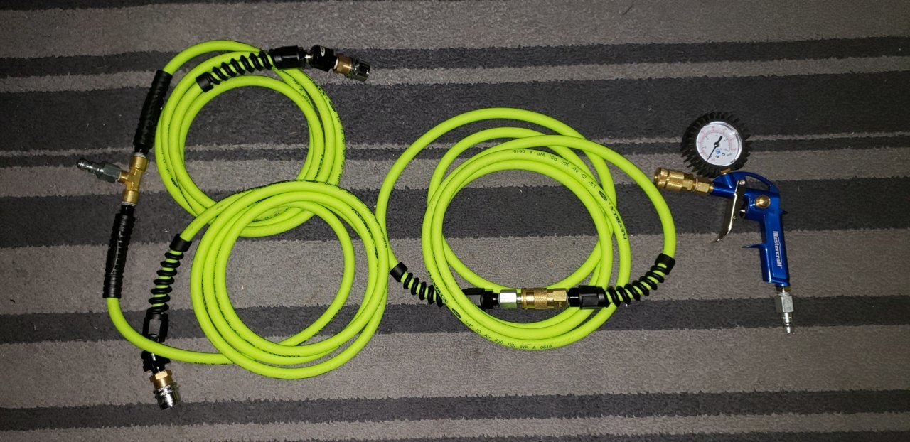

    Here is my set up. I put a disconnect on the inflator to make it easier for packaging and for possible future changes. Off the tee, I have straight fittings. I might change those out to swivels in the future. I also opted for ¼" air line vs. ⅜" line because the valve stem is only ⅛" so I didn't feel it would make a huge difference overall. I also have a 60 psi gauge that I might install but if I use the inflator and the inlet pressure goes over that, it will destroy the gauge. I might use a regulator to inflate for accuracy and convenience.
