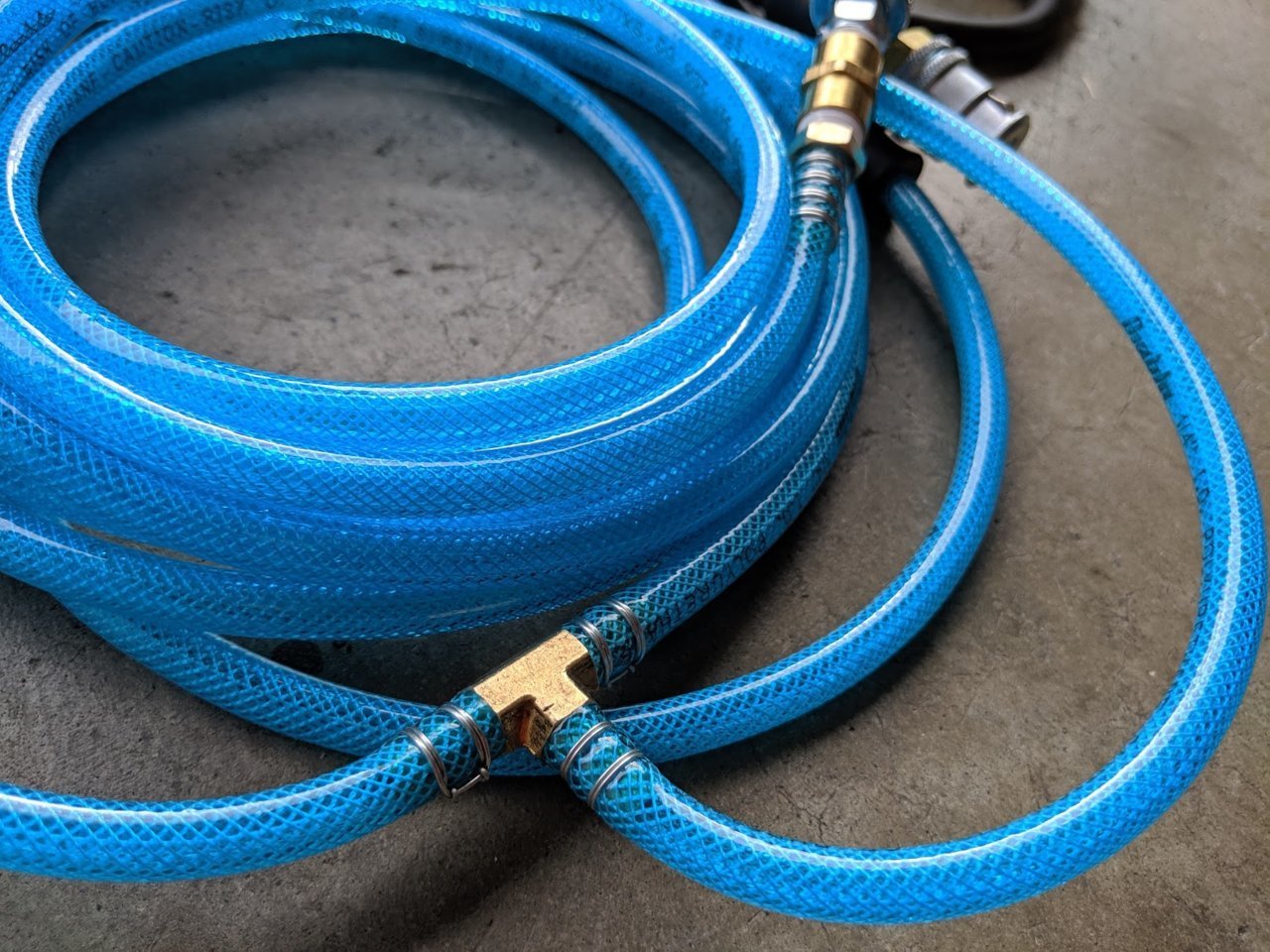

    I used to use a lighter or torch to heat things up, but a cheap heat gun works much better. It is surprising how little heat is really needed to soften some stuff, like thread locker.
    This guys is a champ, esp when it is usually less than $10:

    It takes much longer than a worm drive or oetiker clamp, but it is fun and relaxing. Like whittling wood. :rofl:
    This is the tool:
    https://www.wirecare.com/category/t...4-3-4-stainless-steel-aluminum-tool-w-wingnut
    If you have a lathe, you could whip one out at home pretty easily. There are no critical dimensions on it except for being able to swage the nose into the body. The only thing that you can't see there is the lateral cut in the tip for the wire to rest in.
    I can post up the usage instructions if you want?
    I bet it would work well. Mine has accidentally held all that the Viair can chooch. 200psi or so?
