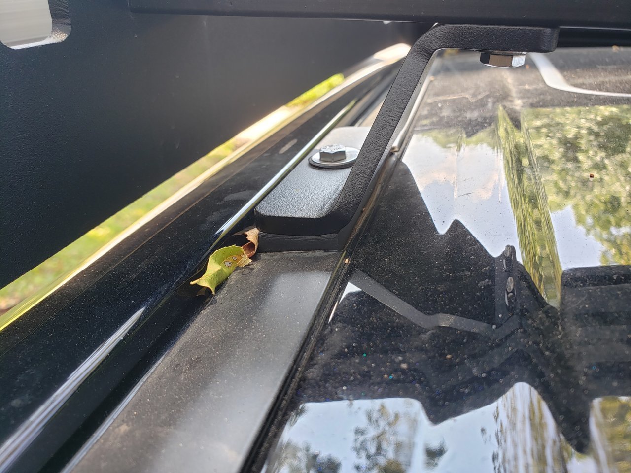

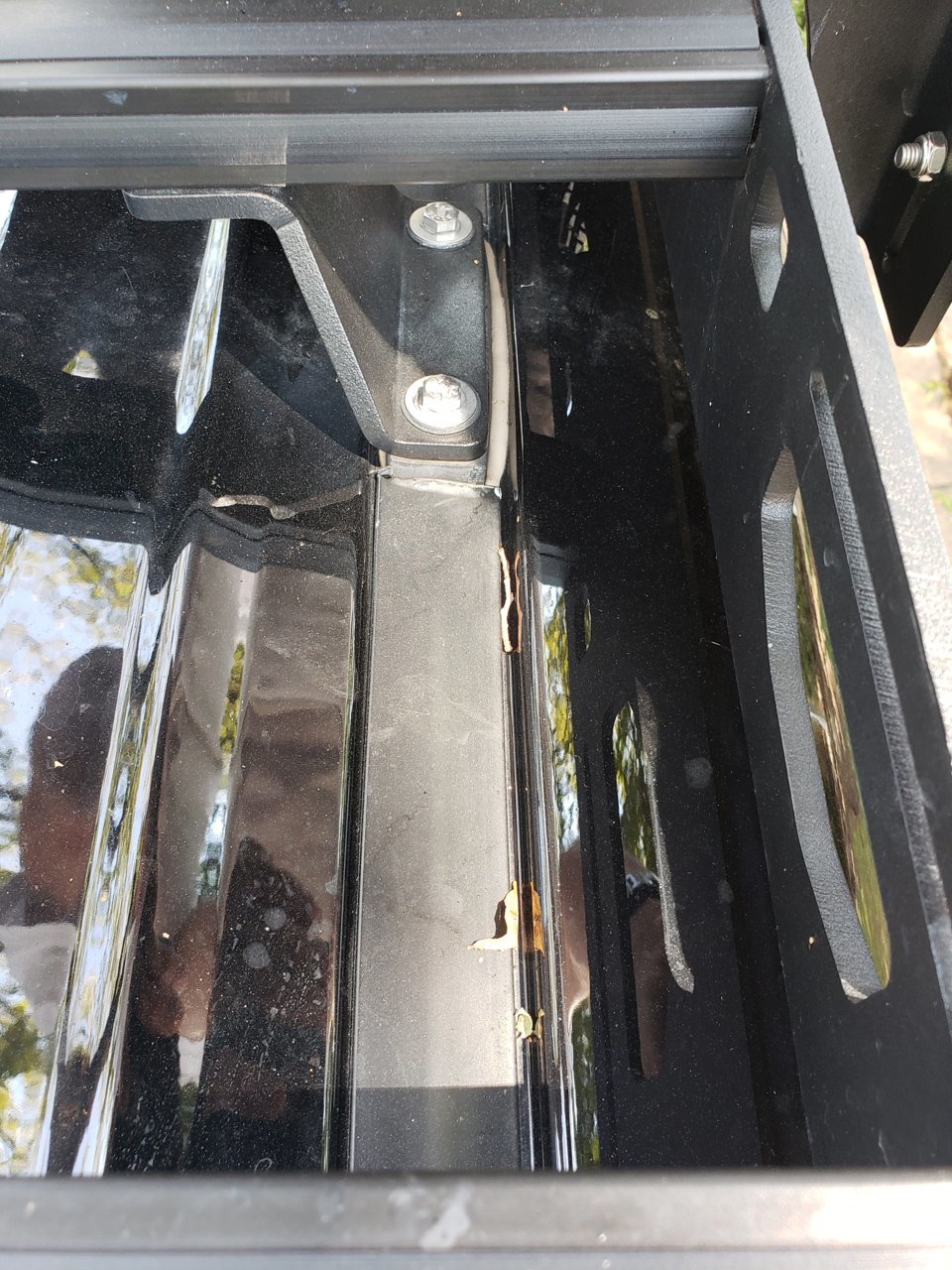

    The mounting is super easy on the sherpa. The kit has rubber pads that go under the rack that seal to the roof. I use sikaflex anyway and spoke to the sherpa owner. He said it wouldn't hurt to use silicone or sika but they designed the mounts so it wasn't needed. All holes are predrilled and threaded in the roof. The hardest part (which wasn't hard at all) was really adjusting the front wind plate to eliminate noise and cutting the weather stripping to fit after the mount. I used tin snips and used the sika to adhere the weather straps back down and it was easy. Here is a pic of the mount. I like sherpa because it is made in the USA and it is super thick and strong. I hang my hammocks from it. Lol.

    Thank you! Your pictures are really helpful ! They give me a lot to think about.
    What you show makes a lot of sense -- the instructions don't show this at all. Frankly, I was going to scratch them off my short list because a guy who is all thumbs like me needs all of the instructions that he can get. But your pictures actually show a nice advantage. With this rack you can just cut the roof stripping and put it back because the rubber pads take care of the area where the bolts go. This is actually cleaner than having to take the weather stripping off, mark holes and then punch them and put the stripping back.

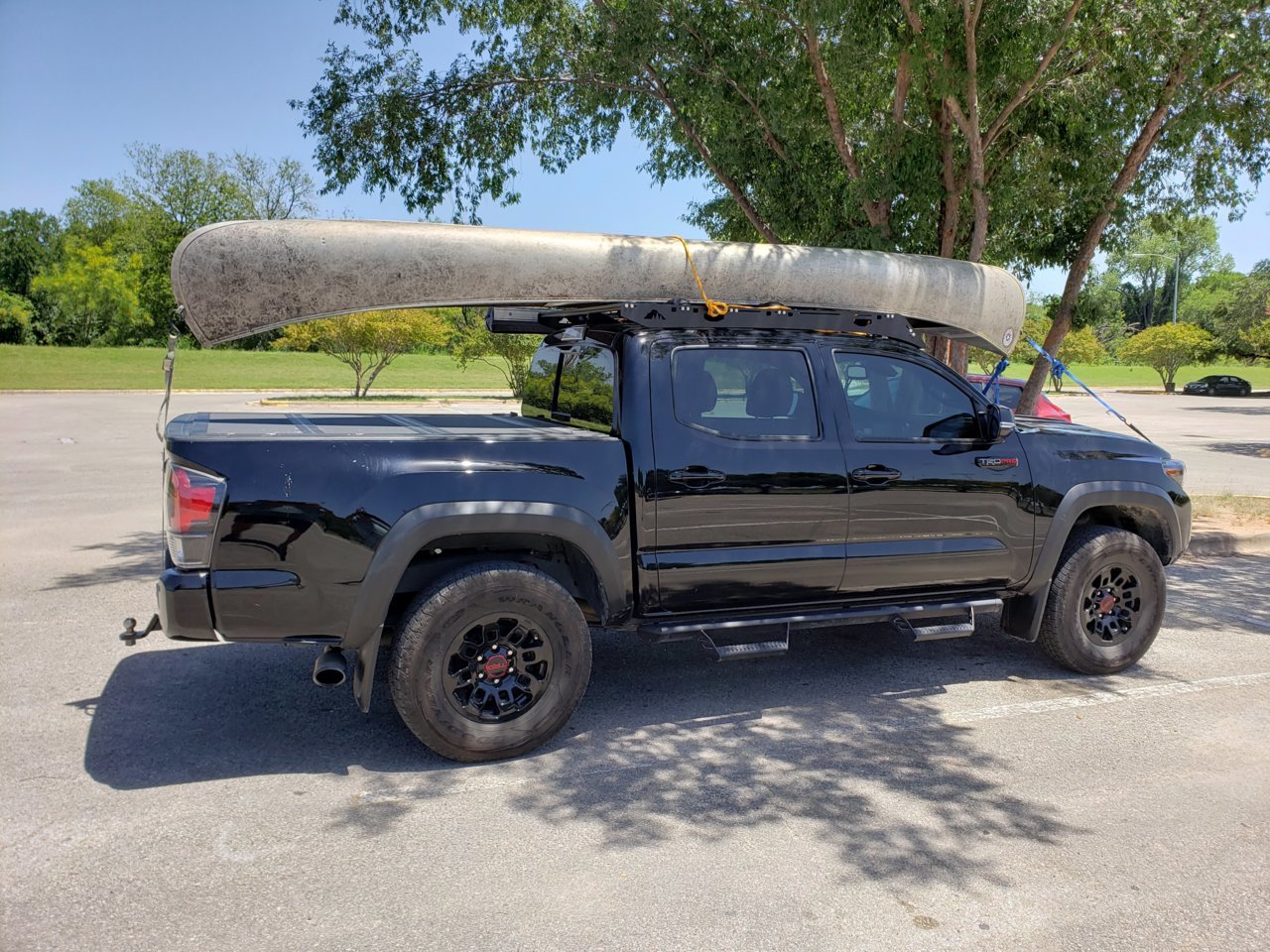

    No problem. Happy to help. Here's another pic with a canoe on top of dakine velcro pads I bought on Amazon. I also put 80/20 Inc, 2820, 10 Series, Black Economy T-Slot Covers in the extruded aluminum channels at the request of another poster and that made the rack silent along with lowering the front plate. The dakine pad gives it a cool look. Amazon also sells the front straps that mount under the hood (seattle sports sherpak hood loops). I would highly recommend all 3 and you can find those on Amazon.

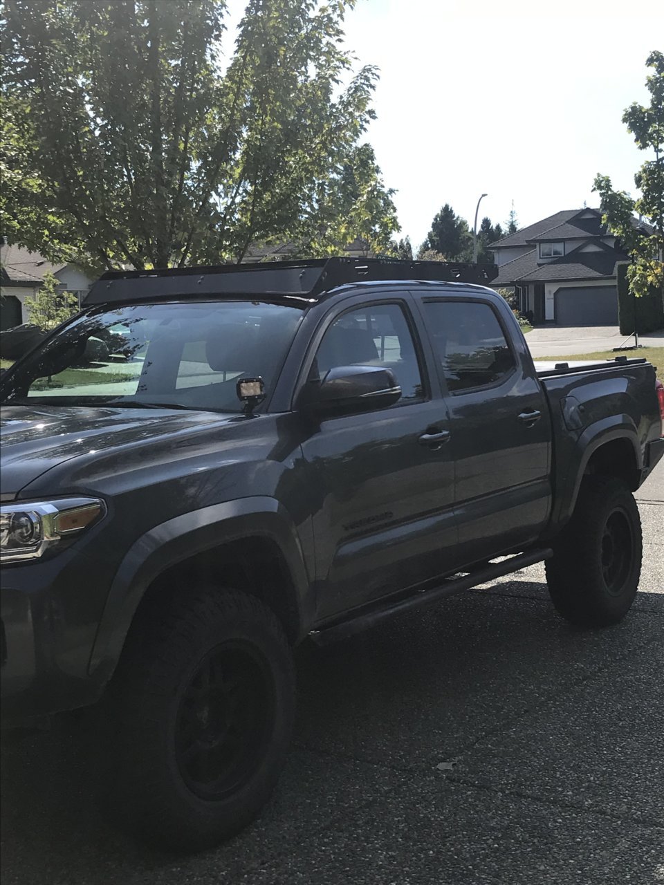

    I guess I can post in this thread now, bought used 700 Cdn pesos, or 530USD. Nice fit and finish on it. This ones been abused for a year and a bit. As second owner looks like still as good as the day it was cut.

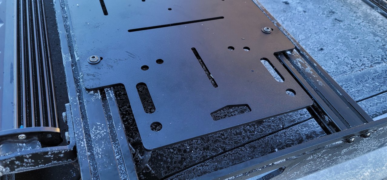

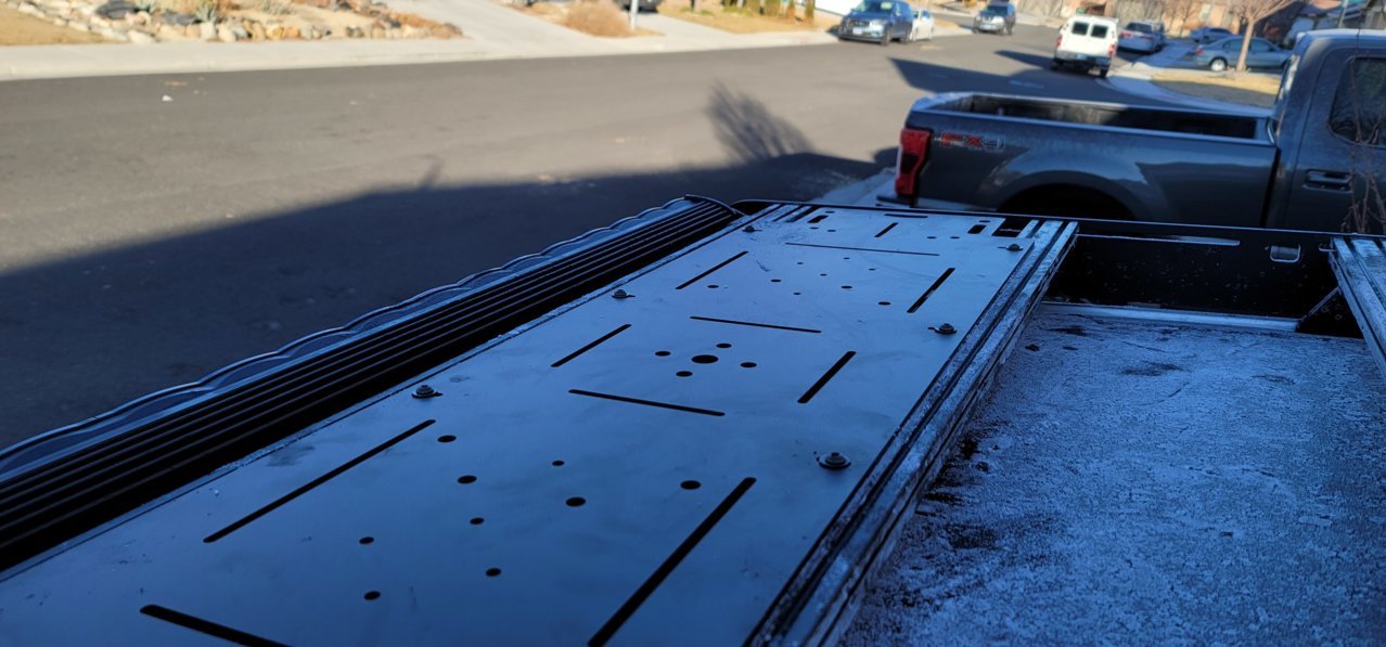

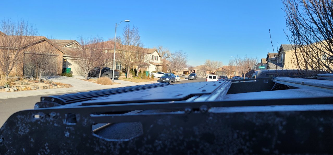

    Just installed Sherpa's large adapt plate. Gonna relocate my dual band antenna in the Nmo hole

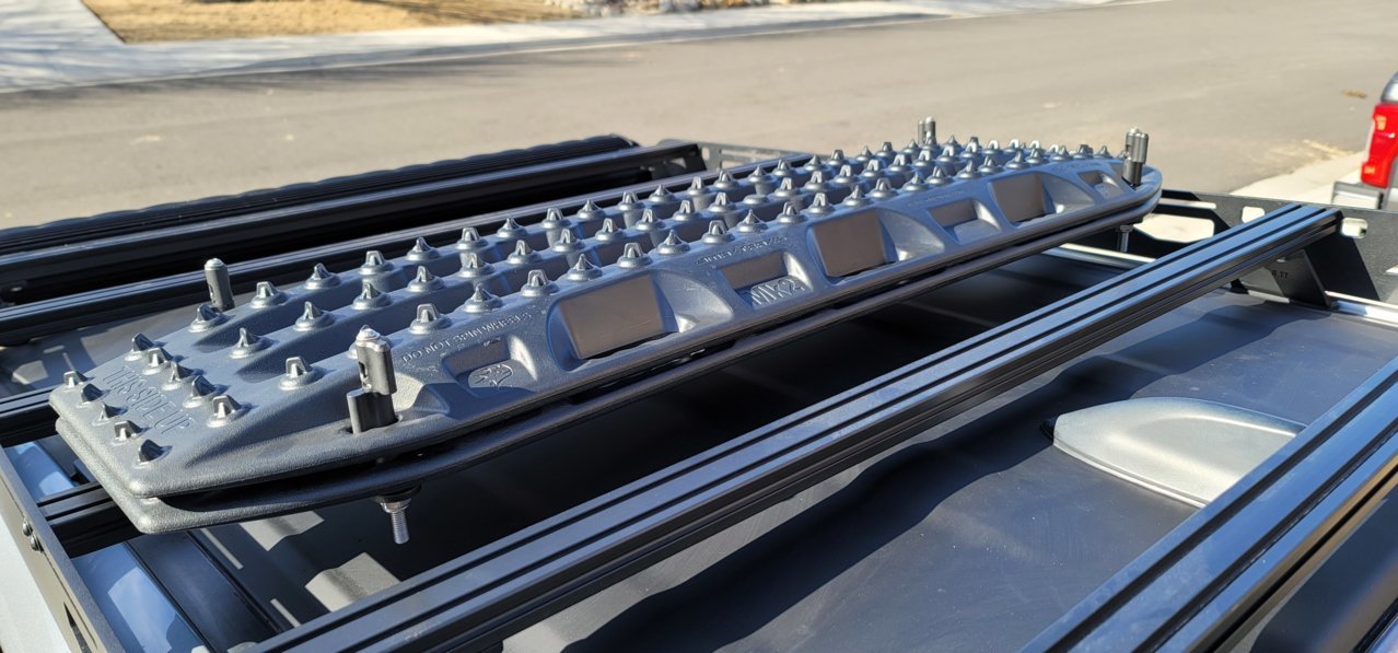

    Got the maxtrax mounts today! I will have to remount them. Make them go with the direction of air.

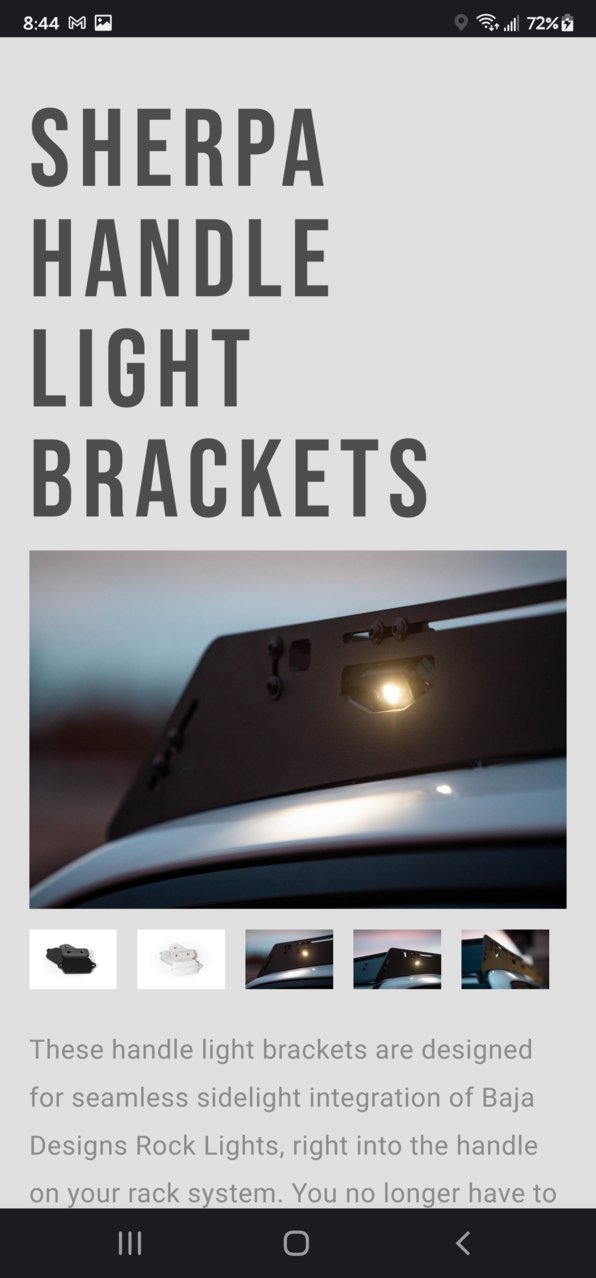

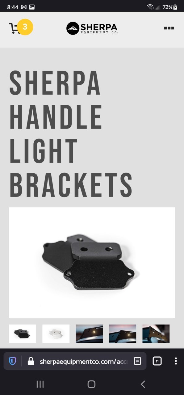

    Been thinking about getting a two sets of these and trying out some baja rock lights for them. Anyone else see these?

    It’s a clean way to add lights to their rack but then I wouldn’t have anything to grab when opening or closing my rtt.

    Really? Don't you use the ladder for your rtt to open and close it?
