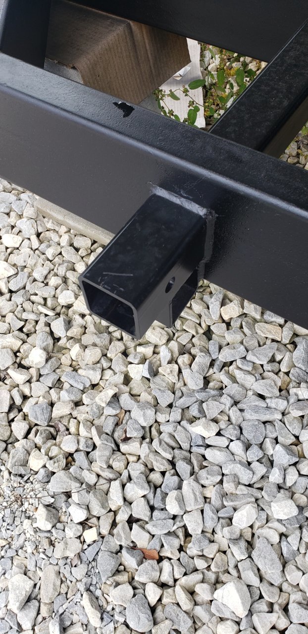

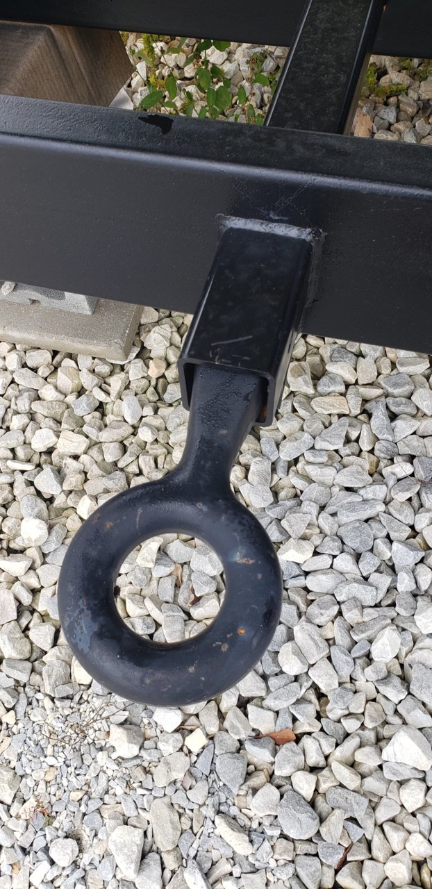

    The hitch is a removable one. I can either use a pintle or ball.

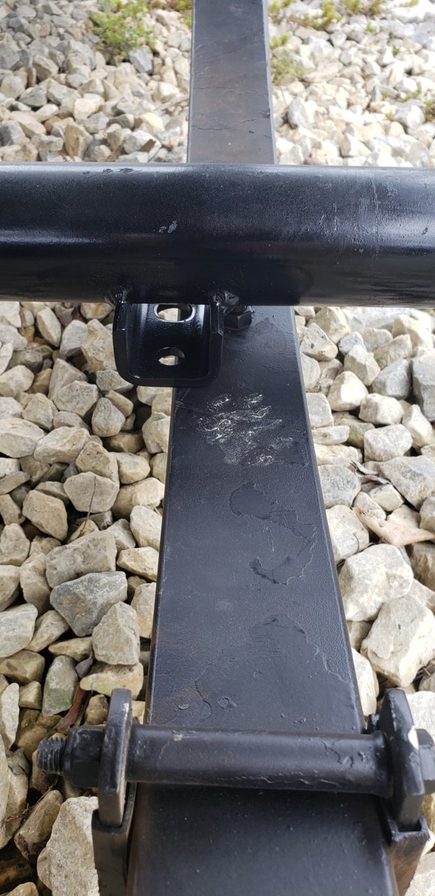

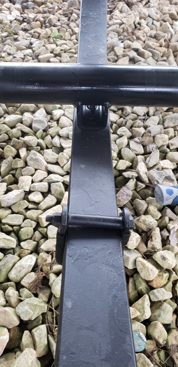

    Welp, I think I've got my first screw up. I sat the axle on the springs just to see it(it mounts under the axle) and the perches are 1" off. I'm not sure if the springs will pull in or not.
    Driver side
    Passenger side

    Would each spring pull in 1/2" when you bolt it down? I swear I measured 41.5" on the Tacoma.

    Yes you can pull each one in a 1/2" and probably be ok. Try it and look it over. To properly repair it would need to cut both off.

    I'm ok with pulling it in if it won't cause problems. I don't want to have to put Mike out. He was kind enough to weld it up the first time.

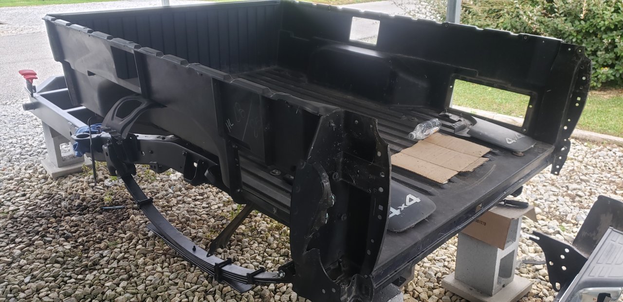

    Bed is on
