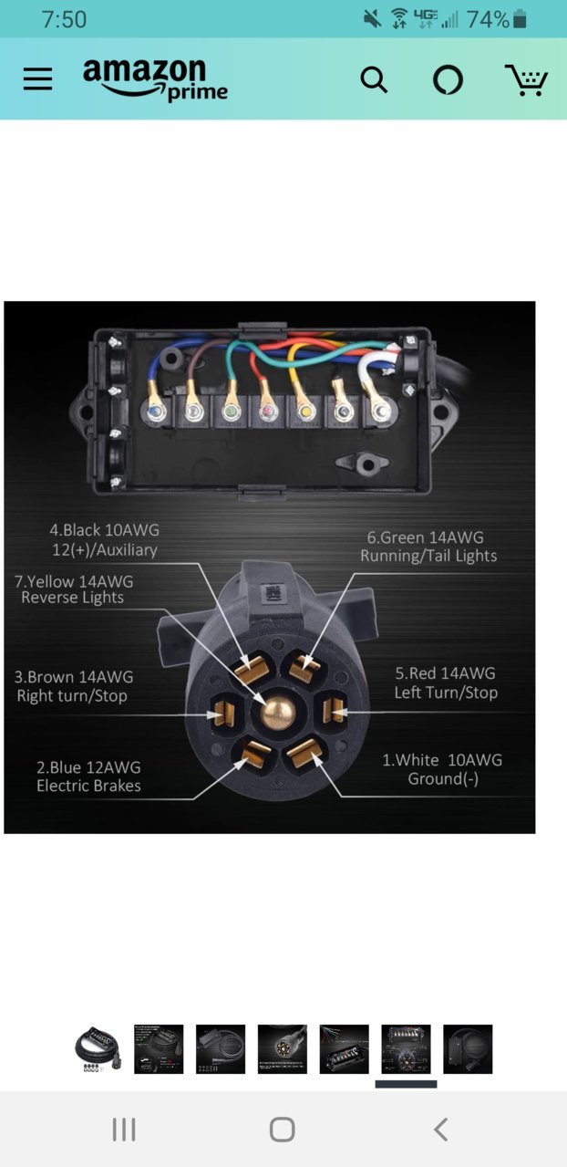

  11. Nov 7, 2020 at 5:51 AM
    #351
    gixxerphil
    gixxerphil [OP] @concretelander
    Mar 31, 2018
    #249012
    23,250
    Phillip
    Auburn, Alabama
    2013 DCLB
    I'm having a problem figuring out the wiring. I don't know about the black aux wire. Also, my stop and running lights should be the same along with separate turn signals.

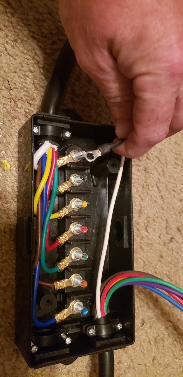

  13. Nov 7, 2020 at 7:06 AM
    #353
    gixxerphil
    Mar 31, 2018
    #249012
    23,250
    Phillip
    Auburn, Alabama
    2013 DCLB
    I have no clue. I just bought a 7pin harness to match the Tacoma's. I'm gonna call etrailer and tell them what I have/want and see if they have any suggestion.
    I am very limited in my electrical knowledge.
    I have the box wired up.
    Slashaar likes this.

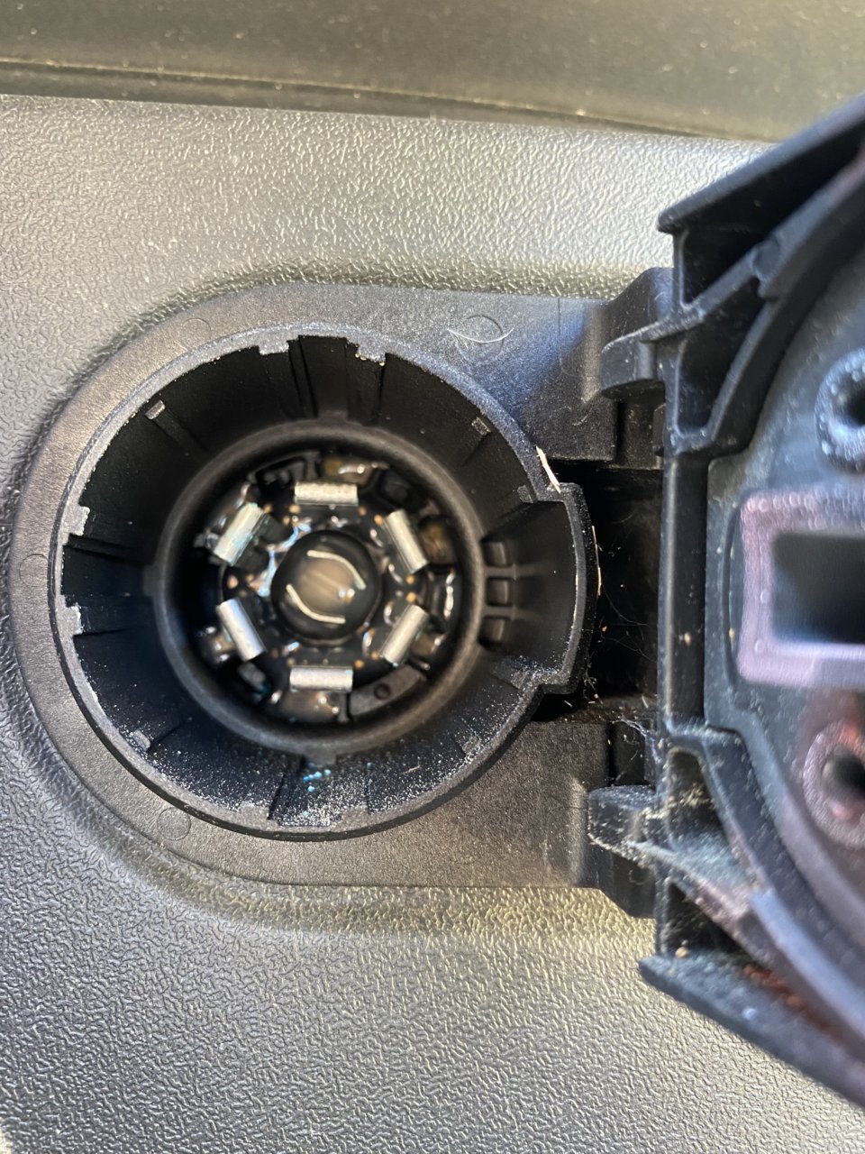

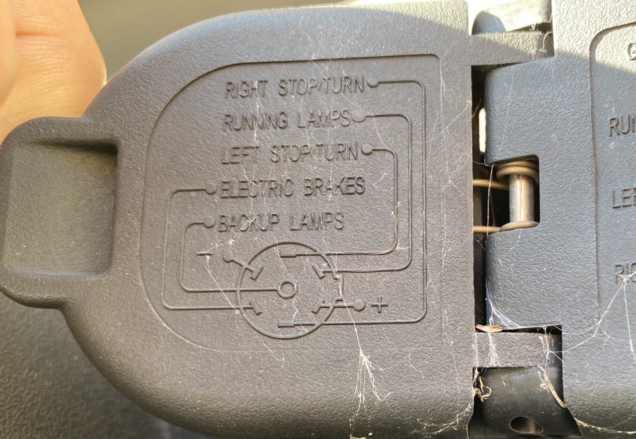

  14. Nov 7, 2020 at 7:40 AM
    #354
    Hafaday
    Hafaday Well-Known Member
    Dec 14, 2018
    #275828
    5,636
    Bill
    Richmond, VA.
    19, DCSB, Off Road. 23 KLX300, 14JKU
    Gotcha.
    my truck has the pin-out (truck to trailer) on the cover. It is also rotated 90* to the right.
    That said, I would wire my lights accordingly on the trailer, if I were doing this.
    I believe you have dual filament bulbs for the brake, turn and running lights. Brake and turn (bright) is one side of the bulb. Running (dim) is the other. The truck knows what to do (convert) with said signal as long as you wire the lights correctly.
    EDIT: The only thing that changes my thought process is, if the trailer wiring is made for a 4 light set up.. being 4 lights. 2 for running and brake, and 2 for running and turns like a tractor trailer setup.
    Slashaar and Bigdaddy4760 like this.

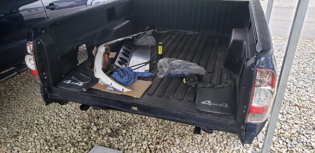

    I put the tail lights in even though I know they'll come back out once I hear from etrailer and figure out what to do with the wiring. Excuse the mess, that's parts for the ARB bumper swap :D

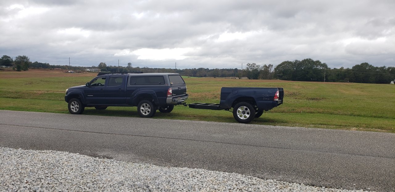

    That was a pretty good feeling :D
